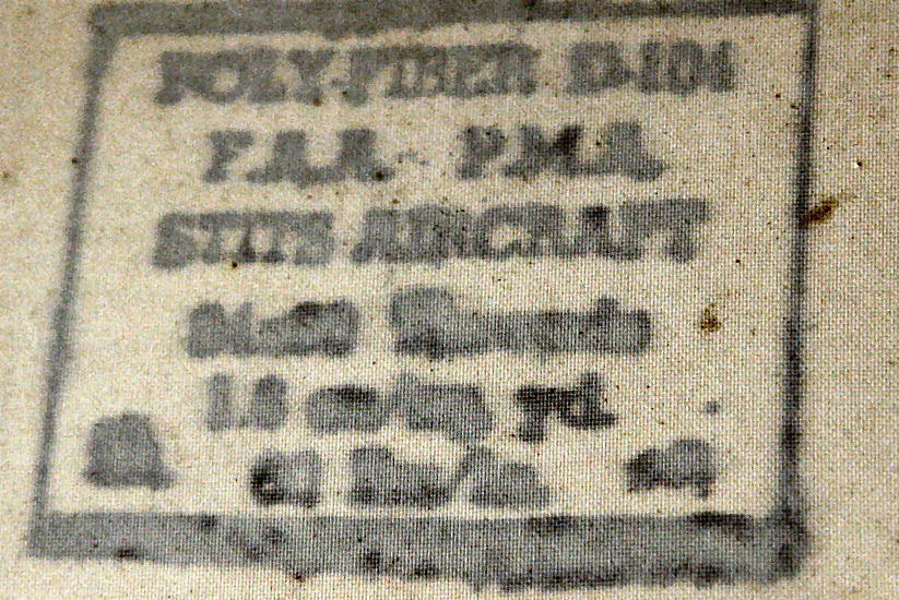

Could someone please take a look at the attached image and tell me what weight of Poly-Fiber fabric this is? Thanks!

Robert L:
D-104 is 1.6 oz. It is stamped on the fabric in your photo. That is what
we covered the wings and tail with some years ago.
I used D-103, 3.6? oz for the fuselage of my FS, 1986.

Thanks, John. If I were to patch my wing (upper surface) should I use the same 1.6 oz fabric, or go up to the medium?

Robert L:
Probably would not matter much.
The weave of 1.6 is much finer than the heavier fabric. Correct me if I am wrong, but that would be the biggest difference when doped and painted.
How big is the hole? If small, I'd stick a "sticker" on it. My mkIII is held together with stickers.
