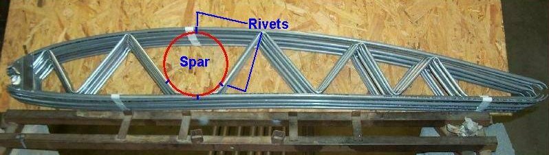

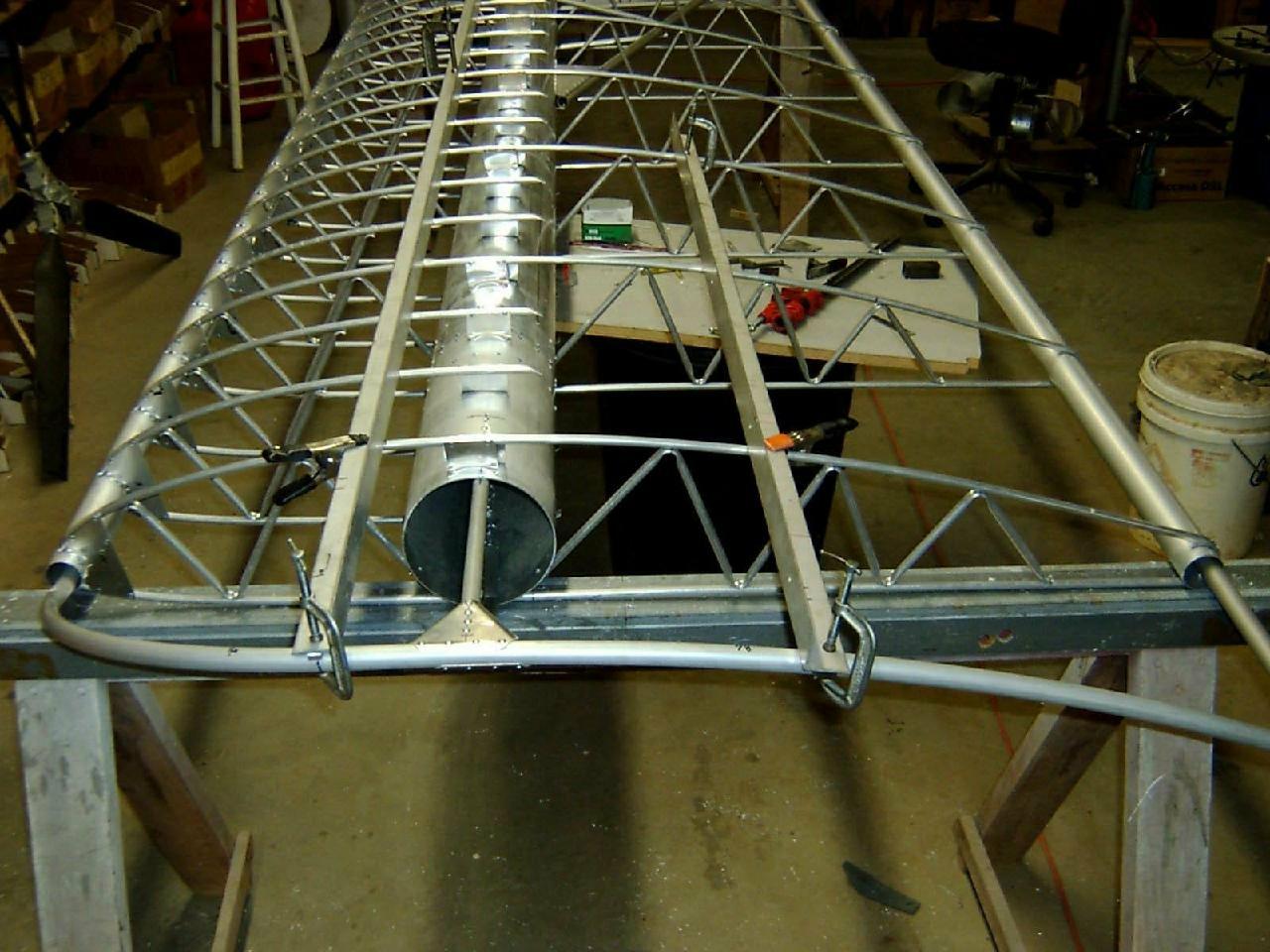

I guess I had always thought that if I were to build another set of wings I would do some research in raising the leading edge tube an inch to an inch and half. By doing this I would think that you could decrease the wing incidence in flight with near the same lift. Making it a bit faster,,, moving the leading edge up would give it a profile more like the super cub. Anyone smarter than I know what effect it would have?
These ribs maybe more what he is talking about. Thinner & not flat bottomed.
Possums
| Quote: | >>>>>>>>>>>>>>>>>>.
That was the nose profile I was thinking about…. But the convex bottom was not in my mental snapshot.
