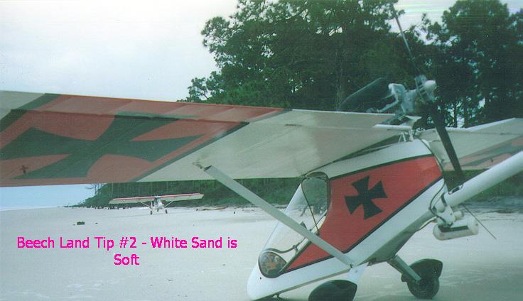

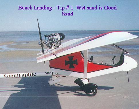

I think the most bang for your buck is going to be the lift struts.
I could tell at least 4 to 6 mph top end with my old 447 Firestar.
I did the landing gear later and didn't really notice any difference, but
it looked neat. Those original little landing gear looked kind of goofy.
