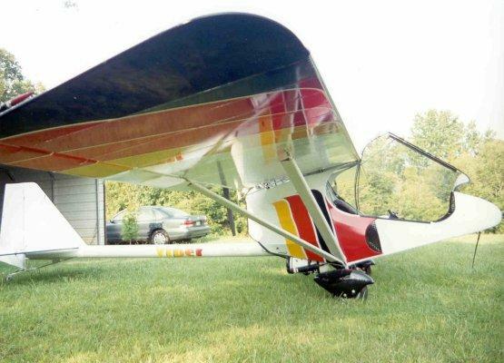

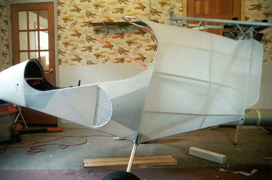

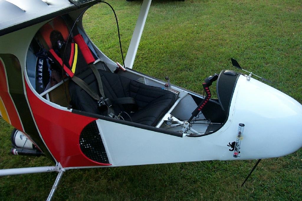

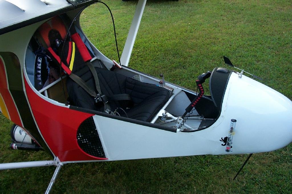

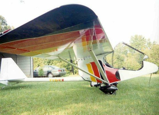

Possums,
What airplane are you flying now ? Which engine does it have
? How does it compare to the Kolb ?
I wrecked my 447 Firestar back in '97 after 600 hrs. So I had the
chance to rebuild it like I wanted.
Same wing ribs you've got - just more of them (Cool per wing, 4 inch
wider cockpit, shorter wings, different wing tips etc.
503 CDI, saved the nosecone & the stick & some hardware. It's heavier, but the
VGs more than make up for that. It's basically a kolb except for the back end.
I like it better without the windshield when it hot. But it will
glide like a poor performance sailplane.
