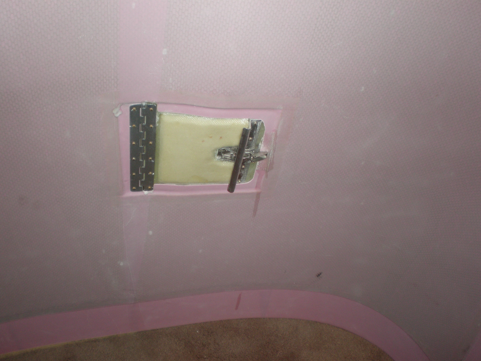

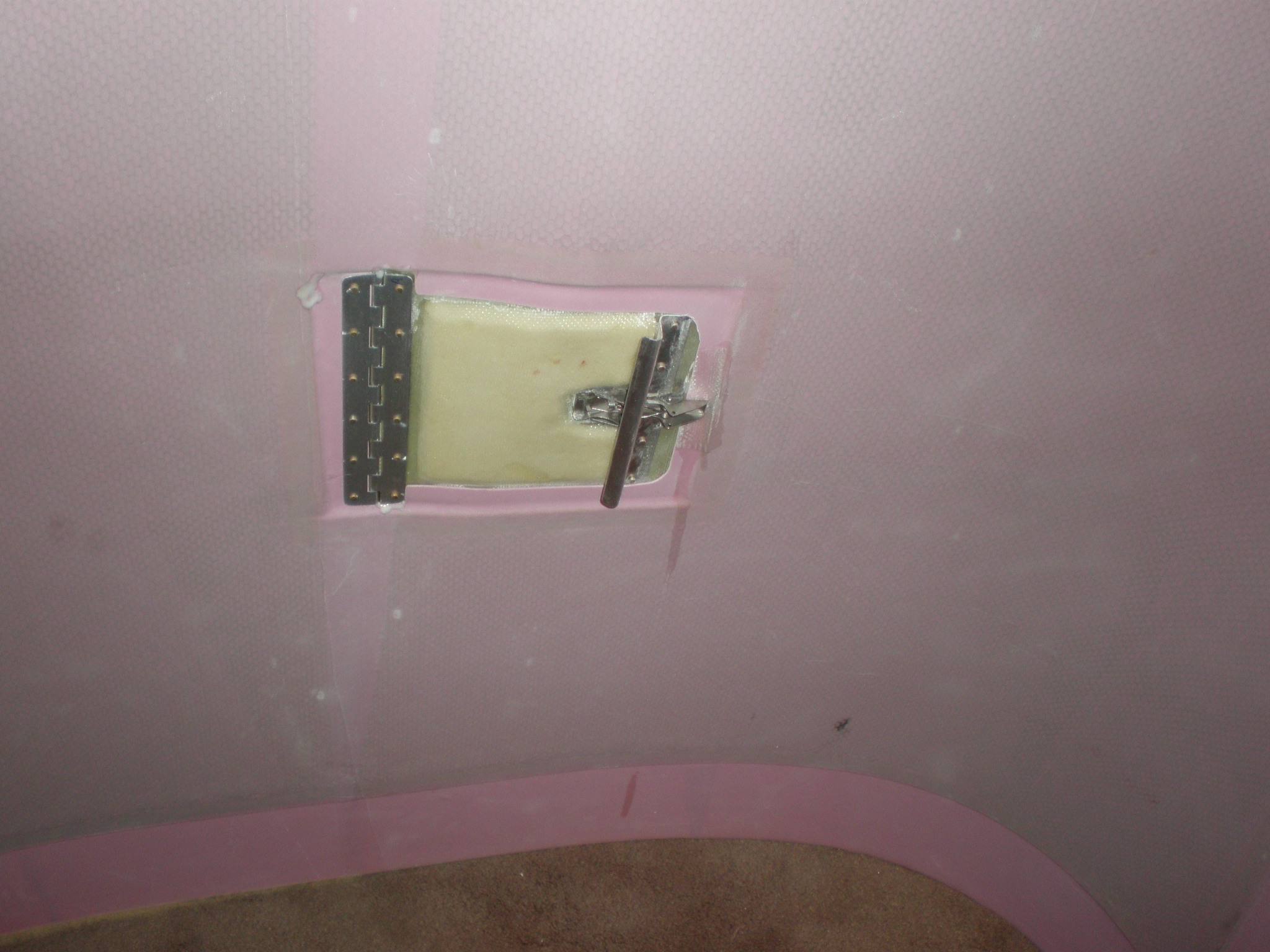

PostPosted: Mon Jul 21, 2008 8:46 pm    Post subject: Hidden oil door hinge Reply with quote
It was a difficult job. but I just did not want those two didlies sticking up on the nice smooth cowl. I found that I had to put a bit of camber in the door to make it "go flat". I also ran a z-strip to rigidify the door at the closure side. The Hartwell clip (available at OSH) are well made and last forever. Get them at Osh on the cheap. Here is an inside view. Note - I am not flying so it is not a proven product yet.
