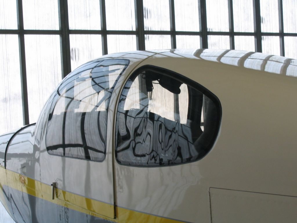

Last week we bought a canopy cover from Van's. We used it in Eastern Oregon a few days later, and when the plane got back to Watsonville, we found the left rear window had gotten hot enough to distort pretty severly. Bummer.
In the picture, the reflection of the hangar in the door window is how it should look. The back window is toasted.
I know that the polished wings sometimes reflect back towards the fuselage, but I had no idea that the heat could be so intense. I think the cover may have helped trap the heat, but I don't have any proof. The factory seems to think it would have been worse without it. They talked about a polished RV-4 that melted its canopy once. But ours has been outside for almost a year now in some pretty hot, sunny climates without any issues, until the cover went on.
As a bit of trivia, I just checked and found that the upper wing surface aft of the spar is slightly concave, unlike an RV-6 we have in the hangar, which is convex. With the flaps fully retracted, the concavity is more pronounced. Now if I could just harness all that solar-collecting power...
Now I get to see just how easy that Sil-Pruf comes off.

Seems like you were pretty unlucky to have the plane parked in such a position to allow the sun to hit the wing and reflect that back up onto the rear window...really C that sucks.
So what you are saying is C perhaps white paint on the wings would help prevent that.
A white canopy cover is a must.
If able C park the plane with the nose or tail to the East or West.
Thank you for sharing these unknown mind fields.

Dave, since you are classifying your existing pilots rear side window as Salvage, have you considered making a positive compound curve of the opposite pane, using an IR lamp (at proper distance) and having an assistant use a handheld temperature gun to monitor threshold temperature as you approach flexibility? Tap Plastics can advise on the process (which they use for forming). You should be able to recreate the opposite force and return the distortion to a "Near" virgin state.
The experiment would be valuable to the rest of us before we all learn of Sli-Pruf during removal.
Whose cover did you use, what cloth material and what color created this challenge?

Sounds like a hoot! But I want to get this done before OSH so I'll probably just replace it.
The cover is the thin, light grey cover, purchased from Vans. I think it may be from Avery.
Thinking this through and discussing it at length, I see two options: paint the wings, or put some kind of insulation inside the cover. Neither one thrills me.

Here is what I will be using for a cover. These are really high quality and I have had one for my sailplane for years.
