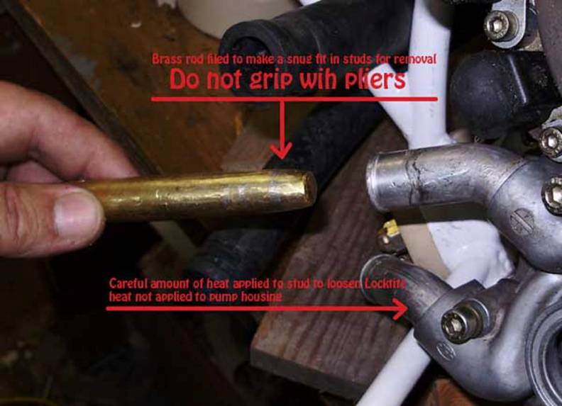

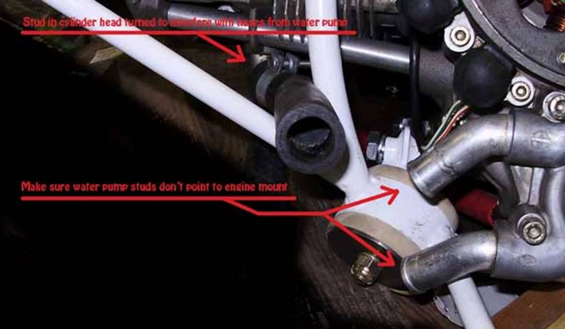

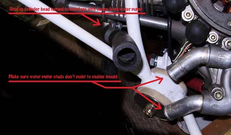

I’m in the throwes of doing just that to my model III-A which I expect is actually closer to a model II. I’m using the model IV Dynafocal mount and the first thing I’ve found is attaching the engione to the mount is probably easier to do before installing in the plane. One other item is the cooling hoses from the water pump to the cylinder heads will require having the studs (45 deg) will need to be turned a bit to get a decent access to putting the hoses on the pump. You may also need to turn the 45 deg studs on the aft cylinders to get a decent clearance on the aft hoses. These studs are held in place with green locktite ( penetrating) and will need to be very carefully heated to remove, clean and reinstall in the correct direction. It was advised to me that Llight Engine Rep[airs uses a rod turned down on a lathe to insert into the studs for removal. I don’t happen to have a lathe or any 1” aluminium stock so I had to substitute brass and a file. If you want to try this remember the old rule don’t grind anything that doesn’t spark so use a file. It may take a lot longer but it will be worth it.
Also be careful removing the top of the pump.. you may want to do that to get a better grasp on the part and to remove the O-ring that is inside the pump inlet.
Pictures following:

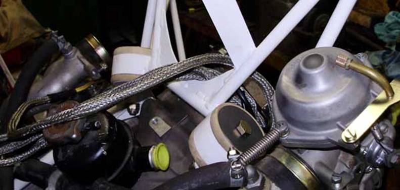

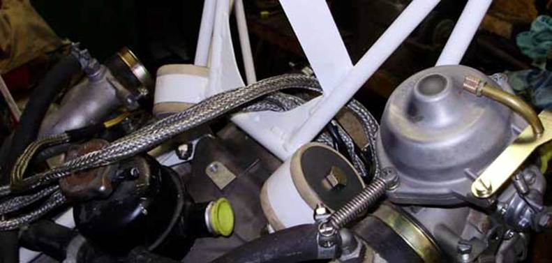

Lord mounts and wiring harness will be hard to position on the airplane. I recommend getting the engine fully read then install the engine and mount in one piece. Be careful to make sure the mount fits perfectly before starting working on the engine. This engine has the older style ignition and care must be taken with it.

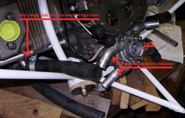

I removed the pump back plate to remove the hose nipples so they can be reinstalled in the right directions.
Looks like I may have to do the same thing with the nipples in the rear cylinders.
Hose nipples may direct the hoses to rub on the motor mount. I expect to have to use longer hoses.
I made a tool out of a piece of brass round stock to assist removing the nipples from the pump top plate. A careful amount of heat was applied to the nipple only to break the Locktite. Slow and easy using minimum heat to avoid cracking or pinching the nipples. Green, penetrating Locktite will be used to reinstall the nipples in a direction that won’t interfere with the mount.
