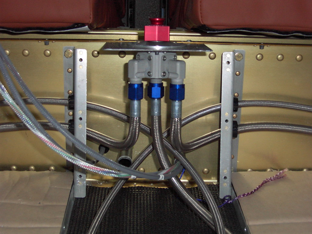

ThisOne
Joined: 18 Jun 2008
Posts: 20
Location: High Desert, So Calif USA
PostPosted: Mon Jun 30, 2008 8:48 am    Post subject: Re: Need to Order Fuel Tubing Reply with quote
Or.....
You can use a -6 Teflon Stainless Steel braided line with a clear cover.
Here is an example.....
Of course in the end its up to you the builder. Now aluminum tubing is lighter in weight and at $17.00 for 25ft is cost effective. And in as so long as you do not have tight bends, easy to work with as well. On the other side you have to make sure your flares are correct (here is where most fuel leaks occur) and not to score the tubing.
