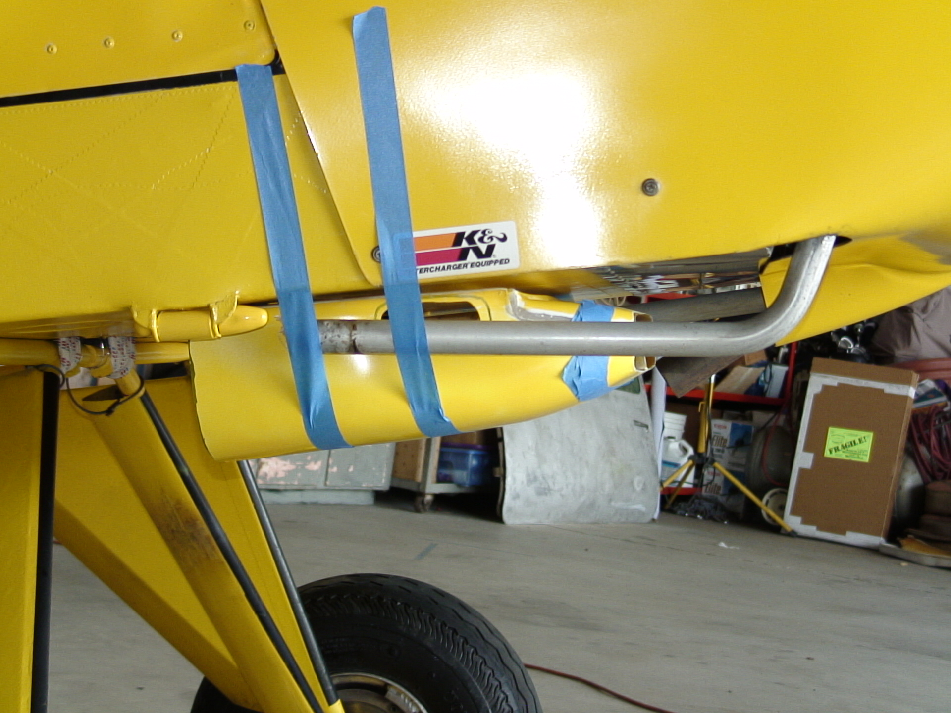

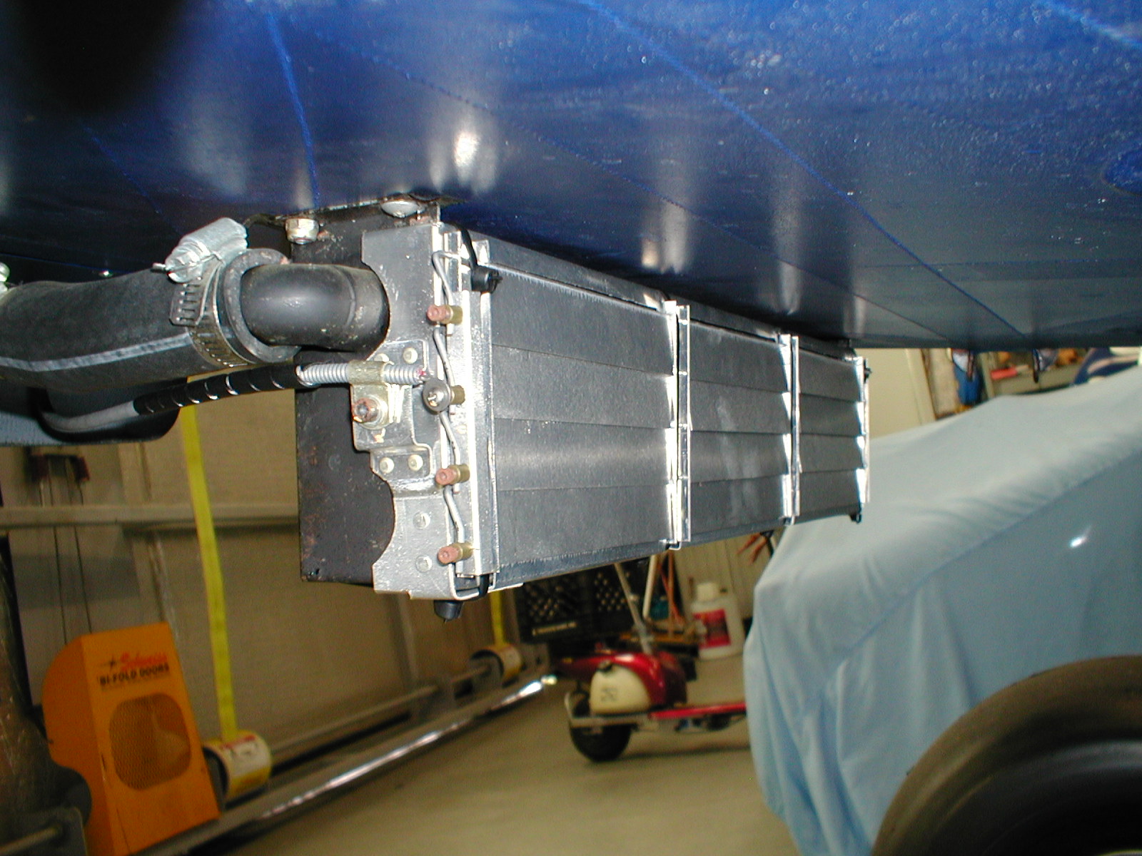

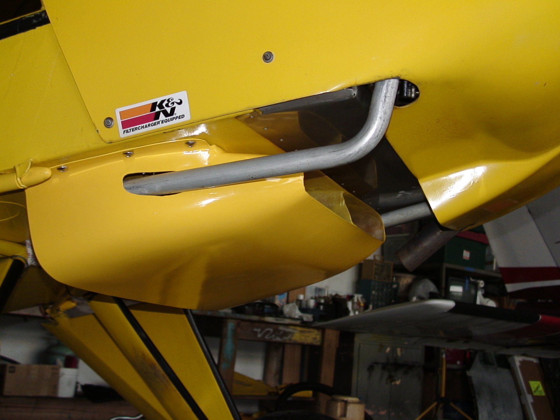

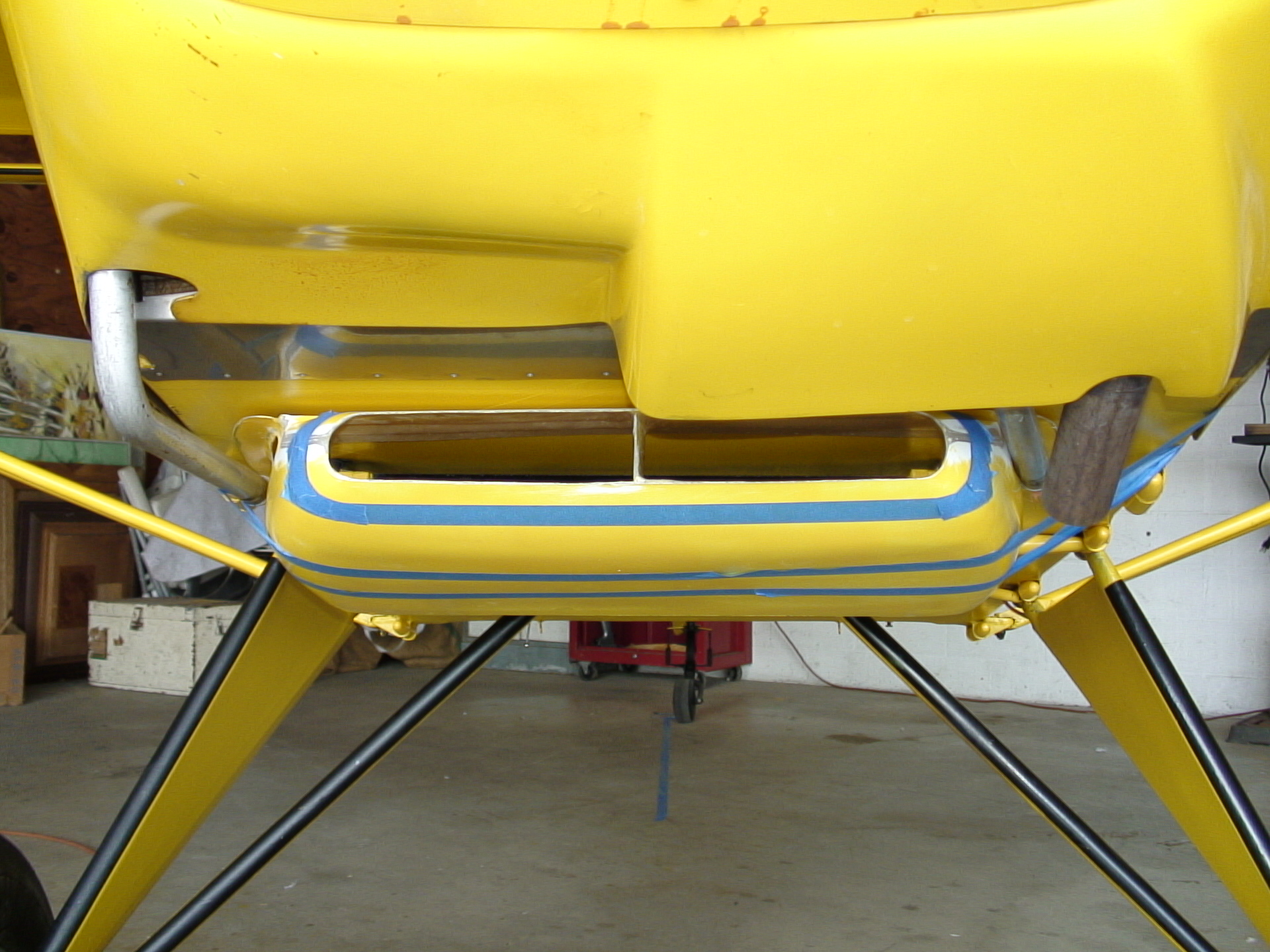

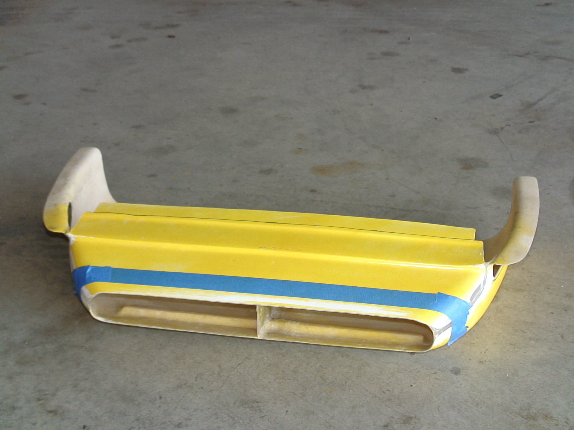

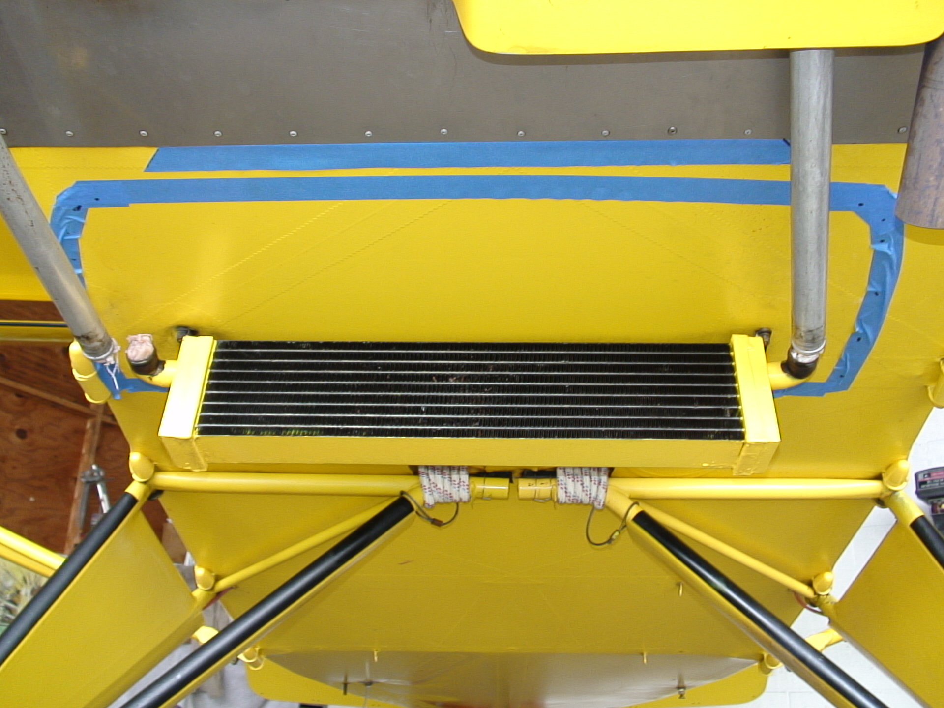

I'm in the process of installing one, will post how I attached the scoop to the floor boards with without removing them.
Also added speed cuffs.

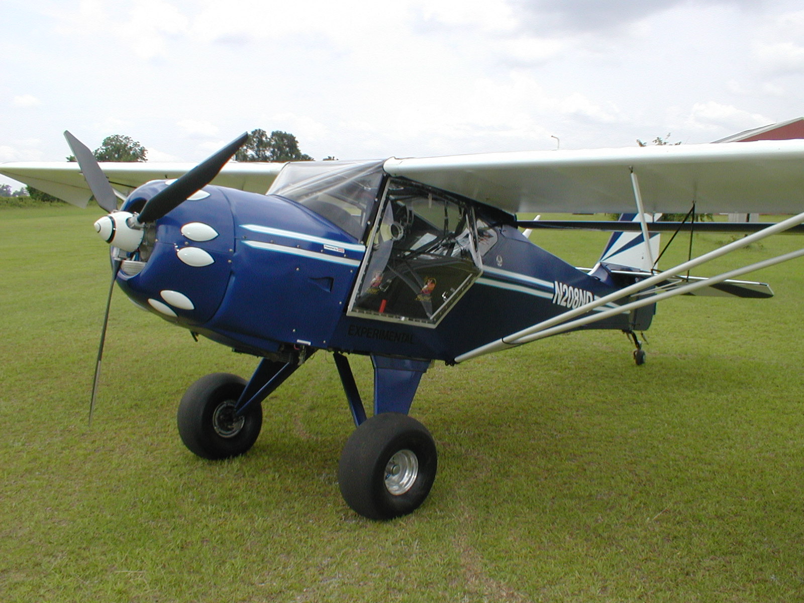

Thanks for your reply. I will probably attach the scoop with the long bolts. Yodaone, thanks for the great pictures! They will be very helpful for my installation. Please send more pictures as you go thru the installation process. You have done very nice work.
I have also installed the wing cuffs on my aircraft. It was a mystery how to attach them but I finally figured it out. I can't say as I can see any difference in airspeed but they look nice.(but then I have those fat tires)

Your airplane looks great. For some reason I don't recall the sunburst
design on the horizontal stab. Looks good in person, though.

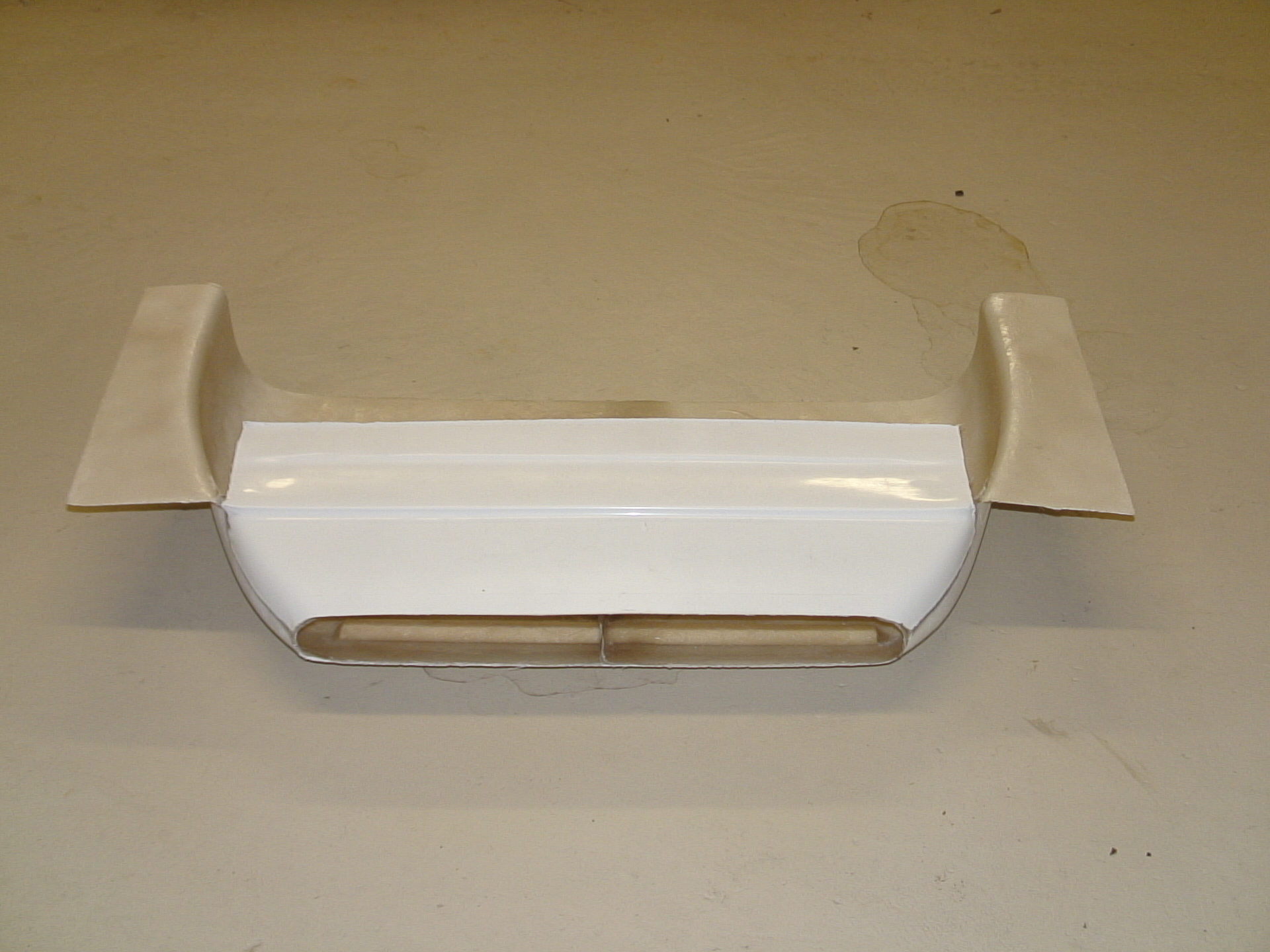

I have a scoop on mine and I have a mold to make more but I not offering them. I find that my cowl mods conjunctionion in fact lowered the operating temperature more than anything.
I would like to see proof that speed gains on any of the above have been had.
My site has the cowl mods that worked well. The Kitfox cowl dumps hot engine air right into the radiator as originally made.

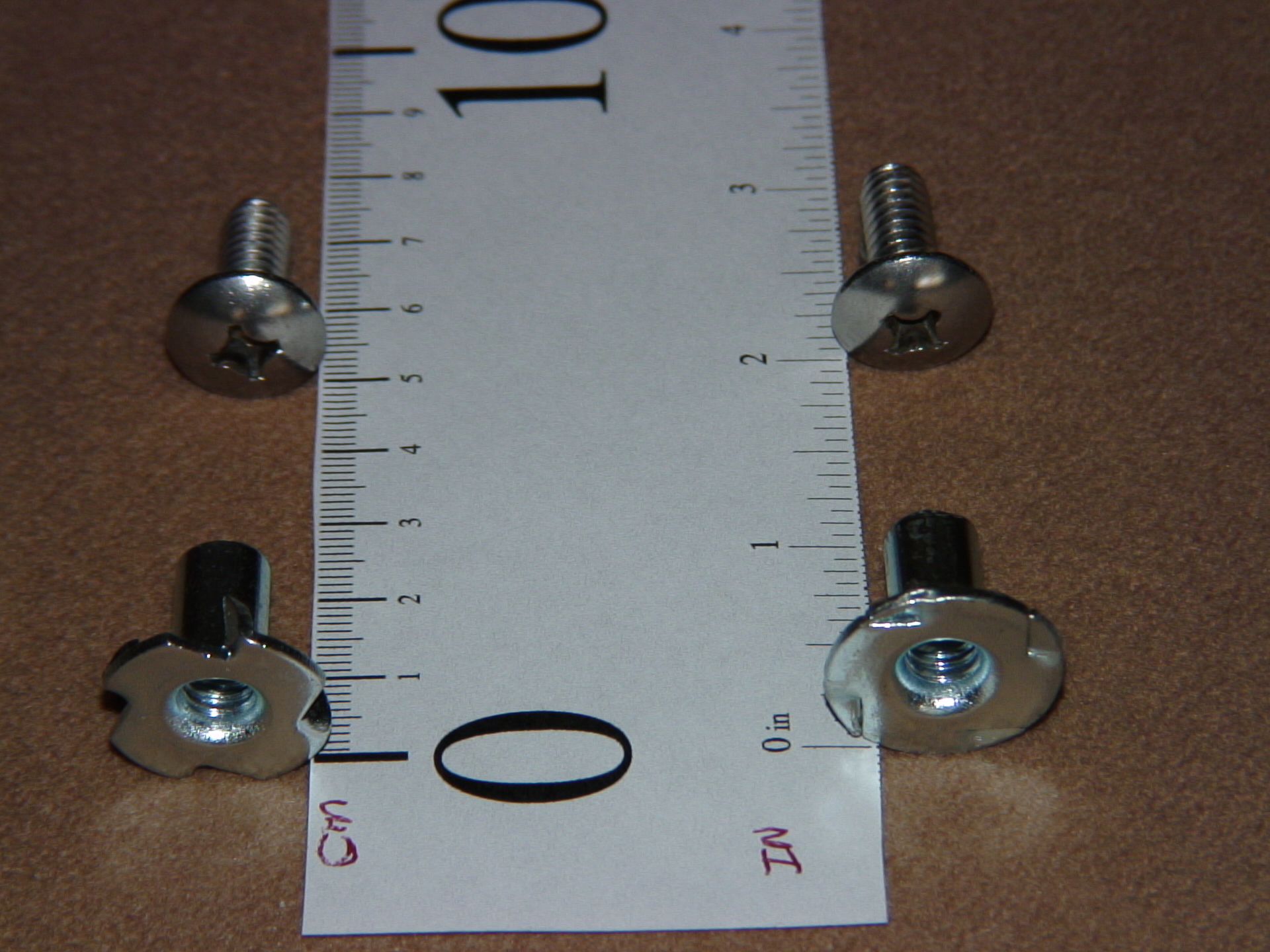

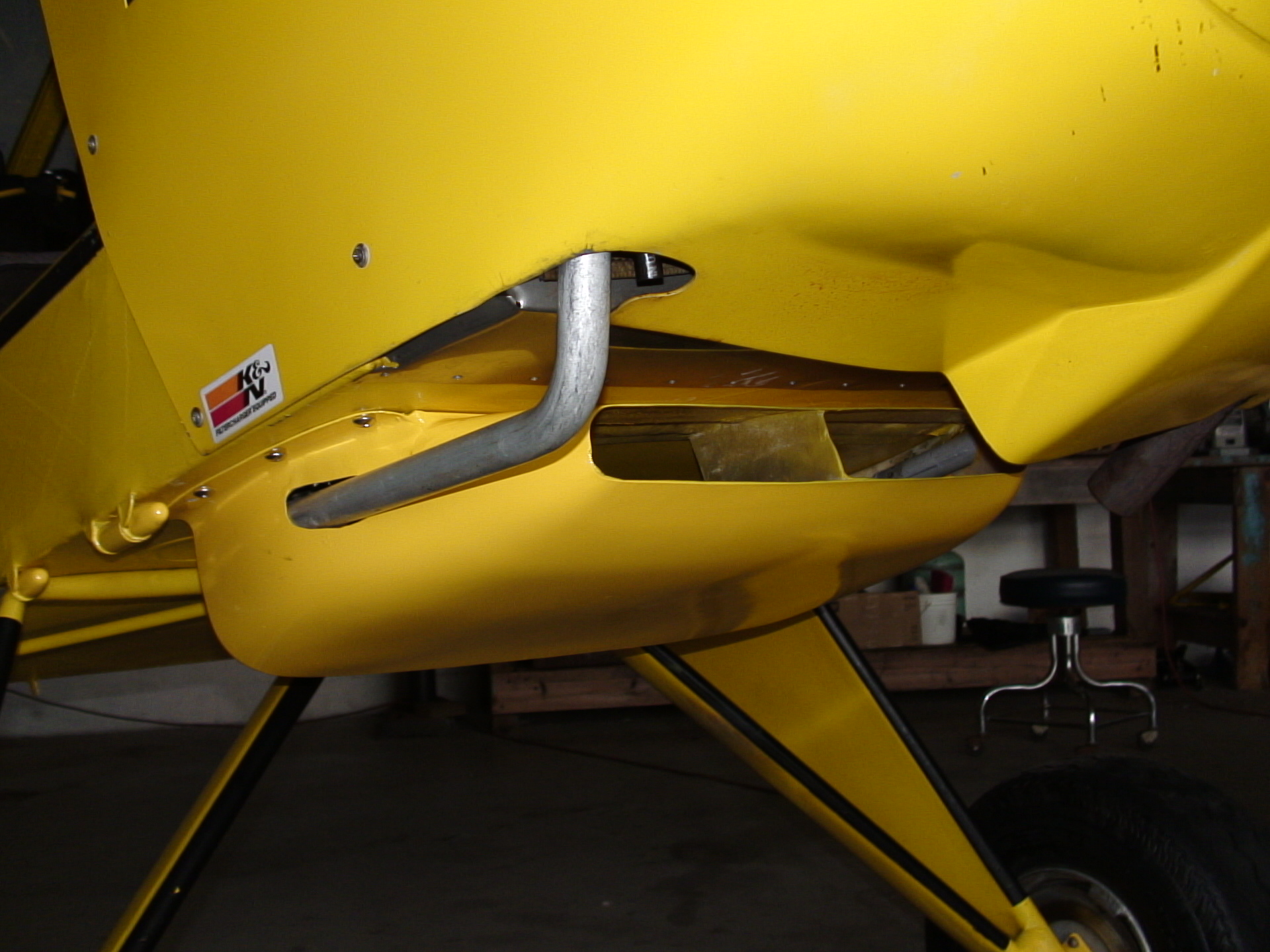

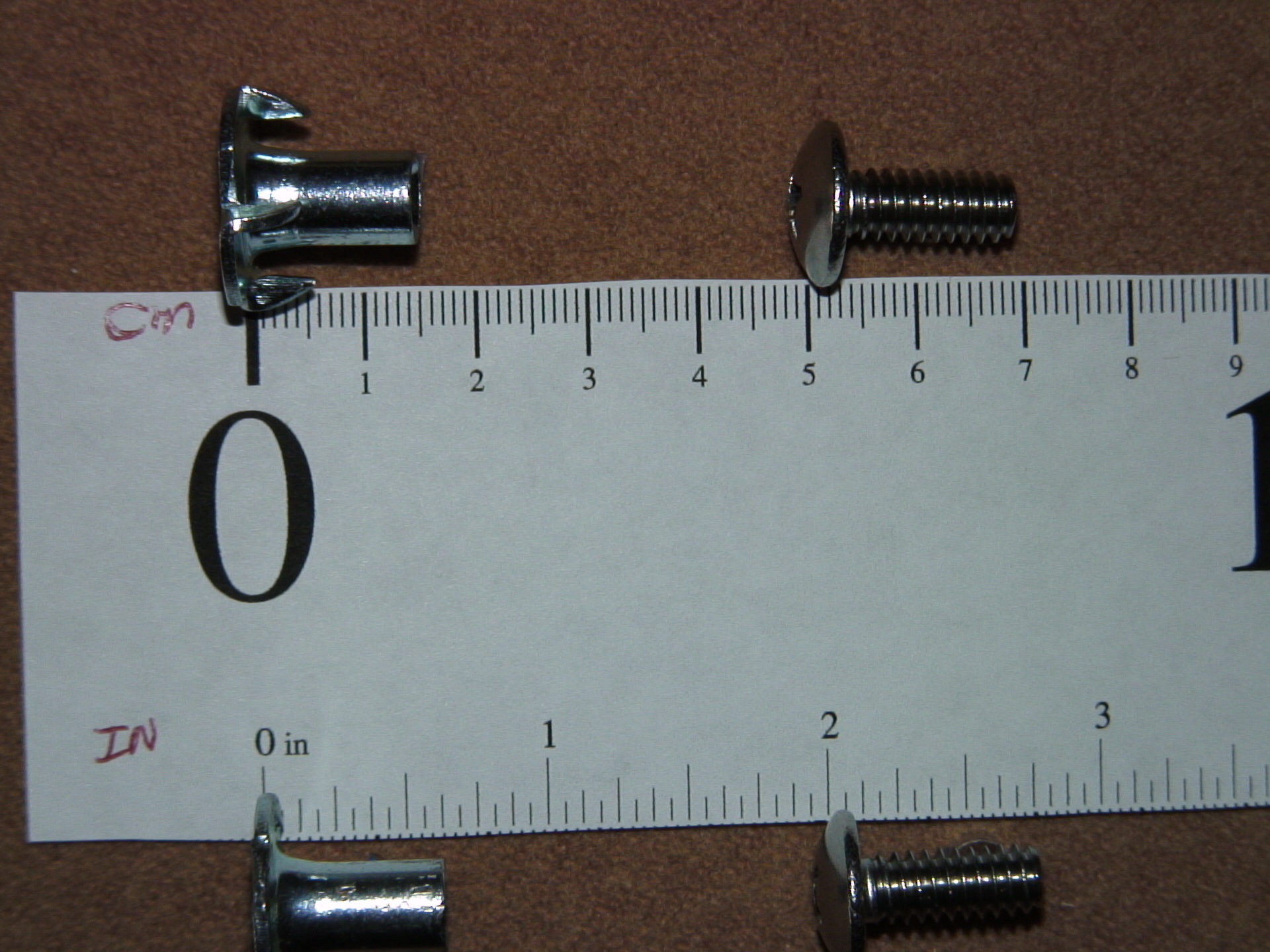

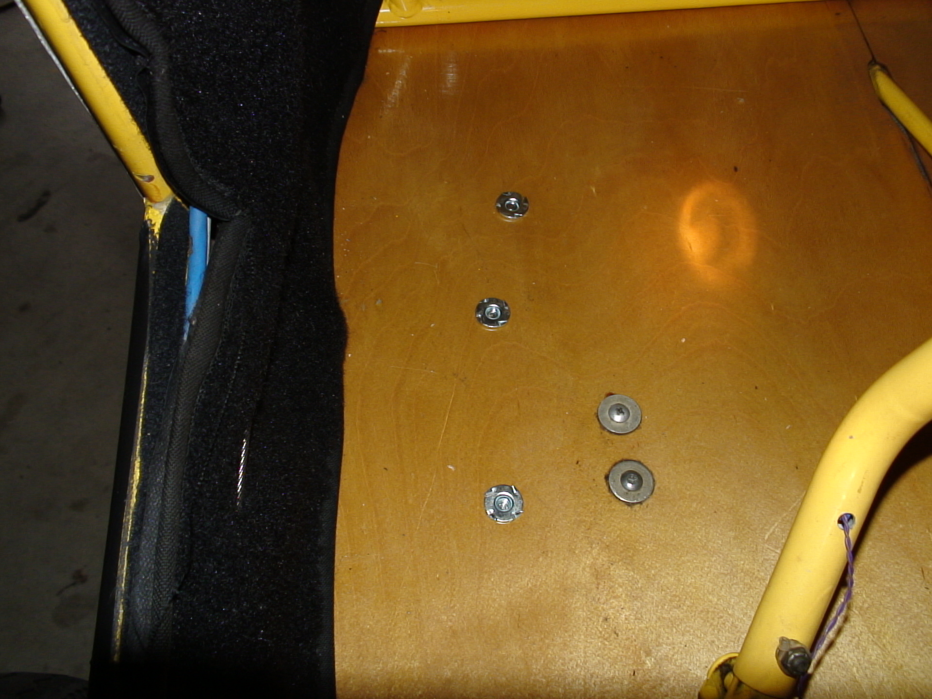

Installed the scoop and fastened it to the fuselage using three stainless screws. I did not remove the floor boards.
Chose this hardware because it provided the perfect spacer.
Hammered/flattened out the the spikes, drilled the holes, and installed.

Now the questions -- what did you gain or lose in speed and coolant temps ?
Did you seal the rad to the scoop? Makes a differance you know in cooling.
read my previous posts on cowl mods......... just look at that design how the hot air from the engine dumps directly into the rad..........

Thanks for the pictures. You have done a "super deluxe" job on that scoop.It looks great ! I will pattern my installation after yours.My only question is(and you guessed it) where did you get the scoop to floor fasteners.That is a nice clean installation.
