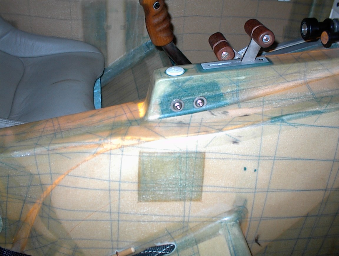

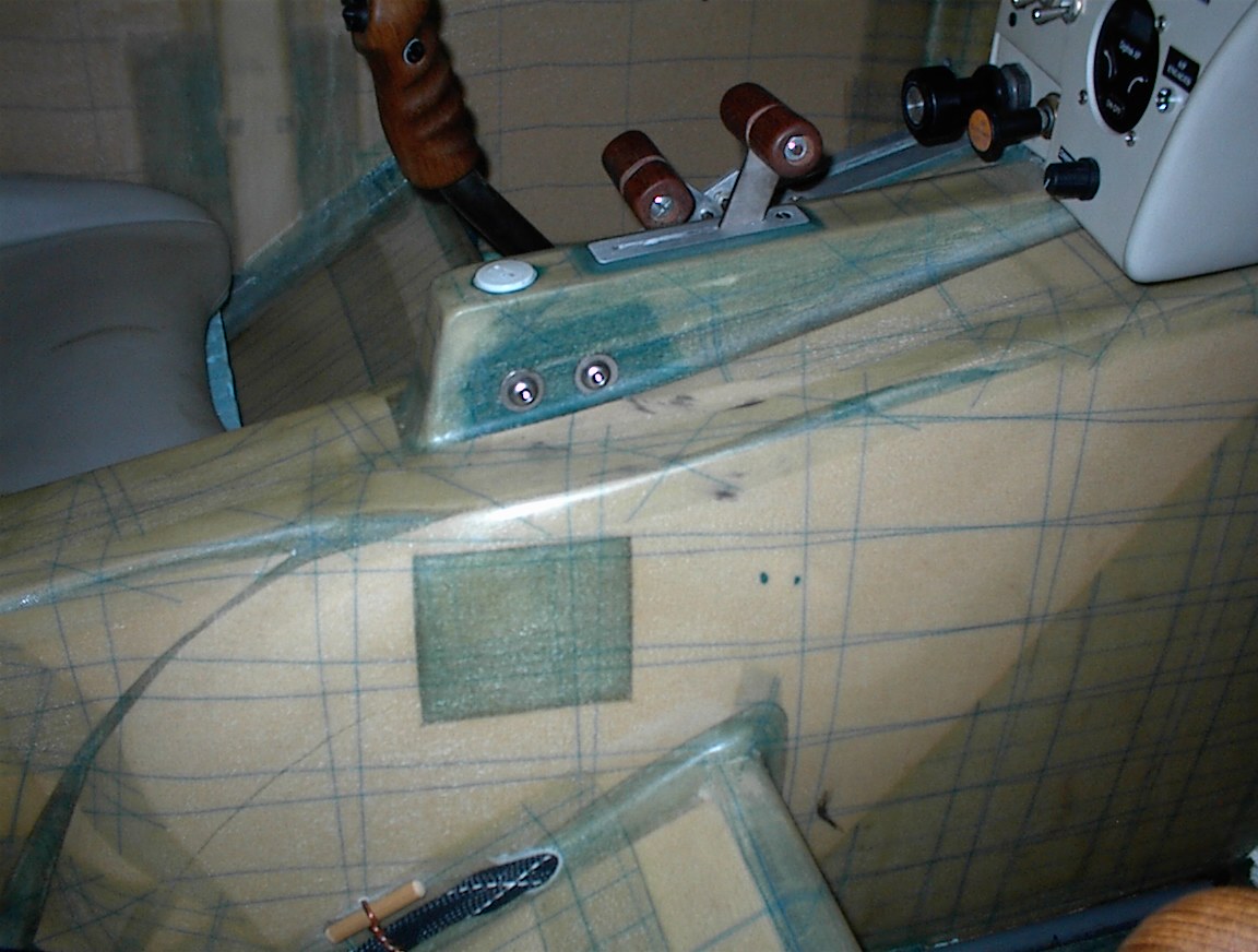

karelvranken(at)hotmail.c
PostPosted: Thu Jul 03, 2008 1:37 pm    Post subject: mono brake mounting Reply with quote
Rowland,
As you remember perhaps we were in Kirbymoorside the same day to pick up the
first stage of our millenium deal. So I think we had similar parts. Also for
the cockpit module we have about the same construction. Indeed the
reinforced place for the attachment of the brake cylinder is clear glassed
as you can see in the pictures attached. The first one is looking as if
there is metal inside. But when you put the light underneath then it becomes
clear. Note the different position of my brake cylinder and different
throttle.
Best regards
Karel Vranken
 Filesize:  171.01 KB
 Viewed:  449 Time(s)
 Filesize:  166.01 KB
 Viewed:  435 Time(s)
m.grass(at)comcast.net
PostPosted: Fri Jul 04, 2008 5:45 am    Post subject: mono brake mounting Reply with quote
Bob, Rowland,
I have the piece here in my hands as it was a part I had to cut away to make
room for my trigear brake cylinder mod. No metal insert here. I have to
admit, if you do not attempt to shine light through, it has the appearance
of a metal insert.
Michael Grass

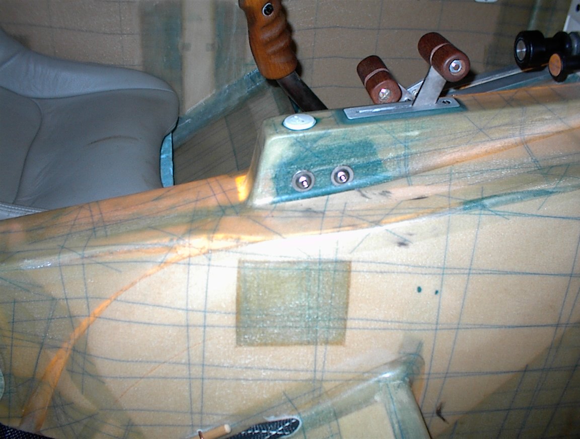

PostPosted: Fri Jul 04, 2008 3:25 pm    Post subject: mono brake mounting Reply with quote
Rowland, Michael,
I finally had to opportunity to get under my aircraft and pull the
masking from the wheel well area so I could get in to see what is
going on. There is no aluminum plate in there. It is some sort of
reinforced area and I have no idea what is actually acting as
reinforcement.
I guess your CM is OK. Get that brake master installed.
Good building and great flying,
Bob Borger
Europa Kit #A221 N914XL, XS Mono, Intercooled 914, Airmaster C/S

On Jul 4, 2008, at 8:41, Michael Grass wrote:
Bob, Rowland,
to make room for my trigear brake cylinder mod. No metal insert
here. I have to admit, if you do not attempt to shine light through,
it has the appearance of a metal insert.
Michael Grass

PostPosted: Mon Jul 07, 2008 3:25 am    Post subject: mono brake mounting Reply with quote
reinforcement.
Bob - I had a word with the factory today on the phone.
Roger went down to the shop where they have just completed a new
cockpit module and the technician there said they make a rectangular
cutout there in the brown foam and put in 12 layers of glass to make
it up to the same thickness as the foam before the top layer of
pre-preg goes on.
Maybe once upon a time they did use a metal insert and that is what
some people have got. The Classic CM had no prepared area and
required the builder to cut away one side of the glass and the foam
and replace it with plywood before re-glassing.
Thanks for your confidence-building response.
regards
Rowland
