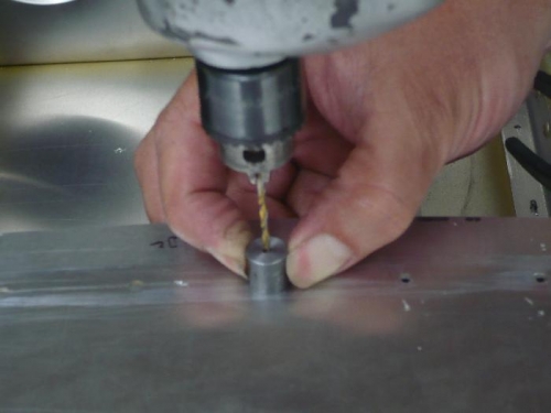

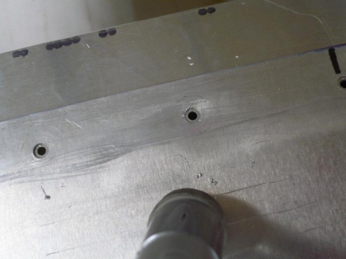

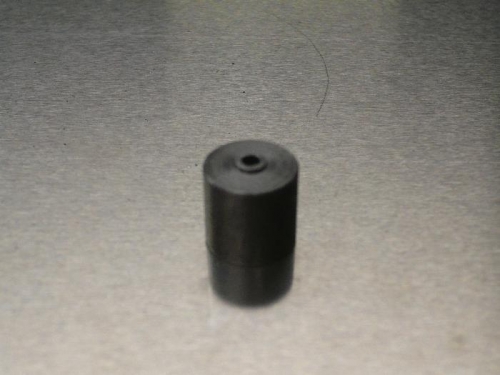

Here is an idea that worked for me today. The problem was how to align pilot holes in an already drilled #21 rivet hole. I riveted my top skin and as I was doing it I remembered the wing locker. I had already drilled the skin and ribs for black clecoes and ended up skip riveting around the wing locker area.
Later I drilled out the skip (every other) rivets and had to place and clamp the dzus strips and get the pilot holes right in the center of the large hole. I made a bushing and used it to locate the pilot drill right in the center.
All I had to do is setup the lathe and machine a step with a .155" dia in a piece of .5" dia. steel rod about .5" long with a through hole of 3/32"dia. The step is only .025" (material thickness). I hold this flush and drill through the bushing and the hole comes right on the center of the larger hole.
Once the pilot hole is in I just opened them in the conventional manner.

PostPosted: Thu Jun 26, 2008 3:06 am    Post subject: Re: Problem Solving Ideas Reply with quote
I like it Ron. More things I can now do with my lathe.
