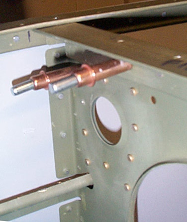

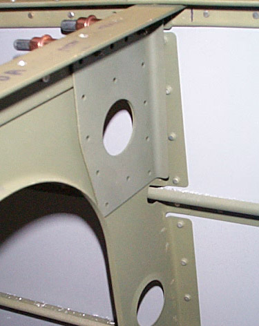

Fortunately, I still haven't joined my tailcone or have cables in the way, but I began the doubler plate work yesterday. I found that drilling out the old #30 rivets was hard to reach as the shop heads were facing forward and the taper of the fuselage made the angle tough (Did go buy an angle drill tool for this). I clecoed the doublers on the forward side of the bulkhead and carefully drilled perpendicular to make the many new #30 holes, then mounted it on the aft side, reamed, and then deburred everything. Having more than one set of hands will be handy to get the last few rivets in.
How do you all get those nasty filings out of the tailcone? Someone needs to invent a drill with a powerful vacuum... Best I can do is with a vacuum and attachment.

Yeah, I used a 90 degree drill for those couple rivets holding it on
to the top of the bulkhead. A small 90 drill like you can get
from aviation tool places works well for that. I clecoed mine
on the aft part of the bulkhead, since I figured for the match
drilling we were doing that was the best, and used the same
90 degree drill to drill the holes. I just worked alone on that
part.
The attached photo shows the attached doubler plate. I used
a rivet gun on the forward side, for a couple reasons....1)
the rivet head should technically be on the thinner material
if possible. 2) it gave more clearance for the gun. I was
shocked that after a couple years without much riveting, they
all came out perfect. It was easy to rivet and buck working
alone in this area.
To get the filings out, I used a small shop vac hose, and banged
outward against the side of the skin to get the shavings to
loosen and get sucked up. No fun, but I got most of them.
Wish I would have had my akzo primer, but I settled for a
bit of self-etching on this part. Not perfect, but it worked.

Started re-assembly after deconstructing the tail. I did it without an angle drill..... How? Got in as tight as I could with the red Sioux drill. Then I used some creative bending of my long 30 & 40 bits that I got from Cleveland. I first drilled the rivets with a #40 bit going all the way through VERRRRY carefully to stay in the center. Drilled the heads with the 30 drill - broke off the heads and then pulled the rest out with a compression pliers. I only buggered one hole slightly this way. Trimmed out the doubler and primed it and started squeezing the double rivets.
Got all of them but 6. Need a partner to shoot while I buck tomorrow.
12 hours in and 2-3 to go.........uggggg

Started it yesterday on an unattached tailcone. I've logged 8 hours and 2.8 for my wife. Will probably finish in another 2 hours after I borrow a 4" yoke. I only drilled out the two rivets on each side common to the F-1010 and F-1010A. This is the hardest part. The entire operation can be done from outside the tailcone, although I had an advantage in that I could roll it to one side or the other on a table for easy access.
There is no need to pull the F-1014 aft deck and ruin those "beautiful" rivets. The right tools are essential. Sioux drill, Right Angle drill attachment with the optional chuck - such as Avery's kit, slightly longer chucking bits than normal, a mirror, and a flashlight held by you-know-who.
Everything is accessible through the lightening holes in the aft deck and the large hole in F-1009. If you can't roll the tailcone from side to side like I could, it's still doable, but will definitely be less comfortable.
I buggered one of the four rivets that was inboard, so I carefully "buggered the other one to match." Drilled them to take an AN3-5A and it looks great.
As soon as I borrow the 4" yoke, I'll get the hard to reach ones done. The pneumatic squeezer doesn't get along with the one rivet next to the J-channel, so I'll probably have to shoot & buck it. De-burring was surprisingly easy, although the mirror makes your sense of direction go crazy.
I'm extremely pleased with the results and I didn't have to touch the aft deck (although it did teach my forearms a lesson). I would highly recommend doing it this way if at all possible. I doubt if it's any faster, but I sure feel better about leaving the aft deck alone.
For you flying guys, Tim's discovery of some smoking rivets may make the Van's way the preferred method - I might have missed something like that.
John
