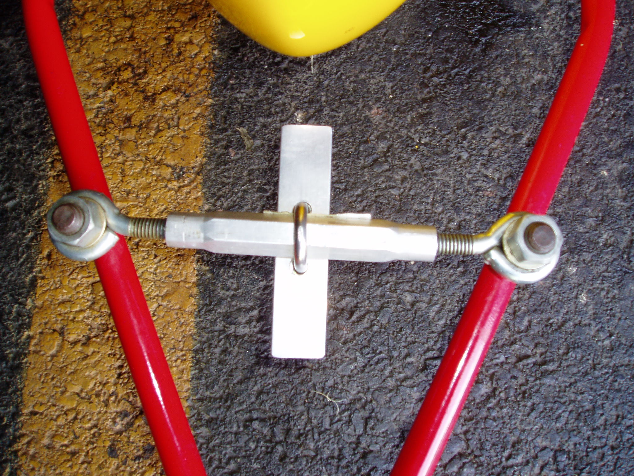

I used a Bogart tow bar available from ACS for about $ 65.00 and sold specifically for RV's. I modified the bar's mechanism to better control the attaching function which would spring closed damaging the paint on the wheel pant. The mod consisted of replacing the stock mechanism with the largest turnbuckle available from Ace Hardware and Aviation Supply company attached with modified cap screws. See photo attachment. Good control and no more chipped paint.
