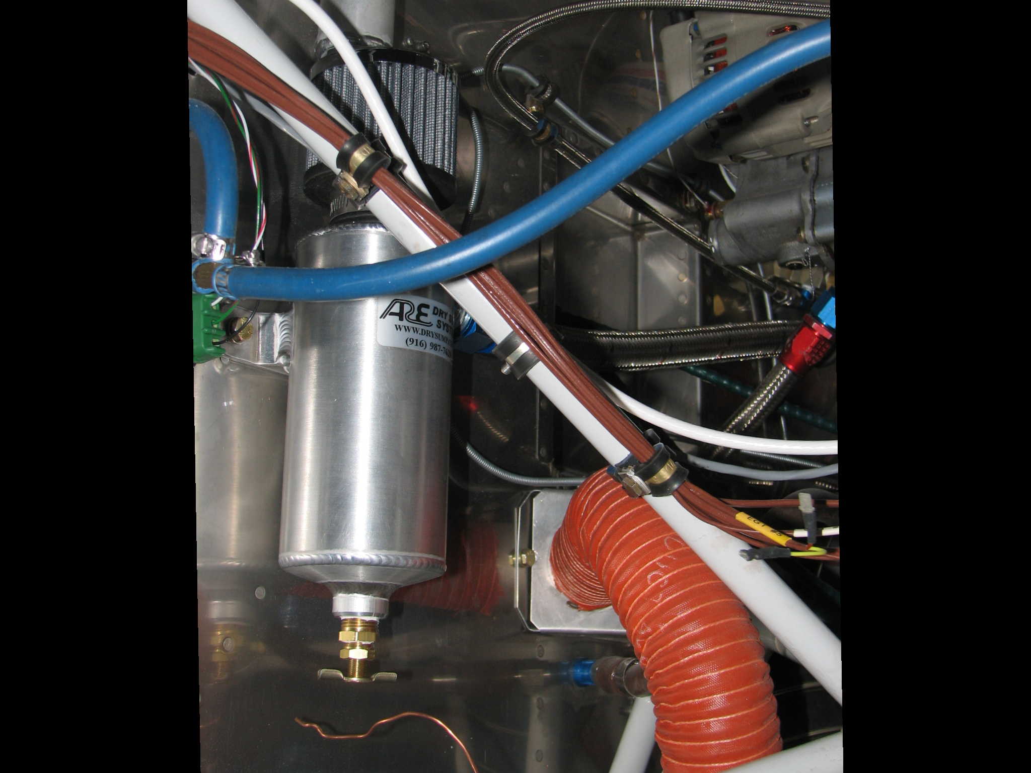

partner14
Joined: 12 Jan 2008
Posts: 540
Location: Granbury Texas
PostPosted: Thu Jun 12, 2008 5:23 pm    Post subject: Emailing: sb08-6-1[1] Reply with quote
Rene, I added a dry sump oil seperator that looks pretty cool.... might add a couple of pounds. I wanted to do what I could to keep the crud off the bottom of the plane. Designed for big block engines, so it should handle the IO540.
Don McDonald
#40636 Still Finishing.
Rene Felker <rene(at)felker.com> wrote:
[quote]--> RV10-List message posted by: "Rene Felker"
Tim, I fell into the forward CG trap. I put moving the CG aft as one of my
design objectives based on discussions on the old Yahoo list and this list.
In doing so I did move the CG back a little and now I am regretting it
because it limits the amount of weight I can put in the back of the plane
without running out of the aft CG. In the end I like what I did from a
design point and may have done it that way anyway.
I have a bigger battery in the back and I put my O2 system behind the
baggage compartment bulkhead.
I am now thinking of adding a little weight to the engine......got any ideas
on some useful things I could put up there?
Rene' Felker
RV-10 N423CF Flying
801-721-6080
