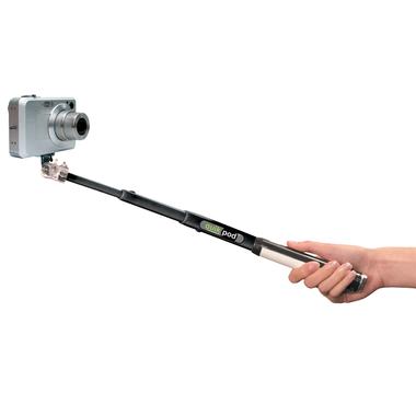

PostPosted: Tue Jun 10, 2008 12:07 pm    Post subject: Service Bulletin 08-6-1 Reply with quote
Regarding Tim's comment
"One person suggested using a hi-res digital camera (or HD video cam for that matter...I just got one) to do the inspection.
Probably a great idea."
I just came across this device called a QuickPod (~$25.00) One could set the timer for a photo or just video the area:

PostPosted: Tue Jun 10, 2008 12:24 pm    Post subject: Service Bulletin 08-6-1 Reply with quote
By using a digital camera to tap a few pictures of the area, I'll bet you can put the camera in the rear inspect cover opening and be able to see this area well instead of removing the emp fairing which has a ton more screws. Thoughts?
