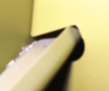

I have had an interesting comment by both an A&P and and RV6 builder while looking over my plane. They pointed out that in the tailcone the edges of the J channels touch the bulkhead cutouts. They were concerned that the contact under vibration could create a crack in the bulkheads. They both suggested that I bend the J channel edges down to prevent the contact. This seems like a lot of work (especially in the tight tailcone). I am wondering if anyone else has been concerned about this or has bothered to bend J channels. Is there a building standard about contact between parts like this?

That's a tough one!  In my mind (may not be a good thing Razz ) any wear will become an 'interference fit' and won't be sharp-edged.  The wear pattern would be smooth, like a fine file. and wouldn't be a source of stress cracks.  If there was pressure to the face of the bulkhead, then I may see it a little differently.  A little, little differently.  Your buddy has good eyes, though!!!

I noticed it during construction and filed the holes in the bulkheads a
little bigger so they didn't touch. Not sure if it is/was necessary though.

If you bend the J-channel, it will lose strength. The best way to
fix it is to file some gap into the bulkhead cutouts and then deburr
it. Yes, it's a lot of work, but the person/people who told you they
were worried about cracking are correct. Letting things "wear in"
just isn't right.

I'd second that. I found numerous instances of this contact. I even tested
it on a scrap piece by running it back and forth. Al to Al can produce an
edge on either piece bulkead or channel. I sometimes bent the channel just
enough to clear parts if it was only slight or I filed the bulkhead cutout
back some (rounded it out.).
In a couple instances I filed the edge of the j-channel down a little in a
clean large radius fashion. I saw this contact on the wings too.
To me over time the contact would fret and create a groove the width of the
j-channel stock. I was not comfortable with such a small radius groove.
