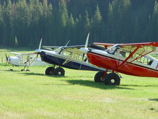

I've tried sending a couple of posts.. they do not seem to be showing up....
We'll try this one...
Just for fun !!!
I have a couple more I'll try and post tomorrow.. need to find them.
Fly Safe !!
John & Debra McBean
Ph 208.337.5111
www.kitfoxaircraft.com
"The Sky is not the Limit... It's a Playground"

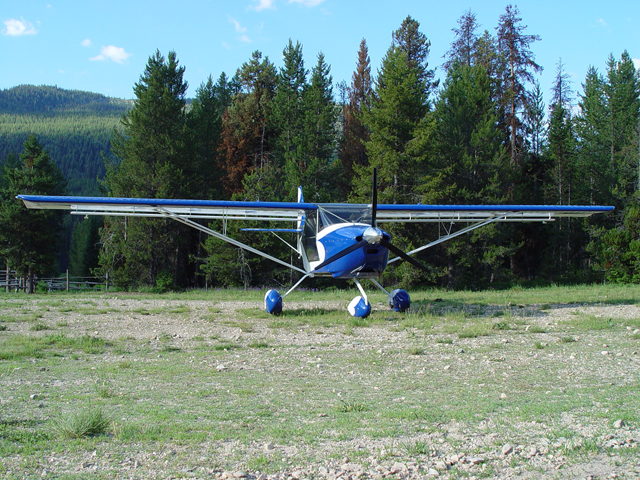

Just for fun !!!
Fly Safe !!
John & Debra McBean
Ph 208.337.5111
