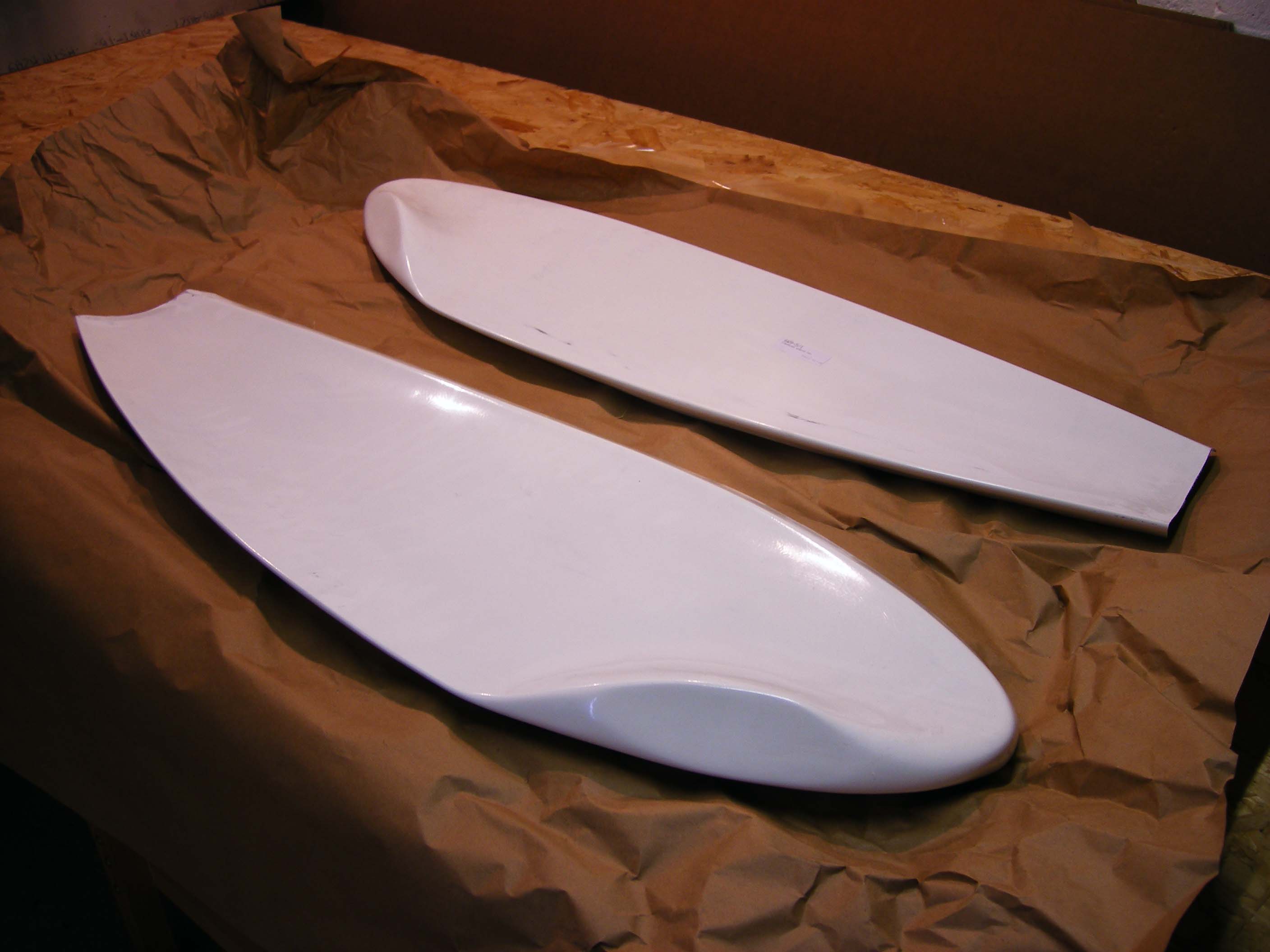

See attached photo Surprised

OK... let us in on the secret. Where did you get them?

They come with the new kits... I got mine 3 weeks ago I thought everyone knew.

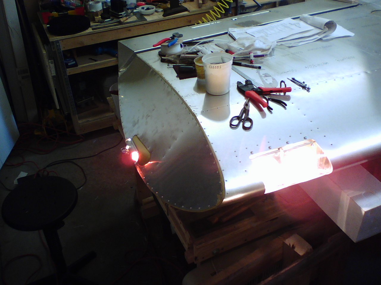

Made mine out of metal. It's supposed to be a metal airplane not plastic Very Happy

PostPosted: Sat May 17, 2008 5:05 pm    Post subject: Full Length Wingtips Reply with quote
Very Happy
Canopy bubble too? Wink

Did you get drawing or manual updates Jeff? mine show the shorter ones and I thought I had the latest revision.

I saw them up at Zenair on Friday. I think they are easier to install, but look just the same as the old two piece version. I like the two piece version since you can get access to the wing tip light easier if you need to.
In talking with they guys up at Zenair, they are making changes as they go from things they learn while building the LSA's for the US and European market. I believe the wingtips were done to allow for quicker installation....kind of like the new canopy they showed me.......much easier to install....

I'm not sure I will look when I go to the shop tonight and let you know. >From my experience with Zenith the plans don't change for awhile after a change because they have to wait until they send out all the ones they have printed but I will check.

I always install my wing tip with plate nuts so it can be removed so now it will require a lot more and I would also install the power unit for the strobs on the forward side of the spar and the wing tip was the access but now I'm thinking of an access hole and rivet the tip on. Decisions decisions.......
