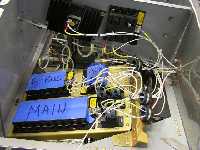

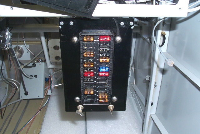

I have attached a photo of my solution to the fuse panel location. It is
hinged to the bottom of the instrument panel and swings back to a horizontal
position and is secured by two Camlocks. Since plan is to deal with fuses
only on the ground, it is out of the way during flight. My architecture is
based on Bob Nuccols Z-11. The diode connection to the e-buss is mounted on
the backside of the panel.
Hope this is some help.

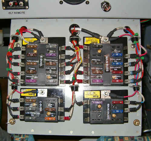

John, I have the same setup as you. I also made a drop-down tray.
http://www.flightinnovations.com/wiring.html

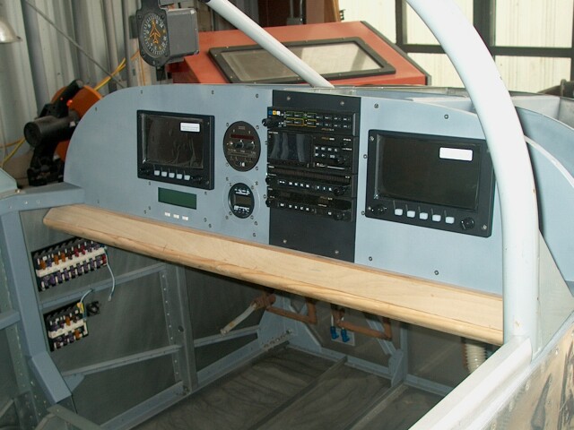

I mounted my fuse blocks directly to the fuselage side - dimpled the skin
and countersunk the holes in the blocks. They'll be covered by a sidewall
panel when the interior goes in.

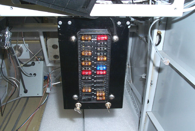

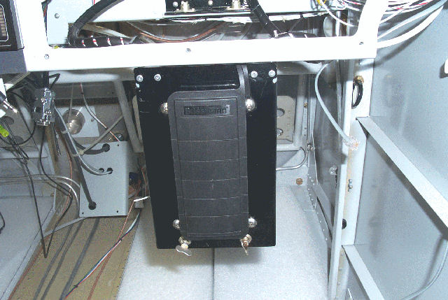

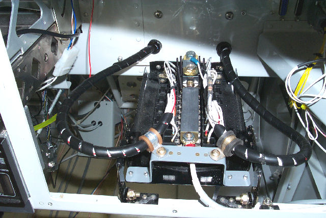

Here is yet another hinged option. This fuse block uses insert able
crimped contacts (no fastons and one less electrical interface). It is also
split 20 Main Buss, 8 Essential Buss. The two buses are tied by a schottky
diode bolted to brass busses (the stuff in the center of the rear of the
panel). The fuse panel swings down and forward from the front edge of the
panel and all of the wiring is in the rear.
