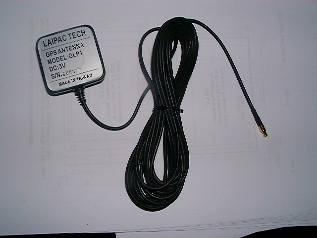

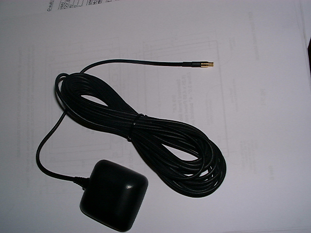

I have 2 GPS antennas to install, one is for my Trutrak ADI and the other
for the GRT - EFIS, both having internal GPS.
I attached 2 pictures of one of them, they are similar, both use a thin
cable (less than 1/8" outer diameter) and a miniature brass connector.
Since we must always seek to save some weight in our birds, I have 2
questions:
First question, which is probably dumb, but here it goes: can I install only
one antenna and T the cable for both devices?
Second question: if I want to get rid of that much cable length, can I cut
it somewhere in the middle, remove the unnecessary length, and reconnect the
cable ends? If yes, how do I do it?
Or is it better to forget the existing connector, cut the necessary length
and use a new connector? In this case, where can I find these miniature
connectors and is there a special crimper for these?
Carlos Trigo
 Filesize:  147.48 KB
 Viewed:  412 Time(s)
 Filesize:  142.35 KB
 Viewed:  381 Time(s)

nuckolls.bob(at)cox.net
PostPosted: Mon May 12, 2008 10:46 am    Post subject: GPS antennas with miniature connector Reply with quote
At 03:04 PM 5/12/2008 +0100, you wrote:
Listers
questions:
No, for a couple of reasons. One is that this antenna . . .
http://www.laipac.com/ant_GLP1_RA_eng.htm
is a powered device that gets its operating voltage from the
associated GPS receiver. Mixing two receivers onto a single
antenna offers some system integration as well as some
system reliability (single point of failure for both
receivers) issues. Recommend you stick with dual antennas.
From the photos, I deduce that your antennas are fitted with
the SMB series connectors. But these come in several styles that
include screw on and push-on. It looks like you have the
push-on style.
http://www.aeroelectric.com/Pictures/Connectors/Coax/SMB_push-on_1.jpg
http://www.aeroelectric.com/Pictures/Connectors/Coax/SMB_push-on_2.jpg
http://www.aeroelectric.com/Pictures/Connectors/Coax/SMB_push-on_3.jpg
Digikey sells these connectors but a quick look for tools
did not produce any hits.

for anyone with the skills, tools and connectors. You
may be able to find someone locally who routinely works
with these connectors and get the job done.
However, keep in mind that the antenna assembly's performance
IS BASED on the as-supplied condition . . . meaning that it
will perform as advertised with the long cables. It's
doubtful that you'll improve on that performance in any
way that you can perceived so this leaves you with the
goal of shortening the cables because it looks better
and saves a little weight.
Obviously we need to leave it to you to deduce the
trade-off for accepting the costs and risks for a
DIY cable shortening effort and the return on
investment for achieving a slicker looking installation
and a few ounces of weight.
My best recommendation is that (unless you can find
some local support in skills/materials/tools) you
leave them as supplied.
( . . . a long habit of not thinking )
( a thing wrong, gives it a superficial )
( appearance of being right . . . )
( -Thomas Paine 1776- )
simon(at)synchronousdesig
PostPosted: Mon May 12, 2008 10:49 am    Post subject: GPS antennas with miniature connector Reply with quote
Matt,
If his GPS antenna is powered by the receivers, then a T no doubt will
interfere with that function, as DC doesn't pass through transformers. If
Carlos can give us more details pertaining to the specific antenna and GPS
receiver models, then his problem can be analyzed further.
Joe Dubner earlier said he spliced his GPS antenna cable in the middle,
and it performed well. I am surprised, but I've seen stranger stuff
happen. I'd rather remove the connector, cut the cable, run it through
the small opening, and reinstall a new connector.
Simon
Oviedo, FL USA
<mprather(at)spro.net>
Aren't many GPS antennas active (amplified, powered)? If so, it
should be possible to design an impedance match circuit from the
output of the antenna to the input of the two receivers. It's
also possible that the output of the amplified antenna is robust
enough to not require any match circuitry for adequate
performance...
Matt-
PostPosted: Mon May 12, 2008 11:41 am    Post subject: GPS antennas with miniature connector Reply with quote
Right.. You'd have to admit though that it wouldn't be rocket science to
make 5VDC available to the antenna - from the antenna side of the matcher.
Then again, I'd likely try to find antennae that's smaller/lighter, and
with shorter cables..
Matt-
Matt,
Simon
Oviedo, FL USA
> performance...
> Regards,
> Matt-
PostPosted: Mon May 12, 2008 12:33 pm    Post subject: GPS antennas with miniature connector Reply with quote
Matt,
I admit it is not rocket science to provide DC voltage if you have the
source and delivery system for it. In Carlos' case, though, I believe his
goal was to squeeze nano-tons of weight out of whatever he was doing, and
an additional wire from one receiver or power supply to the antenna would
defeat this purpose. He might as well stay with the extra cable length.
In an earlier email, Bob said that two receivers supplying VDC will
introduce further complications, and one antenna feeding two receivers is
a single-failure point. These two statements are valid. If two GPS
receivers were going into my airplane, I would have two separate antennas.
Of course, I'm not as worried about weight as Carlos is either. I know a
guy who wants to cross the Atlantic in July and August, and he's in the
same "bloat."
Simon
Oviedo, FL USA
Matt-
trigo(at)mail.telepac.pt
PostPosted: Mon May 12, 2008 1:50 pm    Post subject: GPS antennas with miniature connector Reply with quote
OK, I surrender. I will use 2 antennas and keep those lengthy cables.
A 3 month diet will save weight on myself, which seems easier (apart from
being better for my health).
Thanks to everybody who answered.
Carlos
