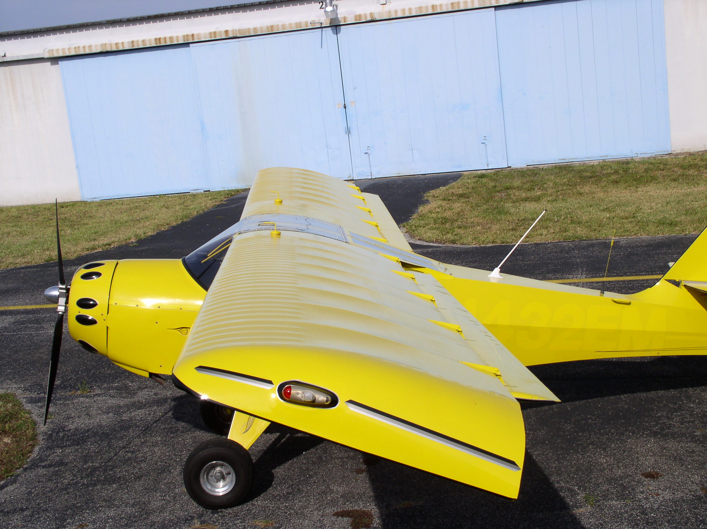

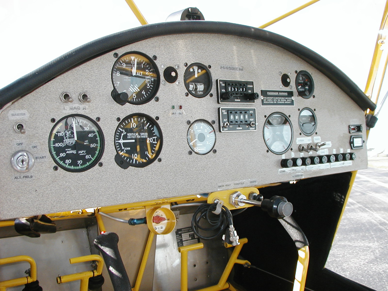

The airplane has been completed for over ten years and really haven't done any thing to it.
I'm in the process of installing wing cuffs, gas cap fairings from Williams Aviation and a radiator scoop from Kitfox.
Wing tips and wheel pants might be next.
Also just changed bungee cords from HighWing LLC, good quality product.
I have the old Matco WHLB5 brakes which never worked very well on an 8 inch wheel that was made by kitfox. Brakes where leaking and Matco suggested changing the O-rings (2-222 O-ring), which solved the leak.
They also suggested changing the brake line to 1/8 inch OD brake line for better braking. I will try the new 1/8 inch OD, will report if better braking.

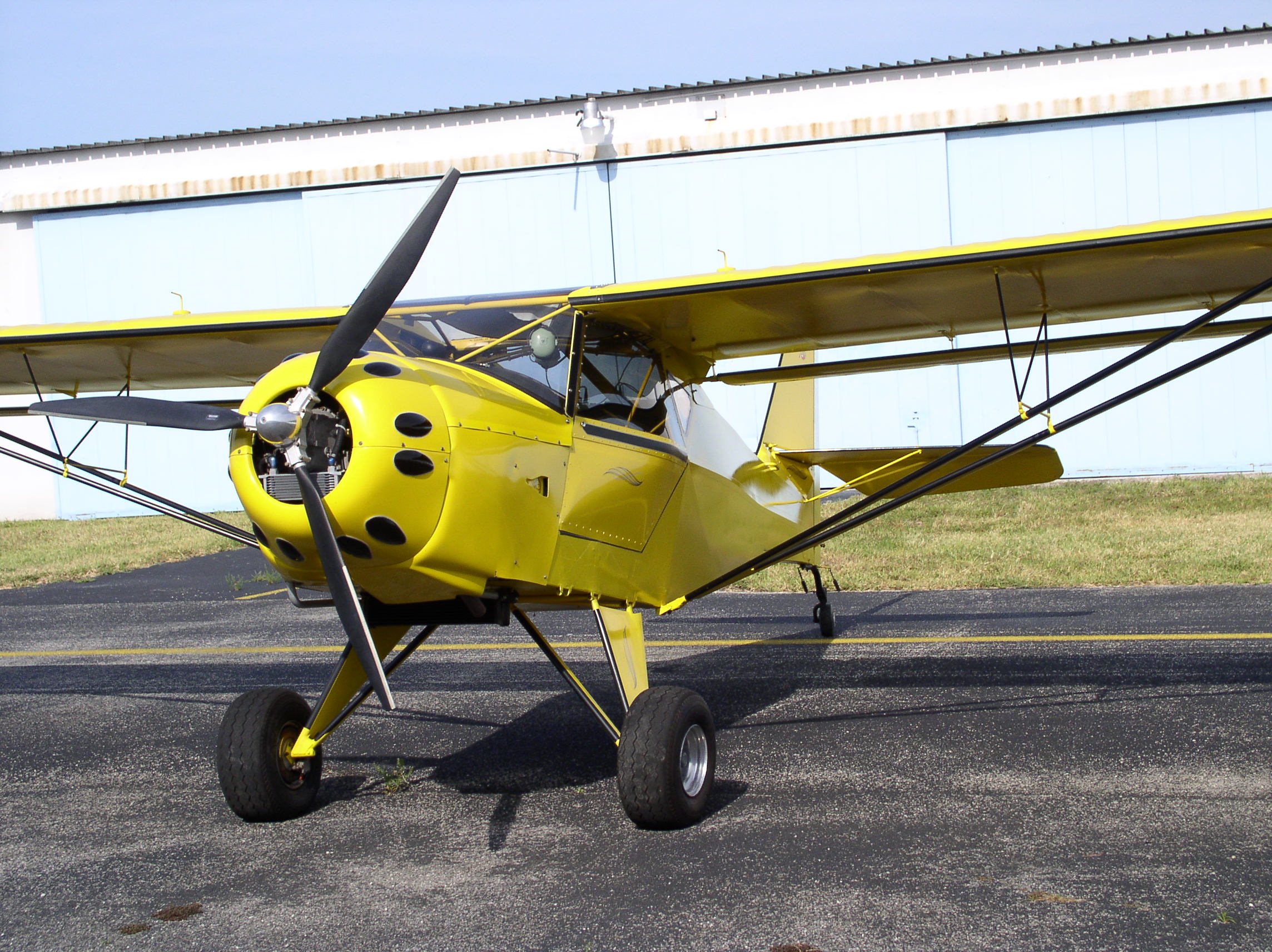

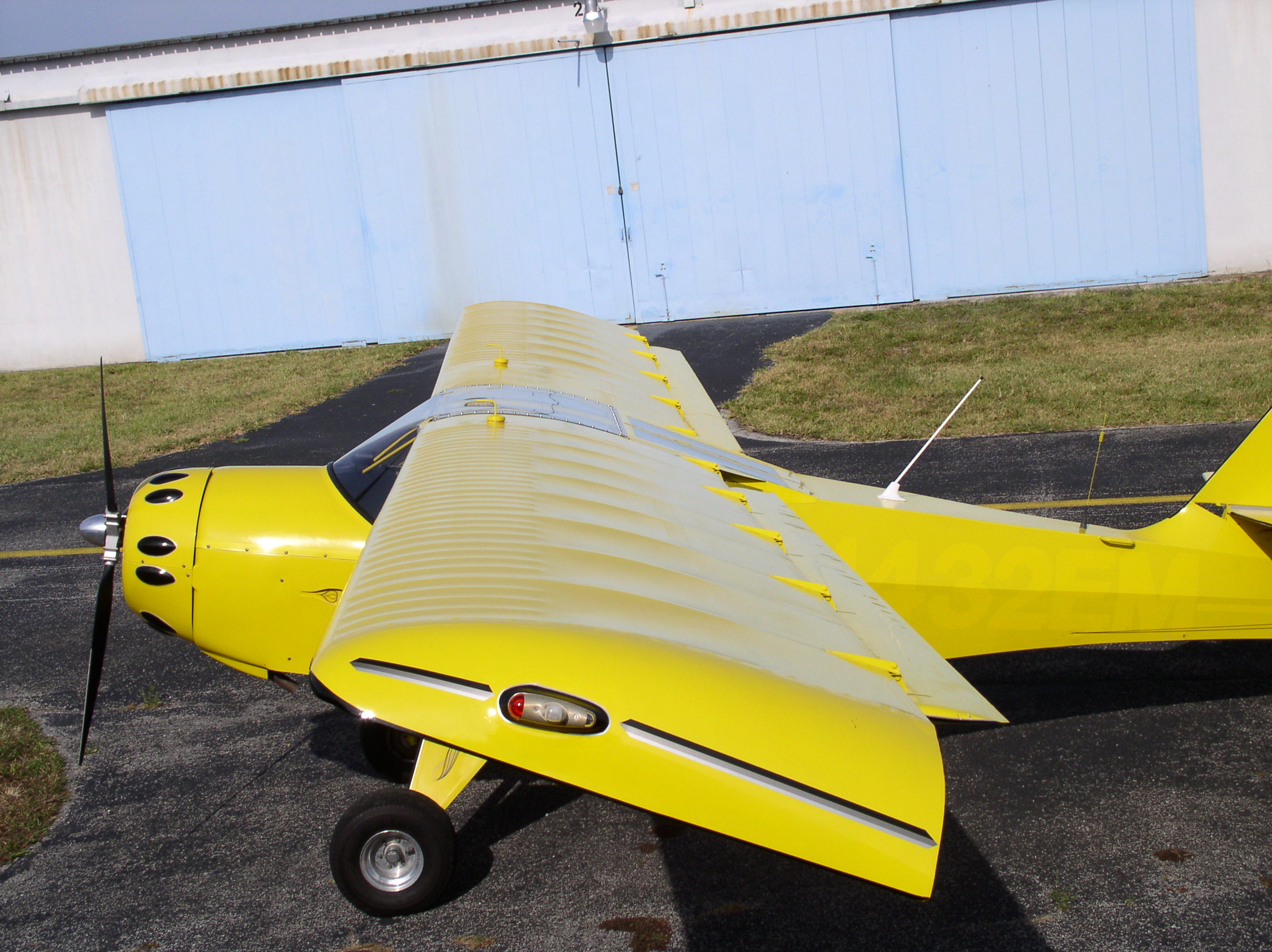

PostPosted: Sat Mar 06, 2010 3:34 pm    Post subject: Re: Clipping wing and putting on a Speedster wing tip Reply with quote
Added new wing tips and found no speed or performance increase.

PostPosted: Sun Mar 07, 2010 2:50 am    Post subject: Re: Clipping wing and putting on a Speedster wing tip Reply with quote
Great report and nice job!.
So wing tips are all aesthetic it seems.
What about soft field and short field takes offs?

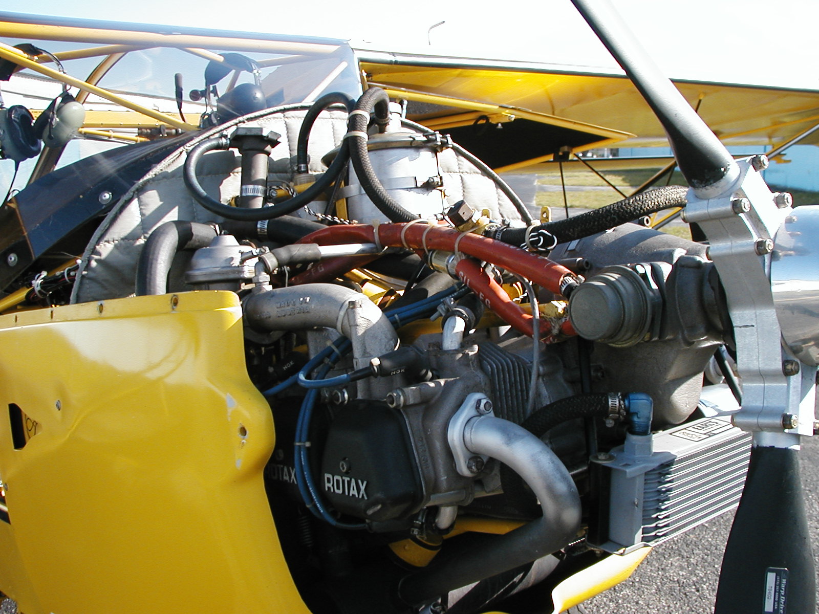

PostPosted: Sun Mar 07, 2010 5:44 am    Post subject: Clipping wing and putting on a Speedster wing tip Reply with quote
Yodaone,
Nice pictures. It helps to see other aircraft and how people do mods. I like your radiator scoop. I have one and was going to install it but it fit horribly. I had to cut and fit, cut and fit. I finally put it back in the box to do another day. I just got my airplane flying again after a month long annual. I ended up replacing all the hoses, gas lines, fuel gauge lines, wrapping the exhausts, new Kuntzleman Magnum strobes(sp),shim the gearbox/replace Bellville(sp) washers,etc.
But, I am now flying again and feel better about getting rid of all that old stuff.
There is a guy down the street who is selling a Kitfox 4 project for $10000 (no engine/instruments) it has the mount for the 912. Anyway he has two sets of wingtips. I had thought about getting rid of my droop tips and buying the speedster type from him and putting those on but after your report, I think I will keep what I have.
I guess my next projects on the plane will be replacing the brake lines with 1/8 inch line. ( I have the line and fittings) My old Matco brakes don't work very well so I will give that a shot and then maybe on to the radiator cowl again.
