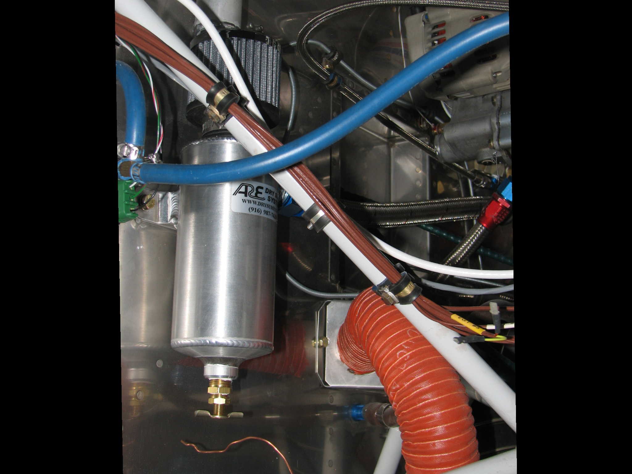

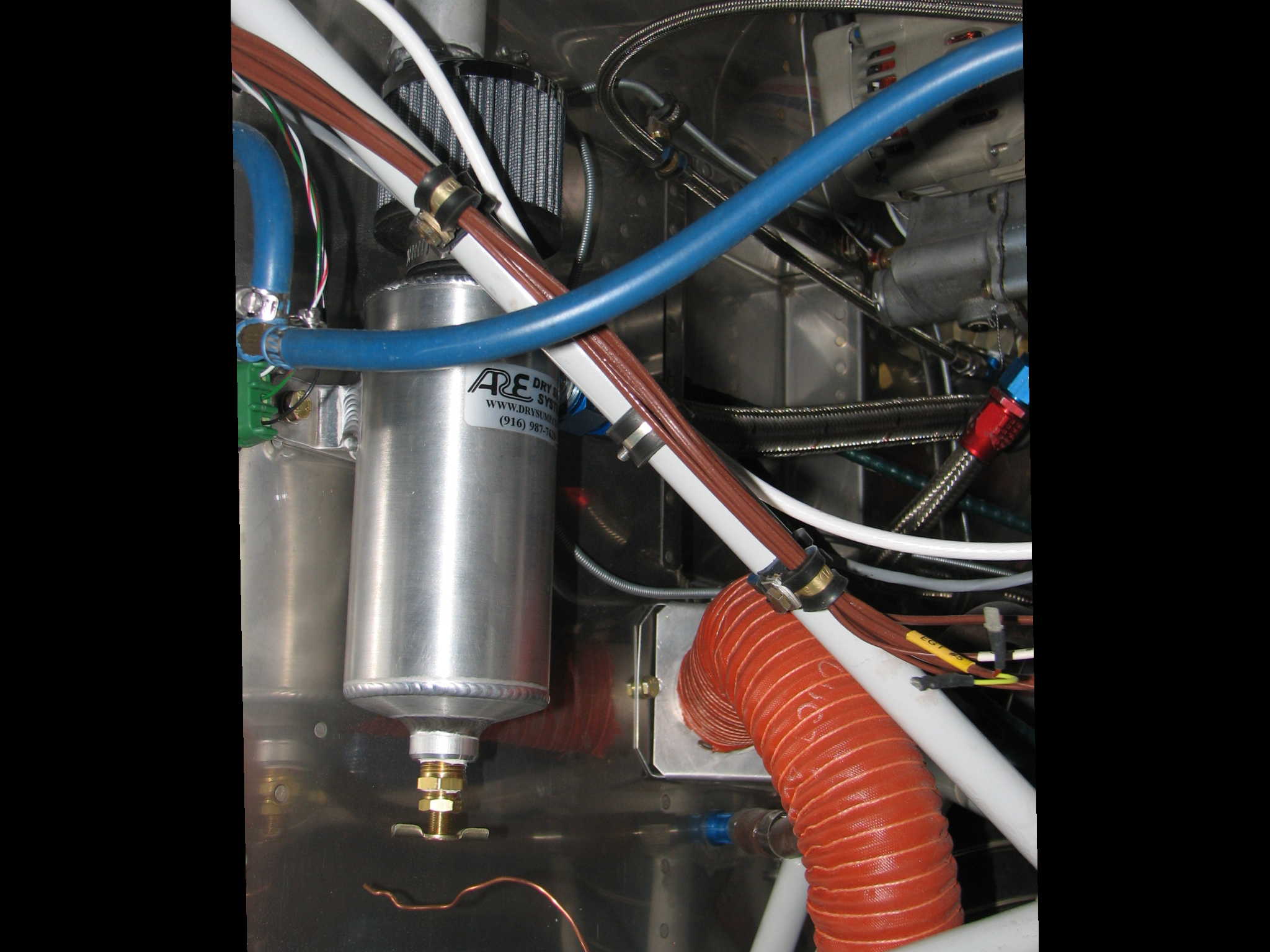

I was hesitant to reply because I have yet to launch the bird... I didn't like the idea of dumping the breather contents onto the exhaust, so I found a nice looking big block dry sump separator with baffling inside and a K&N filter on top. Unit is priced under $100. I did modify the connection to handle a larger AN fitting, but other than that, it connected up just fine.
