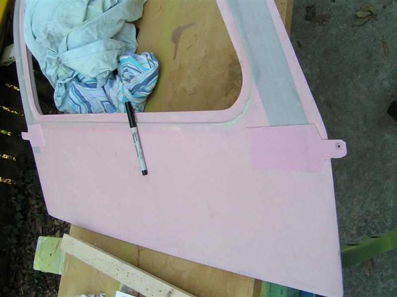

The first step in working with the doors is to locate and drill 6 index
holes per door (45-02). The 2 fore index marks are missing and one of
the window index holes has been ground away. I have the pink doors.
Has anyone else run into this? How did you address it.
I have a call into Vans and they are going to attempt to take
measurements. This isn't going to be easy given the compound curves and
lack of clean straight lines. I wonder how critical the precise
location of these holes is?

From my experience with the green doors, the provided index holes
weren't very accurate, and do affect the final fit of the door.
For my second set of (pink) doors, I centered the C-1002-B inner door
shells in the cabin top cutout. You'll find that they will slide about
20 mm fore and aft, and about 25 mm up and down in the cutout. I
marked the extent of travel in all directions, then centered the door,
and back drilled the door from the existing holes in the aluminium
structure. The right door's index holes were correct, but the left
door's index holes were off by about 2-3 mm.
The outer door shell can then be centered on the inner door shell,
using the window joggle as a reference, and the four corner holes
drilled.
FWIW, I continued to cleco the door shells all around their perimeter,
rather than relying on clamps/weights to hold them together when gluing.
Now trimmed, hinged and latched, the doors fit extremely well.

Here's a thought on the doors. Ours are pink and I didn't give it a whole lot of thought aligning them up prior to gluing -- the forward hole in the ear just below the windshield junction seemed to work just fine as a starting point.
What I did notice (and didn't think to share until now) was that after centering the handle mechanism in the pocket per directions, there was a slight difference in penetration of the fore and aft rods -- as mentioned above.
So what I did on the SECOND door (since the second almost always benefits from experience with the first, I try to do the least used or noticed first!) was temporarily fit the rods in the mechanism with the rods either fully extended or retracted, THEN mark it for mount in the pocket based on equal distance at the tips -- problem solved. So if there's a slight misalignment in gluing the door halves together, at least in terms of rod extension, it doesn't matter.
Later, - Lew

The four inch hand spring clamps work great too rather than making holes in the canopy top...that is provided you still don't have either the windscreen or the rear windows in. A helpful hint also is to cut strips of 1/16 or 1/8" ply to distribute the force of the clamps. The clamps can be placed about 3-4 inches apart from one another.
As per indexing holes on the halves, only two of mine lined up anyway on each door. They were pretty worthless. Vans fiberglass???
Here is something no one else has mentioned. In addition to the dog ears on the lower half of the doors which index the door to the fuselage opening, I also made an aluminum jig from 1/8" aluminum. It was held onto the door with two clecoes and one hole into the existing open holes in the fuse(Total three clecoes each jig). Each door has a fore and a aft jig.These serves to keep the alignment after the dog ears are removed and can be used for all types of things. Makes sure that any subsequent fitting or sealing or pin adjusting, etc is done in exactly the same door position. KEY!
JG

I mentioned the tabs (dog ears) about a month ago. :>)
-Chris Lucas

Most builders would likely agree how easy it is to accept the recommendation of a respected firm that already consistently produces kits which are easy to build and contain reliability of quality for just about any novice tinkerer. I can't speak to R.O.s.
I will say that products, chemicals, processes, tools & build talent are moving (improving) at a far greater pace than most companies with sustained production power will adapt and incorporate - that is technology on the march.
I for one, love the cooperative sharing of this community and the ability to improve, enhance or just modify a great product... "the four passengar cruiser airplane" with actual room to move during a memorable flight even while sitting in the back with the kids, another adult friend or the family dog.
Repeat Offenders... their name reveals their passion.
Of only our governments were more progressive, more entreprenuerial and less socialistic. Oshkosh tends to equalize that every year for one long but nostalgically brief week.
John Cox
From: Chris and Susie
Sent: Mon 3/23/2009 2:18 AM
Subject: Re: Re: Missing index holes in doors
[quote]--> RV10-List message posted by: "Chris and Susie" <vhicy(at)bigpond.com> Dont put us repeat ofenders all in one basket! Chris VH-ICY Do not archive ---
