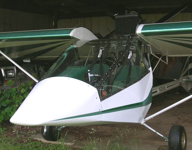

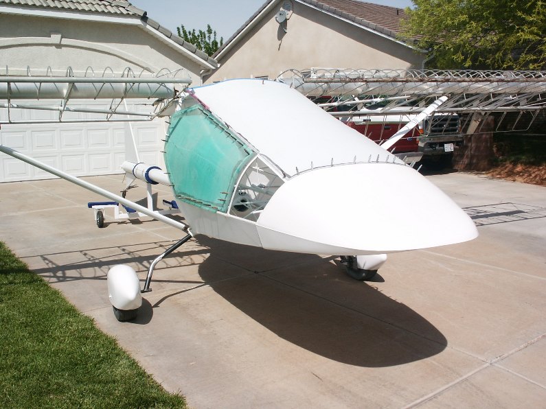

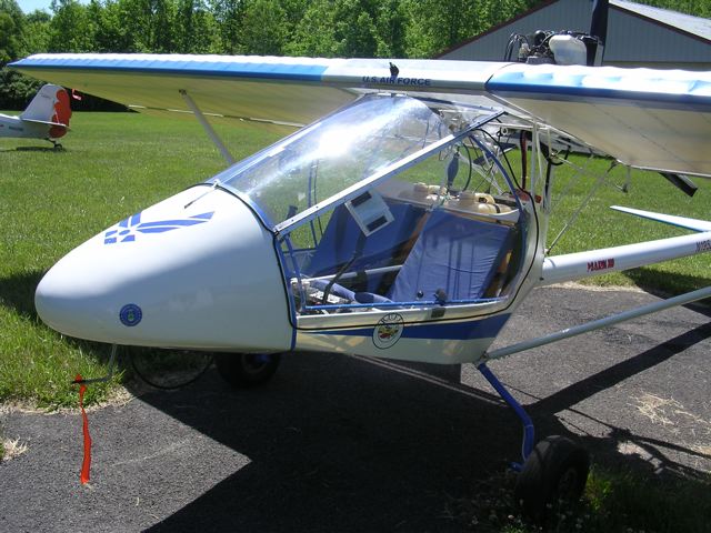

PostPosted: Sun May 04, 2008 11:23 am    Post subject: gear legs Reply with quote
for comparison:
a locally based MkIII (with steel factory legs)
my duck-billed creation:
welded steel tube windshield posts
more foot room on the rudder pedals.
It all comes apart with 10-32 screws
DSCN1158.JPG copy
