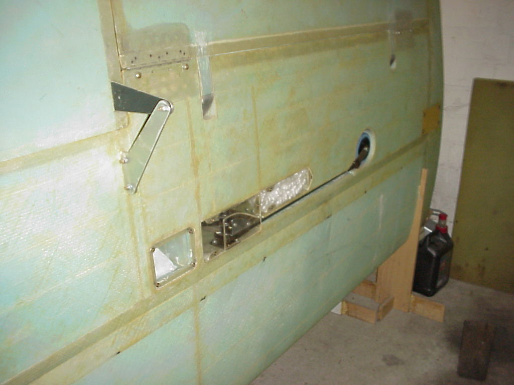

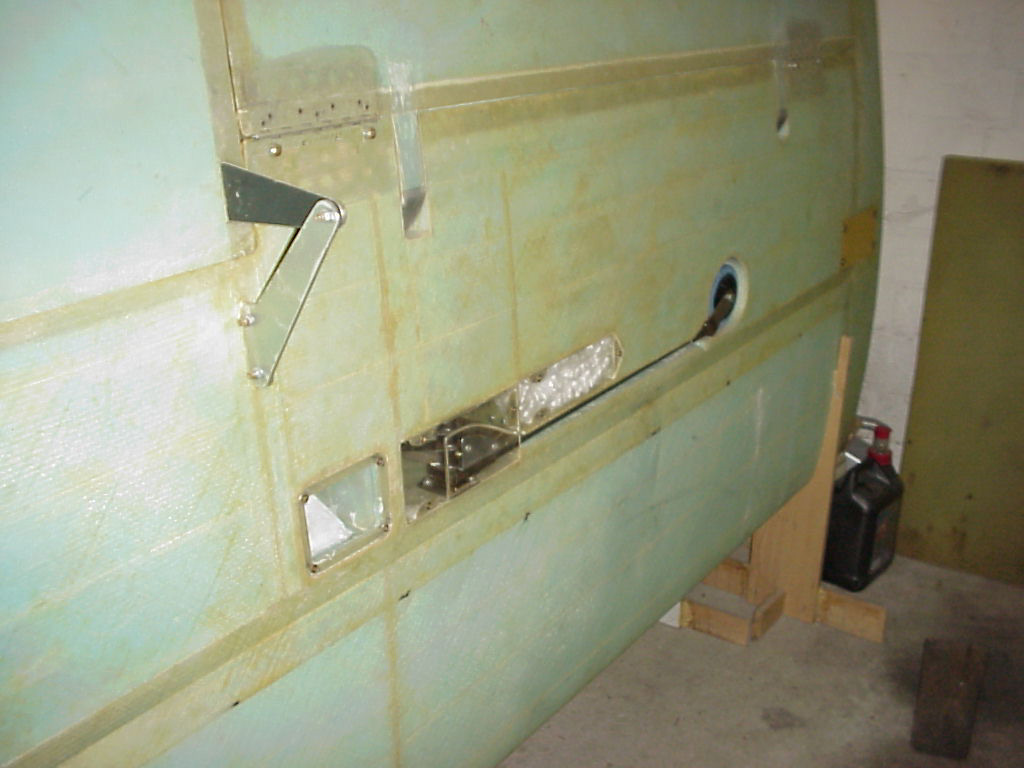

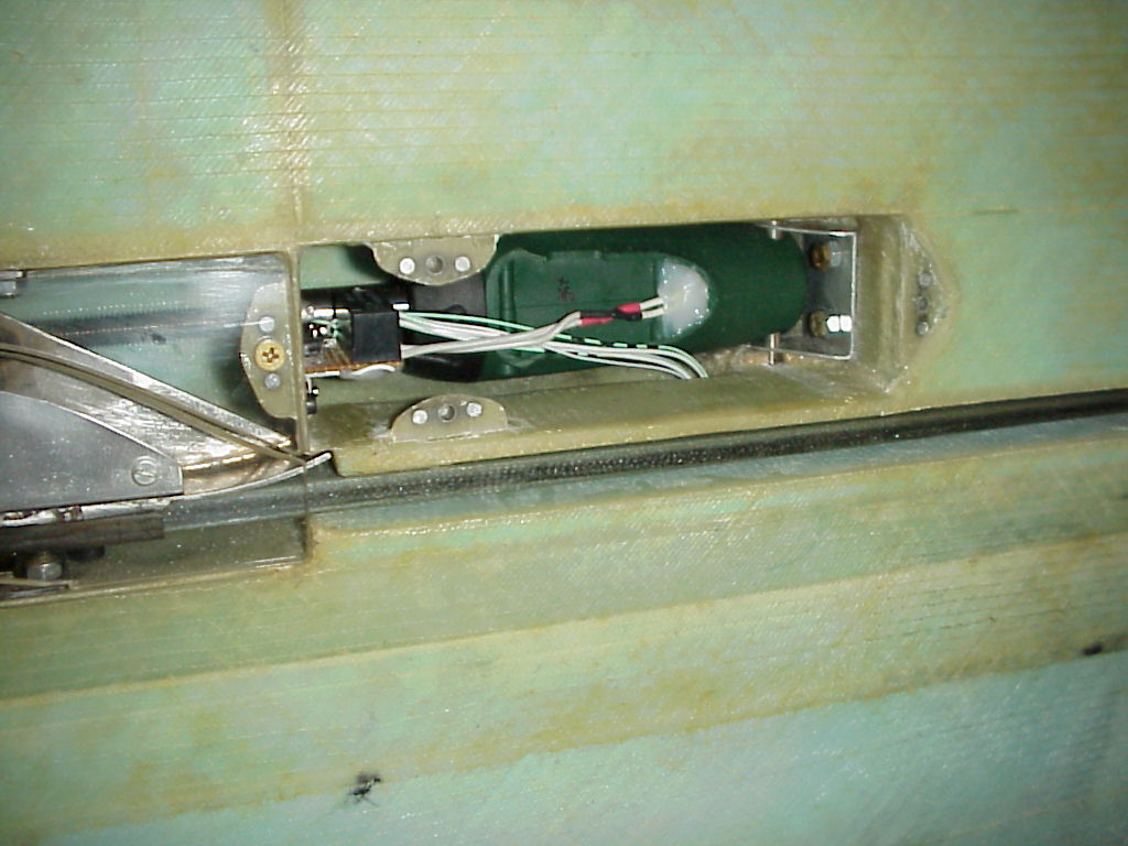

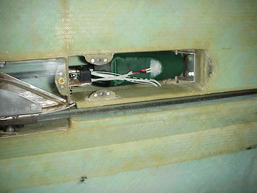

I only have two piks of the outrigger; this was a German guy near
Hamburg whose name I don't have. It was at least 8 years ago. Jens
Gralfs <Jens.Gralfs(at)airbus.dasa.de> might know. Failing him Harald
linke <0406055601-0001(at)T-Online.de>
Graham
