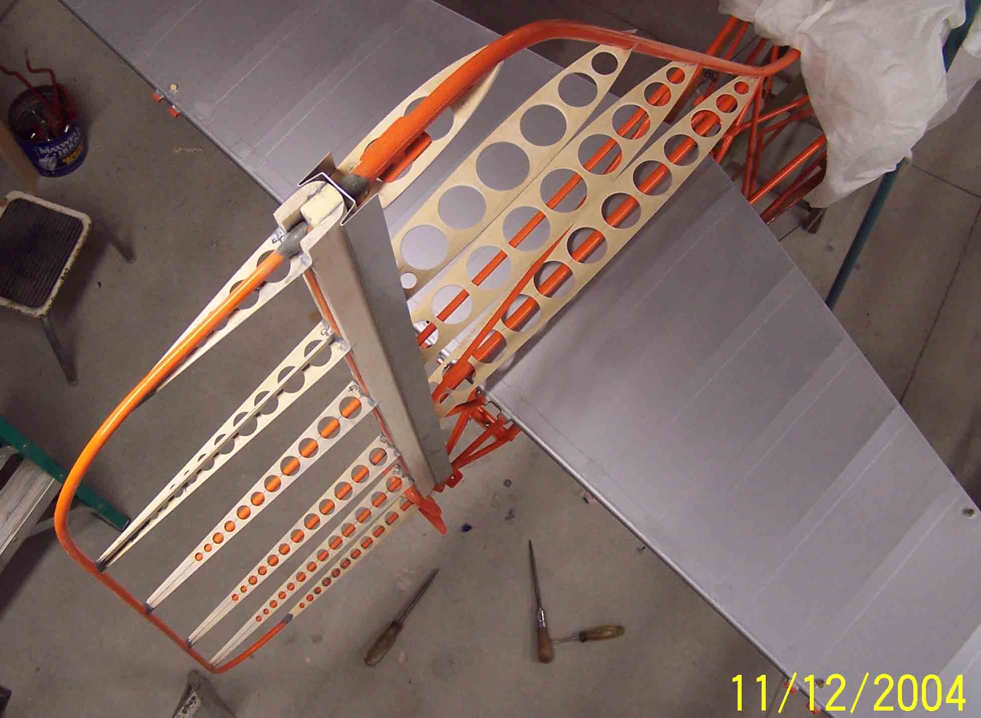

I've enclosed a picture of my vertical stab when I added some
airfoils, and a gap-filling method that I used during my building. It
may be more than you want to do, but thought I'd include it for your
edification. After I shot these pictures, I added a vertical
stiffener to each horizontal rib, as has been done on the 2nd rib
from the top on the rudder. The formed piece is aluminum sheet, and
the rudder pieces are balsa wood on the sides, with the foam stuff
that Skystar included with the kit, sandwiched between.
Lynn Matteson
Grass Lake, Michigan

I learned from this group that if the rudder and fin are left
"skinny", like a Cub, that the tail will "hunt", that is, move from
side to side a bit, looking for neutral air. Others on the group say
they notice no such hunting. I just didn't like the skinny look, and
wanted to make the verticals fatter, for looks if for no other
reason. I just eyeballed the shape of the ribs that I made, sort of
following what Skystar offered, but making mine a little less fat. I
drew up a shape for that aluminum "female" piece, and had a local
sheet metal shop bend it up. After that part was done, I added a cap
on top of the fin and rudder of foam and balsa, and filed to shape.
I heard (from the grapevine) about your elevator trim mod...you'll
love it. I have my control on the panel as a rocker switch.
By the way, I now have my TruTrak ADI installed and it works great.
If I ever get....no, better make that WHEN I get stupid again, it'll
be nice to be able to have a reference for pitch and roll, and
direction, all on the same gauge. Thanks for your input on that matter.
