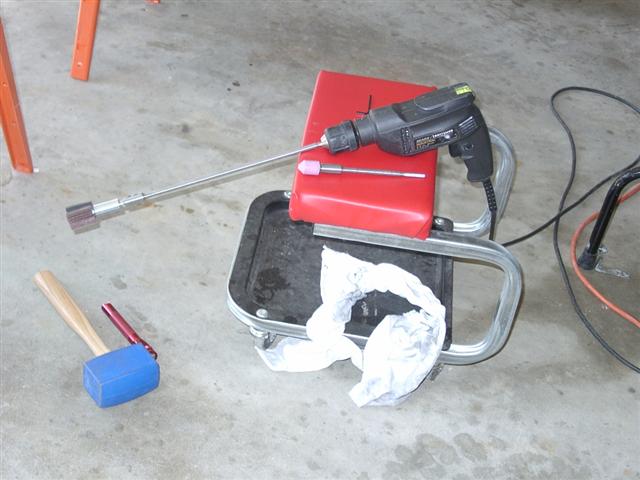

I used a stone with extensions and a flapper wheel. See picture.
I bought the extensions through the mail from McMaster-Carr.

lcottrell
Joined: 29 May 2006 Posts: 1494 Location: Jordan Valley, Or
Posted: Fri Apr 04, 2008 8:23 pm Post subject: Die grinder? |
| Quote: |
Rex Rodebush
Gang,
I found a "Brake Cylinder" hone and a extension that all should do a
great job. Thanks guys for your suggestions and help. I couldn't seem to
think of what to ask for.
Thanks again.
Larry C
