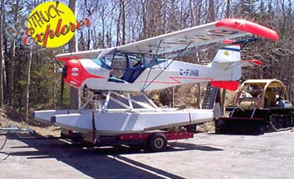

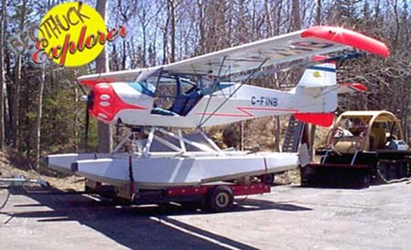

PostPosted: Sat Mar 29, 2008 5:59 am    Post subject: Black paint Reply with quote
Something like this Michel
In flight

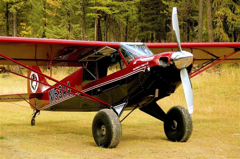

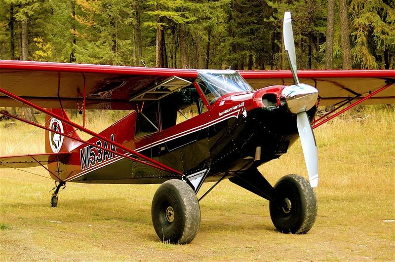

PostPosted: Sat Mar 29, 2008 7:22 am    Post subject: Re: Black paint Reply with quote
Rich,
My Series 7 has a bunch on black on it but I avoided (with the exception of wing tips & stab tips) painting any horizontal surfaces black. I pirated the scheme of one of the best looking Aviat Husky's (in my opinion) I have seen. I have not had it out in the sun yet but I don't think there will be any problems with my particular scheme. Another problem with the dark colors is they show nearly every scratch. Attached is a picture of the Husky...my Kitfox has nearly an identical scheme.

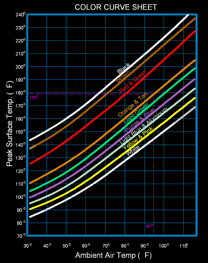

PostPosted: Sat Mar 29, 2008 9:51 am    Post subject: Re: Black paint Reply with quote
Thanks, everyone, for chiming in on the black paint issue.
I did a little digging across the web and found a graph (attached below) that portrays surface temperature as a function of paint colors. This comes from a website run by a Long-EZ owner-builder who said that "Uncle Burt (Rutan, the Long EZ designer) has essentially said 'you can have a fiberglass airplane in any color you want, as long as it's white.'"
(No doubt a twist of phrase on Henry Ford's famous line that said, I believe, "You could have your Model T in any color as long as it was black.")
Note the reference to the dreaded fiberglass, which is probably the surface material used to compile the graph. For those of you who are interested in reading the whole page, the link is:
http://hallert.net/cozy/paintideas.htm
One interesting aspect of the graph is that the color red is not necessarily your friend either (my KFox is currently red) when compared to the lighter colors, although it does stand a clear 20 degrees lower than black.

PostPosted: Sat Mar 29, 2008 6:42 pm    Post subject: Black paint Reply with quote
Ever notice how the big composite planes all have white skins? 777 engine nacelles only come in white. On the other hand ever try to polish a black car on a sunny day??
Composite or cloth stick to white on top.

Nice looking mean machine! Those tires are awesome. I do like the paint scheme. Keep an eye on the tapes, especially on sunny days.
Rick
