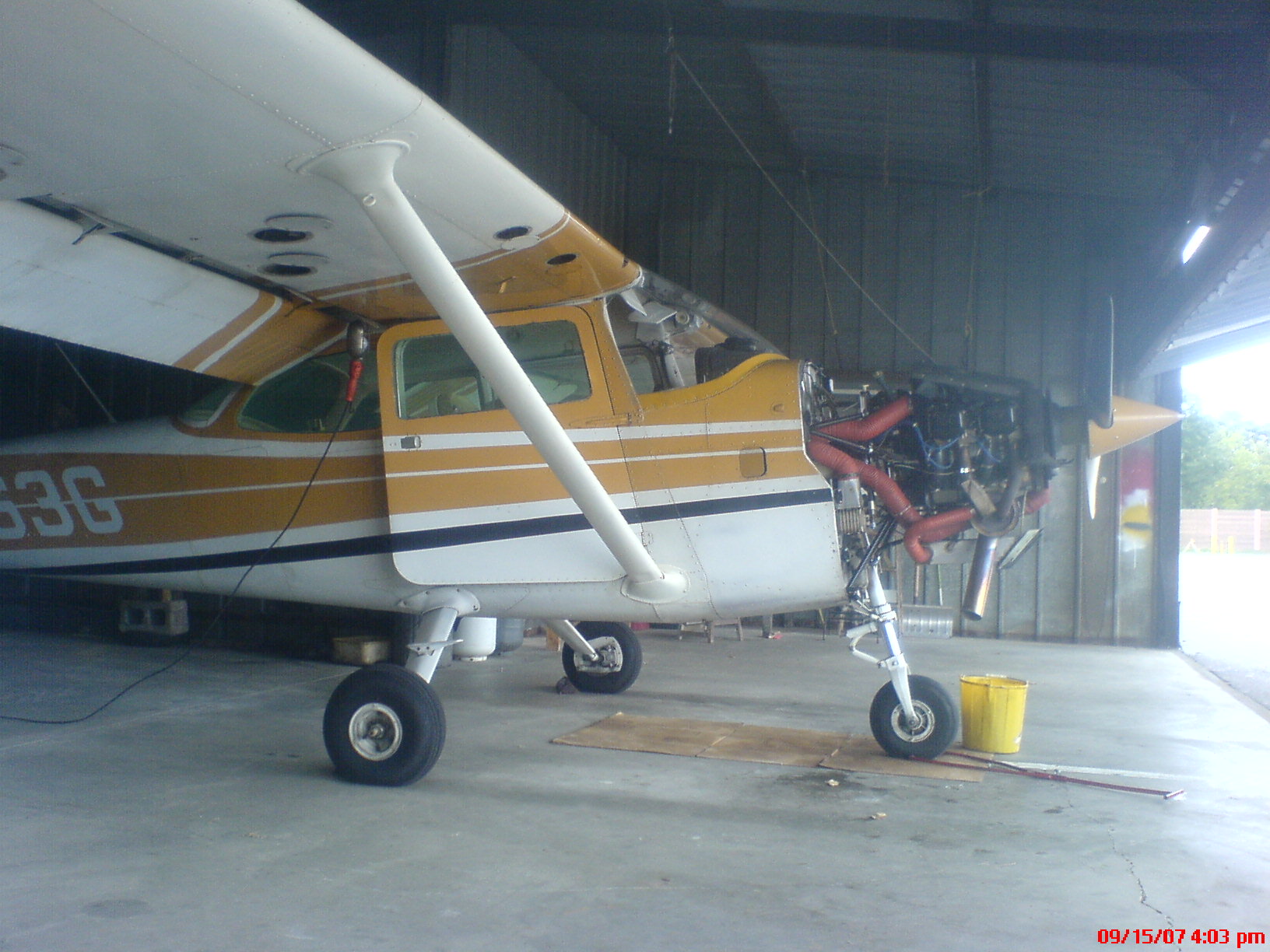

Forgive me if someone has mentioned this in the past, but has anyone tried to use, for cabin heat, the type of device that is used on (at least) a C-172L to collect hot air for carburetor heat?
It is a simple, foward facing, open-ended stainless box,with small tabs top and bottom, and is attached to an exhaust header with 2 stainless hose clamps. Must weigh all of 3-4 oz's. Airflow in flight forces hot air radiating the pipe to flow to the carb.
This is the best picture I have, but if you zoom in you can see it attached to the rear exhaust header feeding hot air to the carb air box.
Simple, cheap, lightweight, ....and available pre-fabricated.
Just a thought....

Yes.. that's the heat muff. Sometimes people have also stuffed them with
stainless steel Brillo pads to help heat conduction to the air. When using
this type of heater a CO detector is a must!
I have also seen a system on a Rotax 503 where there was a duct taken off
the cooling air for the head and run forward to the cabin of a Challenger.
Noel
