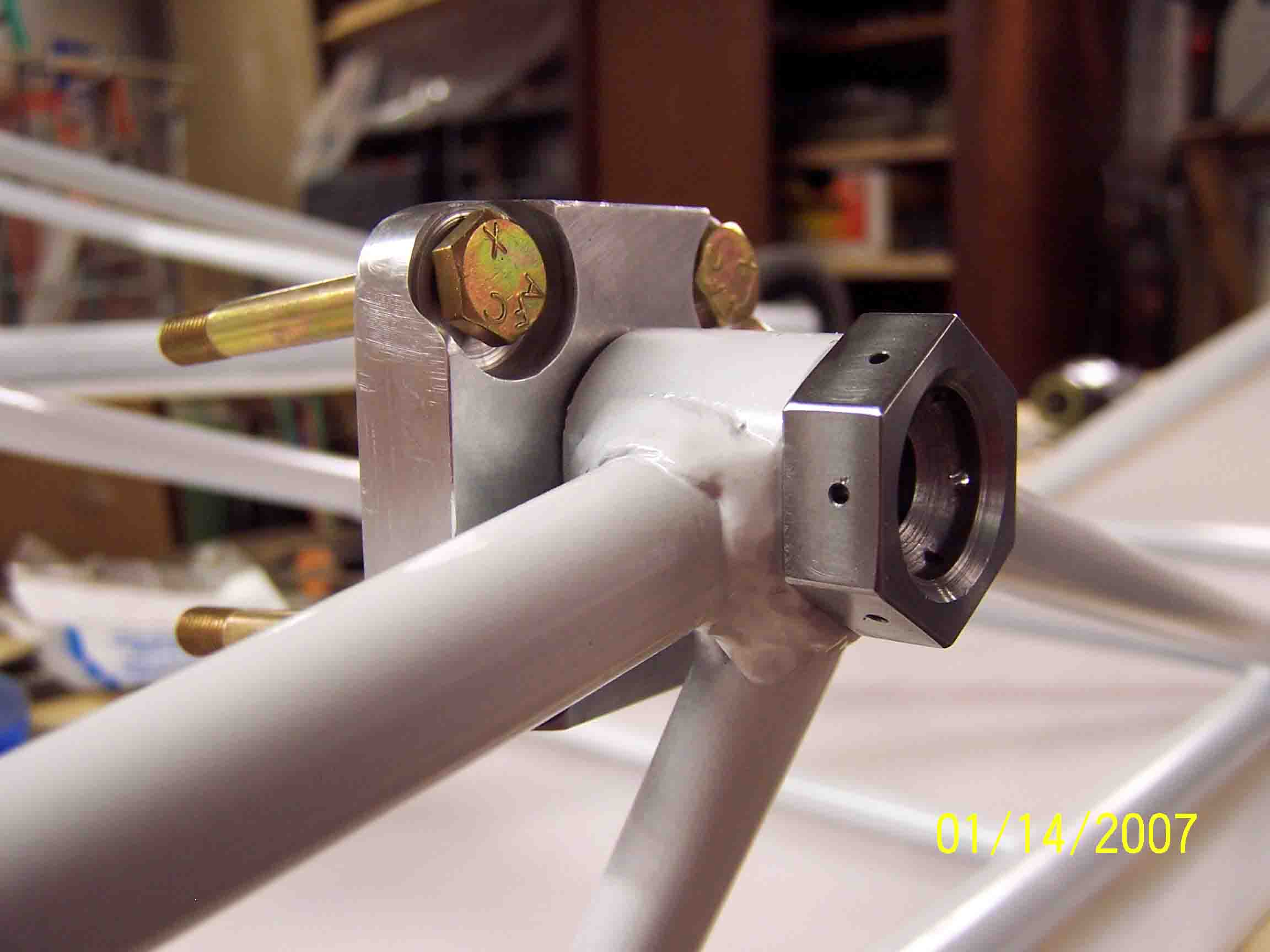

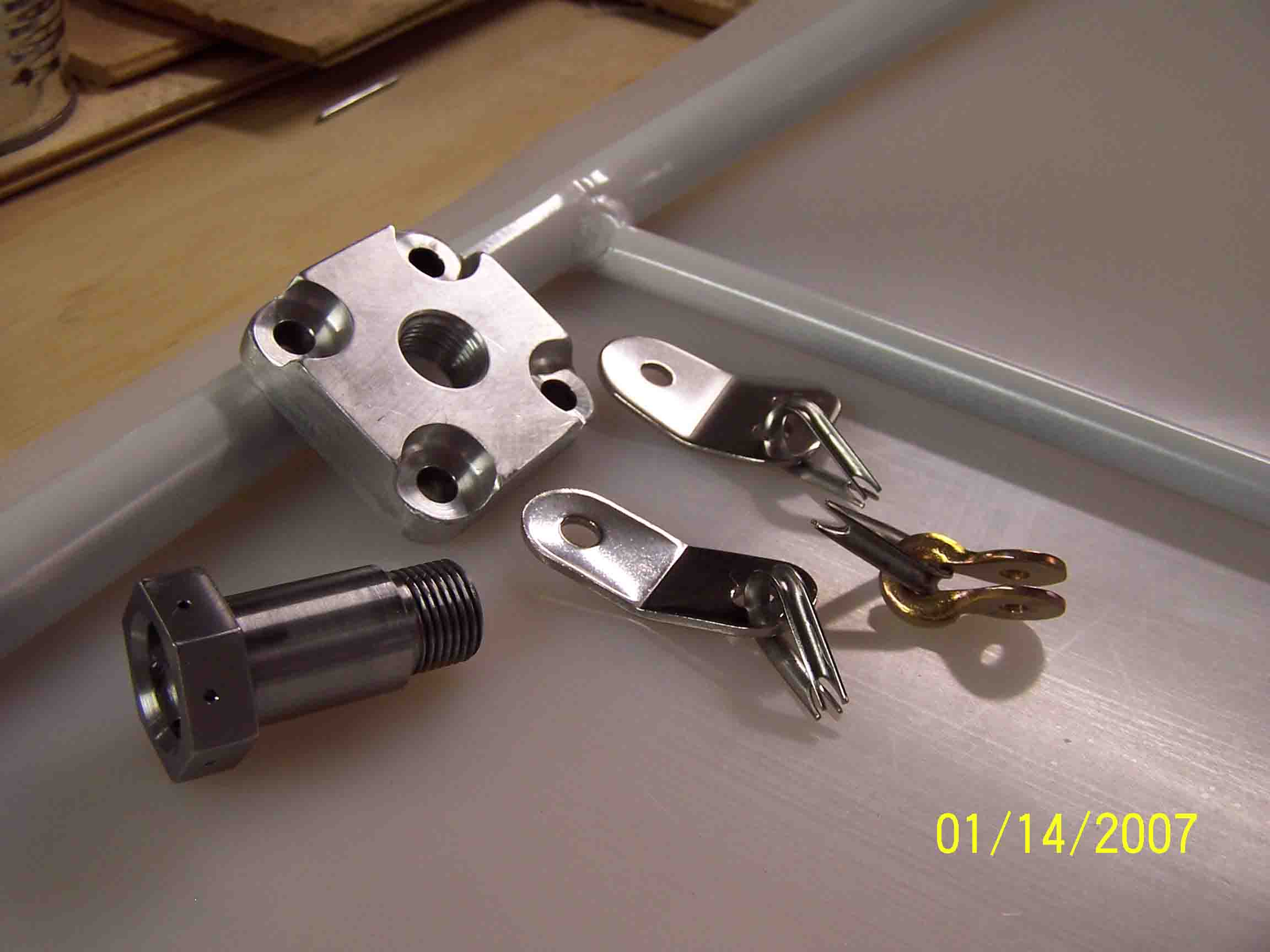

I built mine from round 4130 tubing. Tires are 16" OD, penetrate 2",
but I would make that less next time.
My inner mounts are pictured below, with some of the hardware shown.
I'm looking for pics of outer "axle."
The square aluminum block is bolted to the inner surface of the Grove
gear, and I added a zerk fitting to the ski at the bearing area. The
1/2" outer axle slides into the Grove axle.

--> Kitfox-List message posted by: Lynn Matteson <lynnmatt(at)jps.net>
I get so much drag with the tires poking through as far as they do,
and if I was to reduce that penetration to 1" instead of 2", I could
close up the hole that the tire protrudes through. Or, another school
of thought is to make the skis hydraulically operated, and instead of
a hole in the shoe for tire protrusion, make a notch like I have seen
on other skis, where the tire fits into a notch. Then the ski is
kinda "L" shaped, with the wide part of the ski out front like the
bottom of the "L", and the tire fitting into the notch which is the
included angle between the bottom of the "L" and the vertical part.
With this arrangement, there is no part of the shoe that will try to
undercut the snow and cause drag. This is what I fight now with shoe
area right behind the tire. I've seen this type of ski in pictures,
and I've surmised that it could be built as a rigid setup, or
possibly as a hydraulically-actuated lowering ski, that would take
the tire drag right out of the picture.

I think it would be fun to try and make them out of aluminum sheet,
formed and riveted into a structural shape, then apply the nylon/
plastic/UHMW material on the bottom as a means to keep the shoe from
freezing/sticking to the surface.
