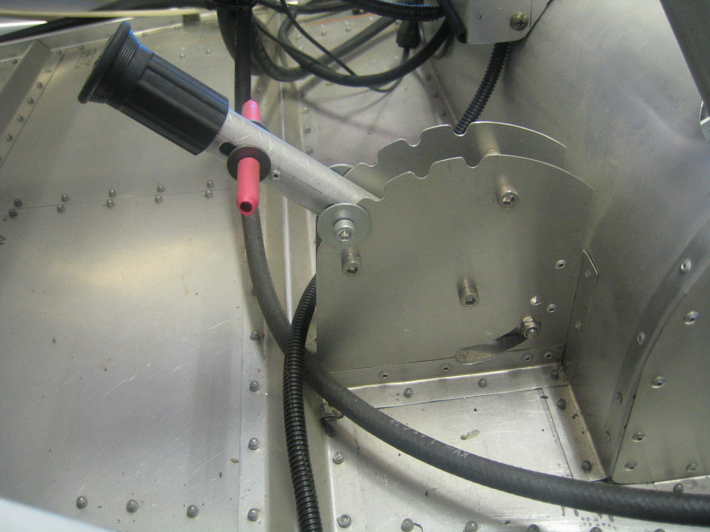

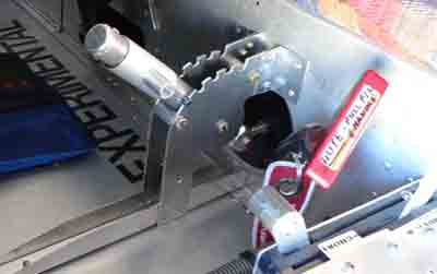

My left arm is weak because of an old shoulder injury so I found it difficult extending the flaps on my new 701. It took two hands, so whenever I used the flaps I had to l<?xml:namespace prefix = st1 ns = "urn:schemas-microsoft-com:office:smarttags" />et go the stick, and the plane would start to dive before I regained control… not good close to the ground!
So I looked around for alternatives. I rejected electric flaps because I didn’t want to increase the potential for failures (shorts, motor burn-outs, etc). Michael Heintz at Quality Sport Plane in Northern Ca. came to the rescue with the perfect solution, a flap handle with mechanical advantage. It is very easy to deploy the flaps using this device and even gives a few more degrees of flap if you need them (see two attached pictures). You can visit Quality Sport at http://www.qualitysportplanes.com/qsp-2006_023.htm if you are interested in purchasing one. <?xml:namespace prefix = o ns = "urn:schemas-microsoft-com:office:office" />

My understanding is that Michael has a machinist make up a batch when he
gets a few orders. I think the price for the control was about $300+.
Suggest you contact Quality Sport to find out about availability and exact
price.
It took me about 1/2 a day to do the installation. I used the same rivet
holes that the old flap handle sat on. You have to cut the flap handle off
and insert a cylindrical fitting, that comes with the unit, into the
remaining flap control tube. This fitting has an adjustable threaded end
that attaches to the new control arm. It takes almost no effort to extend or
raise the flaps and its easy to see just where your flaps are set (each
detent is about 5-degrees of flap).
Les

The flap angles are approximately 5, 10, 15, and 20-degrees. I have been
told to use care extending to 20-degrees because Zenith once provided about
25-degrees of flap and some people "got in trouble" using it.
Les

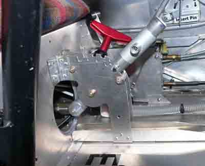

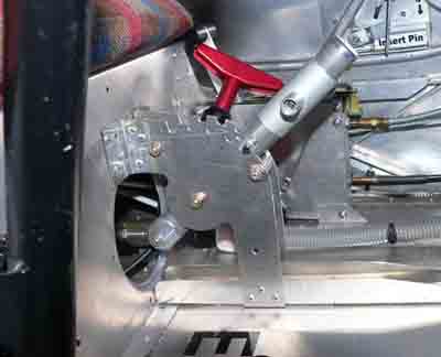

Les, there are some other versions on the list too, this is what I done.
Full up is actually + 2 to 3 deg, for a slightly better cruise, down limit is 12 to 15 deg.
The result remains to be seen........

While looking at your flap actuator pictures I saw there is a BRS handle there. Could you provide some info/pictures about your BRS installation? I am going to also install one on my CH 701 and I am not sure about type and location yet.
Greg

Your flap actuator looks good Dirk,
FYI, Michael warned me not to set the flaps up above the neutral position for cruise. Have you found that this really improves speed?
Les

Michael is right... On my 801 I set up my flaperons with about 3 degrees of "reflex".. That's flaps set above neutral.... I lost 5 mph and the plane flew nose up.... They are back to the factory setting now... Some planes might be able to take advantage of reflex, The STOL series in not in that group... YMMV

No tht position will not help in speed... Been there, done that Sad
