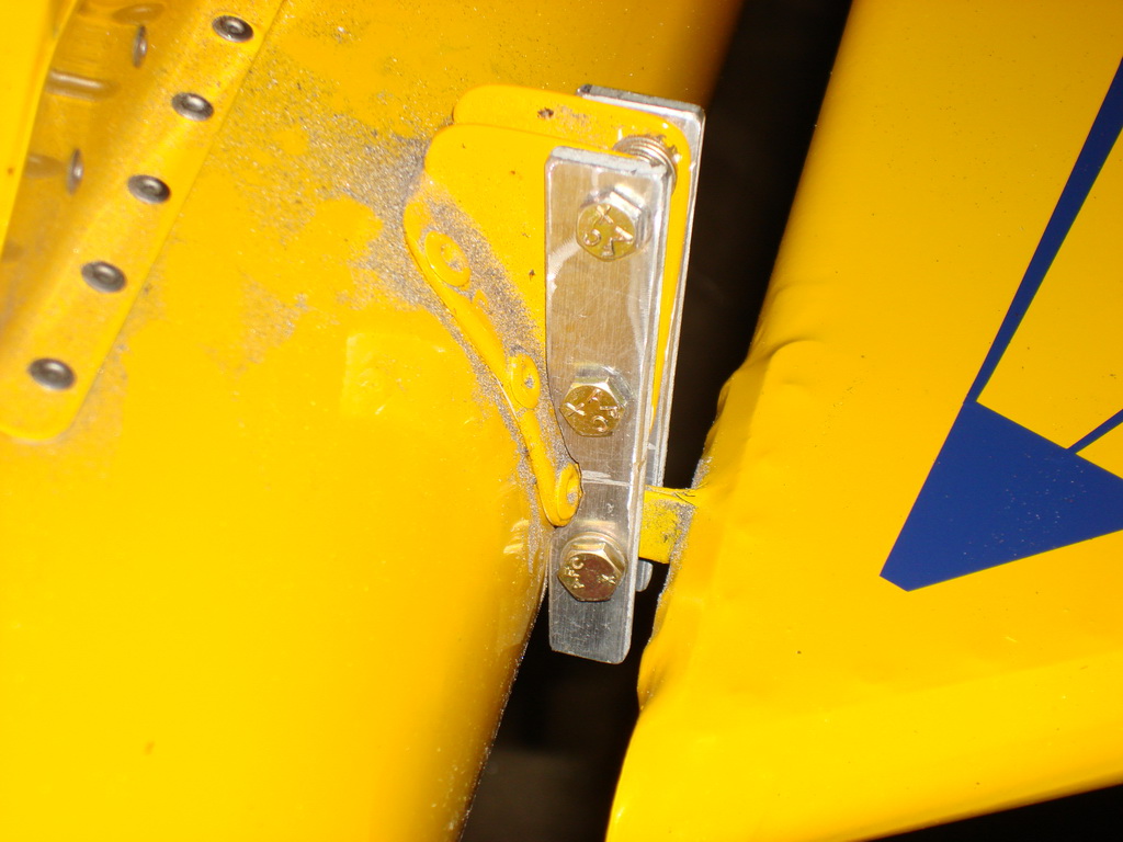

I fell in love with those new wings and droop tips ever since I saw that MK III Xtra at Sun and Fun last year. Increasing wingspan usually improves a planes performance, and from your report it sounds like it is working for the MK III Xtra. I cant wait to hear how it does with the wingtips attached. If your flight tests indicate a major improvement in performance, I will do the work to modify my wings to increase the span and put droop tips on my Kolb.
The one thing I was unsure about were the Aileron cables, how do they feel, any feeling of stiffness, or play, or not being up to the job ?

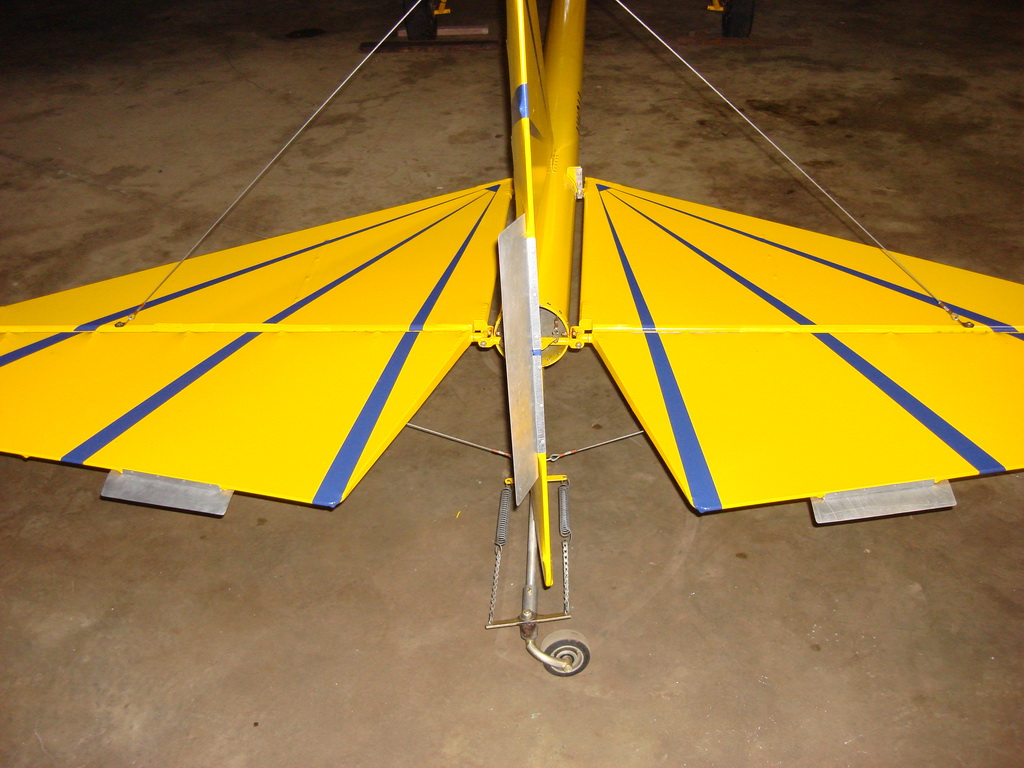

On my MK III Xtra, I had a pitch down trim condition and had to change the incidence on my Horizontal Stabilizer to 7.5 degrees down, almost double of what Kolb specifies. I also had to put trim tabs on with a bit of up trim to spread the load over horizontal stab and elevators evenly. It will now fly great with stock springs. Attached are pictures...
85 MPH cruise is fast ! What RPM are you using to cruise at that speed, and what RPM do you climb out at ??
I am looking forward to your report of how much the wingtips help, and also how the plane handles in calm air.

| Description: |
| Brackets I built to move the leading edge of the Horzontal Stab down to 7.5 degrees and fix trim problem. |

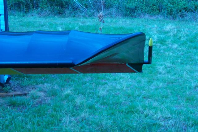

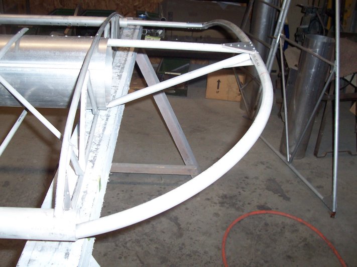

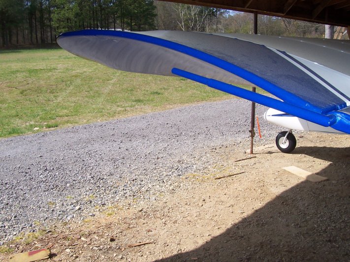

Here is another way to do them so you don't get that
rattle out in the wings tips after 100 hours when the little braces break.
Also carries out the lift to the tips.

Looking at the bracket picture....
You've got Steel brackets....Stainless Steel angle brackets...
Then you make an aluminum connection ??
You've even got the aluminum "Scored" in it's weakest point....?
Gotta Fly...
Mike & "Jaz" in MN

Dad blast it, Possum!! Now, I've got another change to do to my wings, before I cover them!!

In a message dated 3/23/2008 8:31:31 P.M. Eastern Daylight Time,
planecrazzzy(at)yahoo.com writes:
Gotta Fly...
Mike & "Jaz" in MN

I plan on enclosing that area behind the cockpit with aluminum like you did and putting a V back there to get smoother airflow, I already have the materials, just have not had the time to do it. I have full doors on, just like the configuration you are flying right now.
I have tried the Horizontal tail at the 4 degrees, but felt like all the load was on the elevator. My Kolb flew fine both ways, and I did not notice much of a speed change, but I wasn't really looking for that either, so I will have to test fly that again and pay attention to any speed differences.
Splicing an extra two feet of spar on is exactly what I was thinking of doing. The stress on the spar towards the wingtips is minimal, I think a well done splice would be more than strong enough to add just two more feet of spar on each tip. I hope the weather improves for you, I am looking forward to hearing more about how your tests are going.
Mike

| Quote: |
