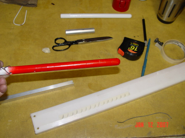

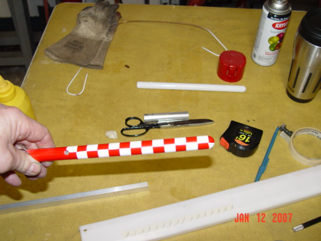

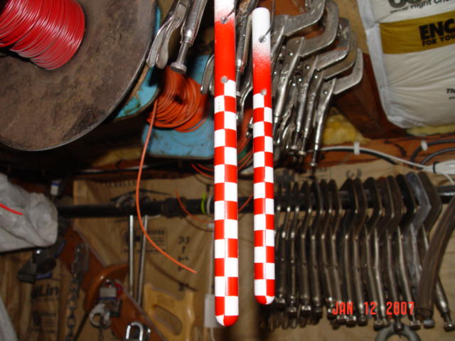

I balanced mine without being connected to the plane....
But later , I extended them about an inch and a half more....
Because when I'd be folding up....The aileron would "hang"
Maybe because of the "angle of the wing" compared to when I balanced
them the first time , the wing was flat...( Level )
ALSO, I adjusted the counter weight "AFTER" fabric and paint.....
Put the "tube" on now....But the balance rod LATER...

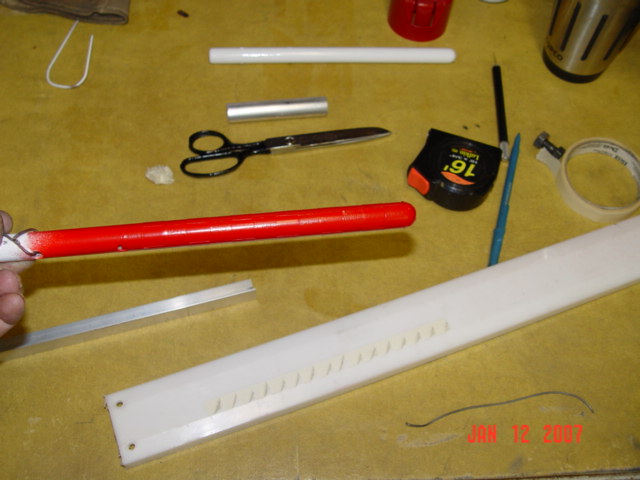

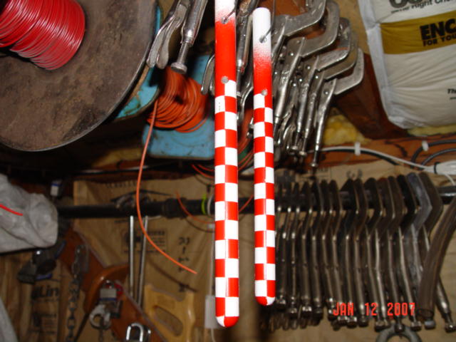

 Filesize:  61.17 KB
 Viewed:  522 Time(s)
 Filesize:  59.98 KB
 Viewed:  526 Time(s)
 Filesize:  59.92 KB
 Viewed:  516 Time(s)

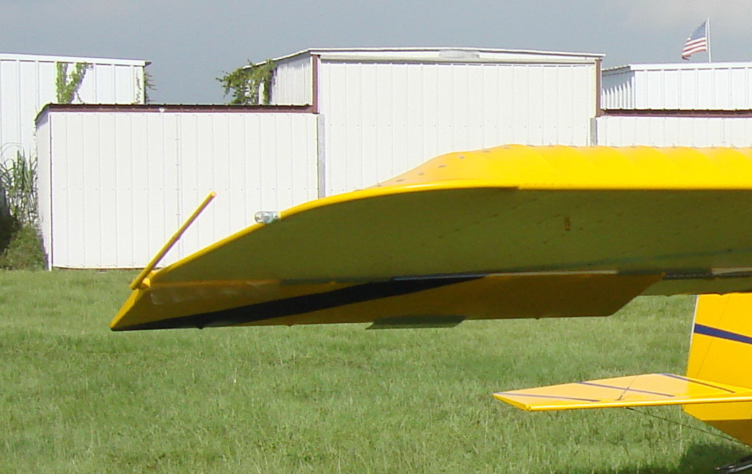

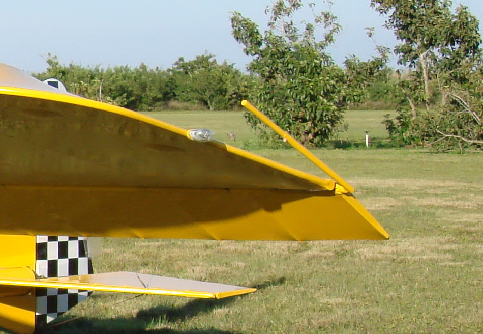

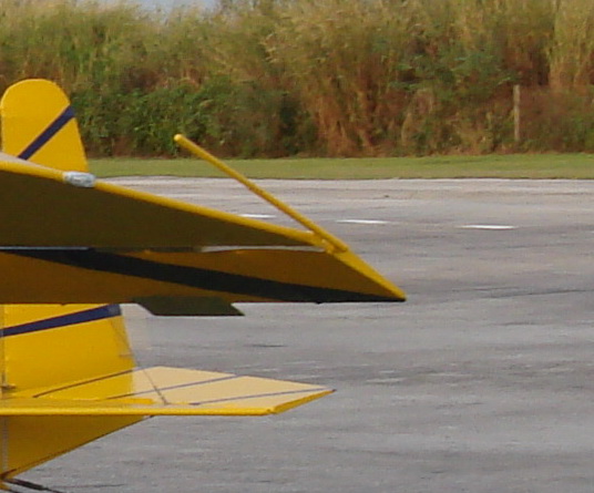

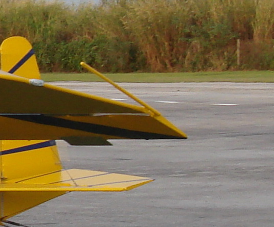

Also attached are some pictures of the aileron counter balances on my plane, as well as a MK III classic. If you need more detailed pictures of how they are attached into the aileron tubes, let me know and I will take some. After reading some reports of minor flutter in the Rudder of some Kolbs, I also counter balanced the rudder in much the same way as ailerons.
