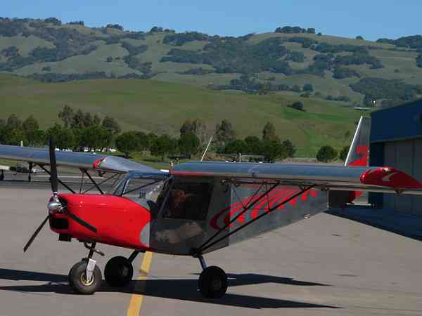

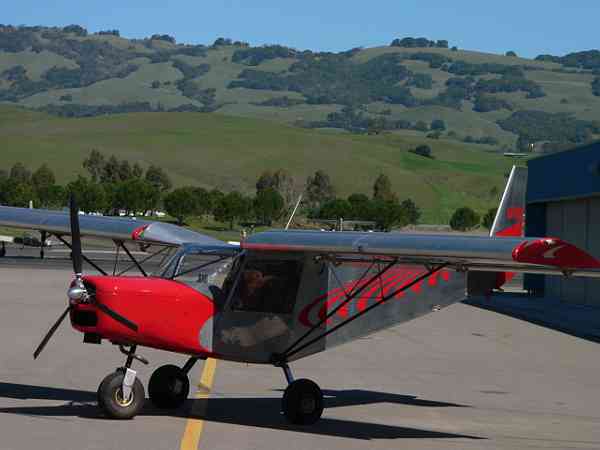

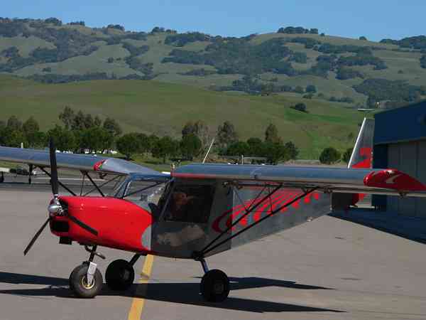

Jack,
The plane is a Zenith CH701 STOL/bush plane with 20 hours on it. I have
attached a picture but don't know if Matronics will post it. Zenith came out
with a better 912 mounting arrangement this year, but I don't want to spend
the bucks and time it would take to install it.
Les

PostPosted: Thu Mar 20, 2008 3:12 pm    Post subject: AW: Re: 912 with low RPM--- new vibration problem-fixed Reply with quote
The picture came through fine. Nice Airplane!!!
