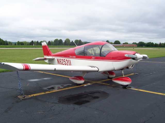

Dave, to what extent can the canopy be changed and still be registered as a 601XL? I'd love to have a Piper Cherokee style canopy, actual hardtop with doors. Or even like the CH2000. The roofline on that basically extends all the way back to the tail instead of a bubble canopy. Otherwise, the fuselage looks a lot like the 601XL.
