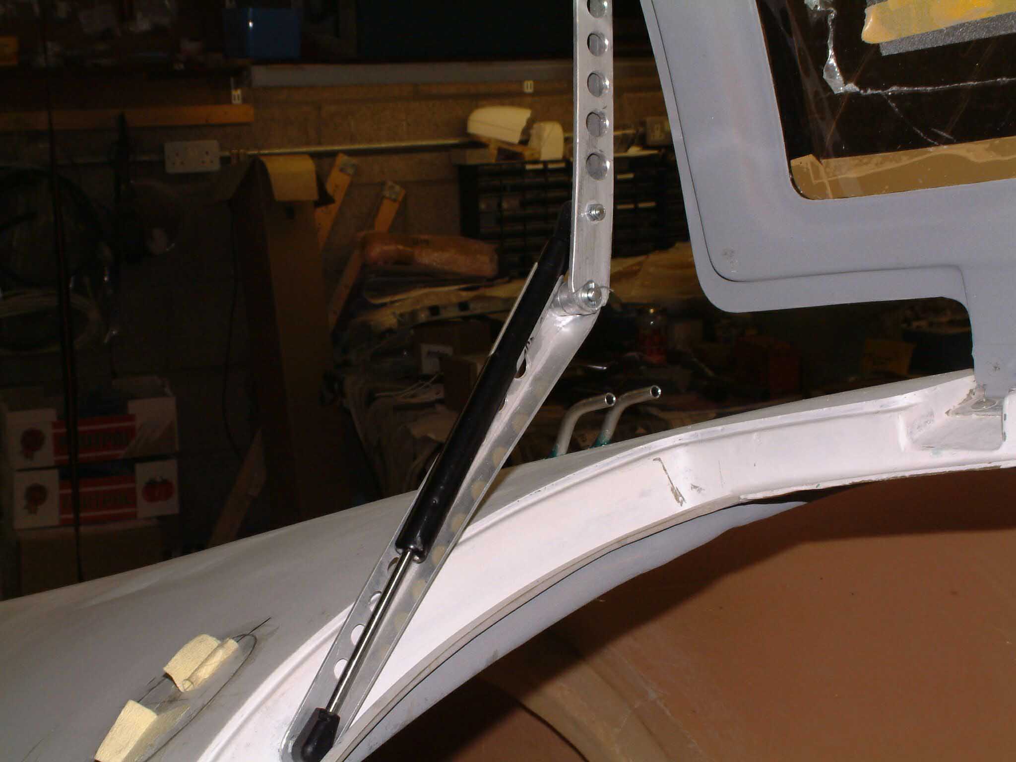

Lesson - make sure you make some provision to prevent the pressure of the
gas strut deforming the door under warm conditions, as happened to mine,
built to original spec's. There are a few ways to do this.

are you aware of Ted Gladstones fix for this? His solution removes the
load from the door and the fuselage, which probably both move.

Graham, Kingsley Hurst has done the same mod to his classic mono
out a Taroom. Last time i was out there it was about 40c and his doors looked perfect. The way he had the pivot points set up for this the strut
seem to be providing a moderate amount of hold down pressure on the door. I believe I will do doing the same mod on mine.

I think Kingsley has Ted's drawings, ask him, it's fairly tricky. Ted
will let you have them I'm sure

Do you know whether or not the Ted Gladstone gas strut mod preceeded
the factory Mod 66, or does it address issues which the factory mod
does not solve?

Ted's is the most elegant design I've seen, pity the factory didn't take
it up, it was offered but Andy was too busy at the time.
The factory mod still strains the door (but lesas) Ted's does not.

And I am happe that I have used Kingsley's drawings to use Ted's mod on my
doors -
but at the rate I am going, it will be a while until I see them work on an
aerodrome!
