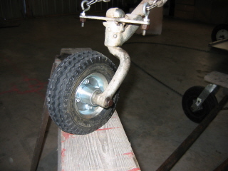

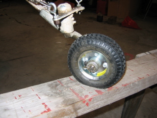

I'm just wondering if those that have had the tailwheel spring break were all running the solid rubber Maule tailwheel. I had that wheel on my Avid MK IV, and you can sure feel every little bump through the fusaloge. I would guess that those sharp jolts fatigue the spring.  Last summer I replaced the wheel with a cheep 6' pneumatic castor wheel and it was much smoother, the tire really soaks up lots of the sharp jolts.  I got some better sealed bearings and put them in the wheel. It would have been nice if Maule made a replacement 6' pneumatic tire but they don't. This worked for me. Jim Chuk Avids  Mn

Thanks for the suggestion on the pneumatic replacement tail wheel. I was looking at my solid one thinking it was a piece of junk for the reasons you state and it is heavy. I will find a pneumatic one to replace it.

I had already changed over from the solid Maule tailwheel to the 6"
"Homebuilders Special Tailwheel" as Spruce calls them. It is a much
softer tire than the Maule, weighs less, and has less contact area
with the ground than the Maule. The bearings that come with the
Spruce wheel are terrible though.
By the way, I like the looks of your pneumatic job, Jim.
Lynn Matteson
Grass Lake, Michigan
flying w/475+ hrs

PostPosted: Tue Mar 11, 2008 10:34 am    Post subject: Sprung Tailwheel Reply with quote
I agree with Paul on his comments below, to a point. I've been involved with Kitfoxes since about 1990 and have witnessed not only my own spring breaking, but have heard the complaints of many list members who have suffered the same problems, often with much collateral damage. Mine bent the rudder, but I was able to repair it without much of a problem. However, I tend to differ with Paul's statement below that the springs are too light. My experience with spring steel indicates that there are two things that make a good tail wheel spring. The proper steel and proper heat treating. Both are very important. I had a Piper Vagabond that was 50 years old and the spring set was still intact. I replaced it not because it broke, but because it had flattened out to the point that the tail wheel kingpin was no longer vertical and I was getting a lot of shimmy. My opinion is that the tail wheel springs sold by Denny and Skystar just were not manufactured to the correct specifications for the job. Way too many of them broke to be blaming it on over use. My model 2 was only about 500 lbs and the spring was plenty strong enough. It just wasn't manufactured correctly.
My opinion is worth what you paid for it.

Lynn Matteson
Posts: 2778
PostPosted: Tue Mar 11, 2008 6:56 pm    Post subject: Sprung Tailwheel Reply with quote
That's the one. Yes, get the longlife bearings from them or from a
local bearing dealer, as the one's shipped with the wheel are poor
quality...A word of warning....the description says "bearings" but
that means one bearing, and you will need to order two, unless
they've changed their tune since I ordered mine. You'll have to make
a sleeve for the bearings to fit the Maule axle. I used a length of
4130 tubing, Spruce part number 03-03900, which will have to be
polished a few thousandths (mine did anyway) to fit the bearings. I'm
pretty sure that the bore of this tubing fit the axle just right.
> Lynn Matteson
> Kitfox IV Speedster w/Jabiru 2200
> flying w/475+ hrs
really
> > worked for me. Jim======

Lynn, Is that tailwheel soft rubber or actually a pneumatic wheel?  As far as the bearings go, I would bet that it wouldn't be to hard to find bearings that fit the wheel and have a 1/2" center so it would fit the Maule axle. Thanks, Jim Chuk Avids MN
