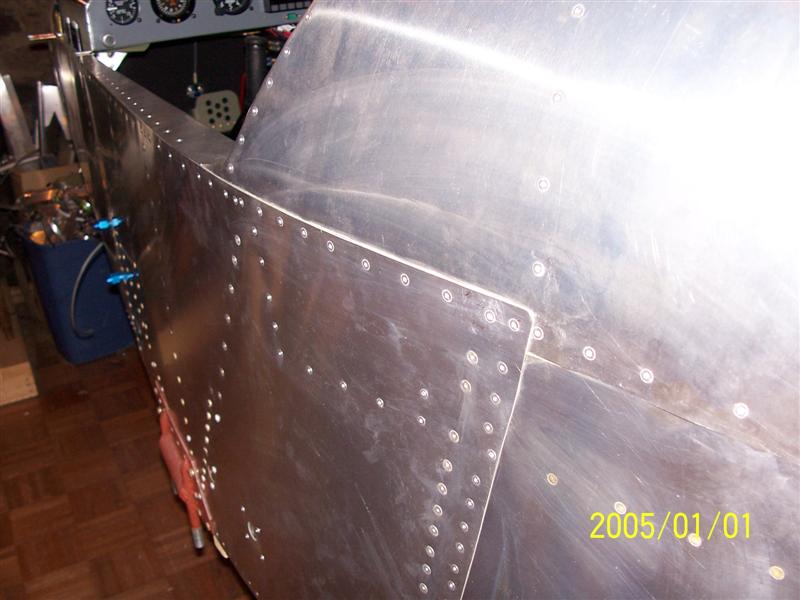

Posted: Tue Mar 11, 2008 4:00 pm Post subject: Re: Skins |
The top overlaps the side skins, but tucks under the cabin side skins. Leave a large area of the cabin side skins clecoed until you are ready to tuck the top skin under.
I'm pretty sure I've got this correct according to the plans (at least the version I purchased).
Dan

Posted: Tue Mar 11, 2008 4:03 pm Post subject: Re: Skins |
By the way ignore the date on the photo. I took it a week ago. The battery on my camera died and reset the date.
