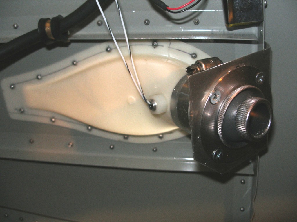

I mounted mine in the right air inlet.
Jay in Dallas 601XL N2630J "Lil Bruiser"

amyvega2005(at)earthlink.
PostPosted: Sat Mar 08, 2008 5:47 am    Post subject: Dynon's OAT sensor Reply with quote
My Dynon OAT is mounted on the passenger side NACA Vent, so it is out of the way of getting bumped by debries and people. the air path is neutral and not warmed by exhaust.
Juan
