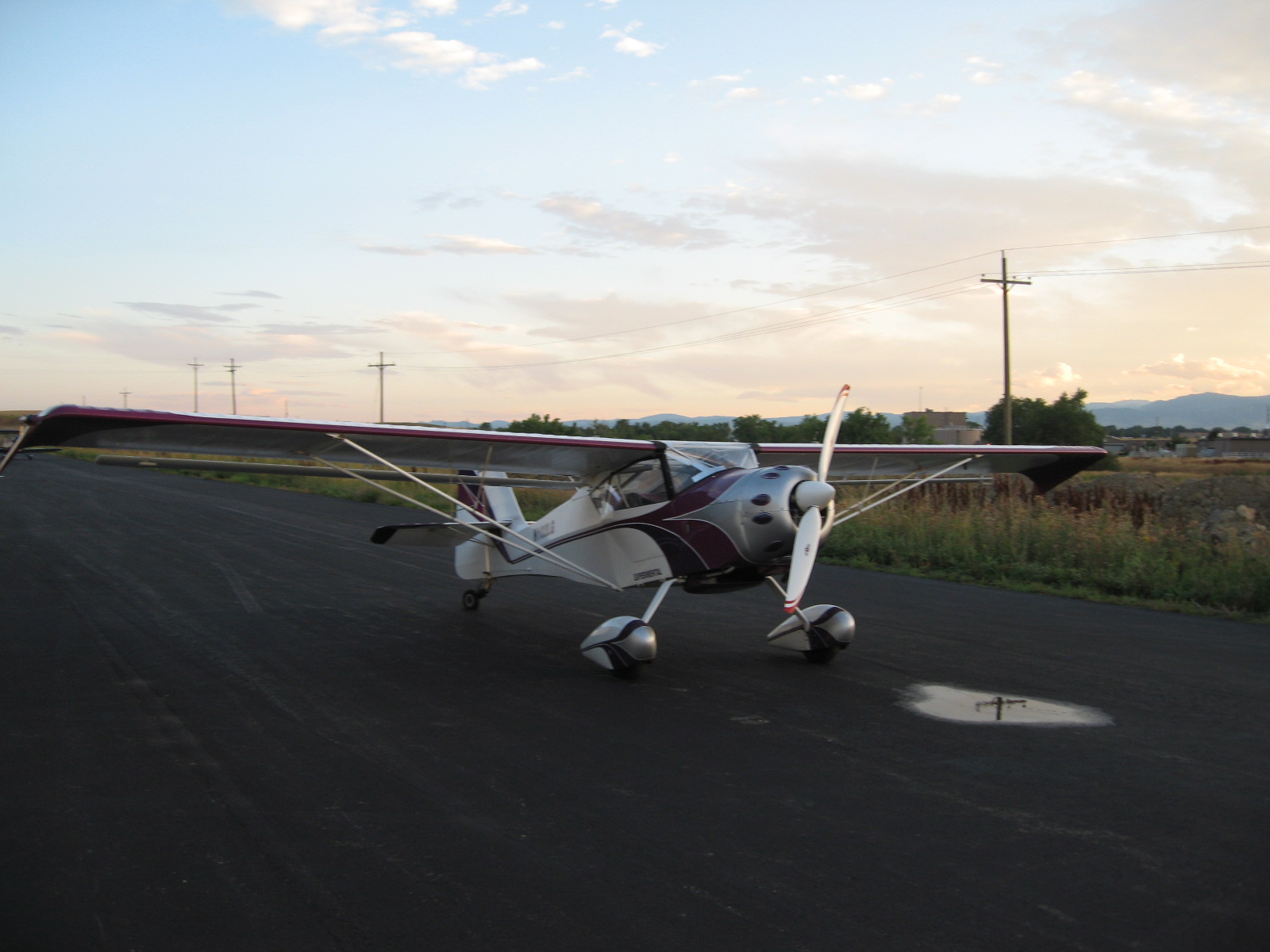

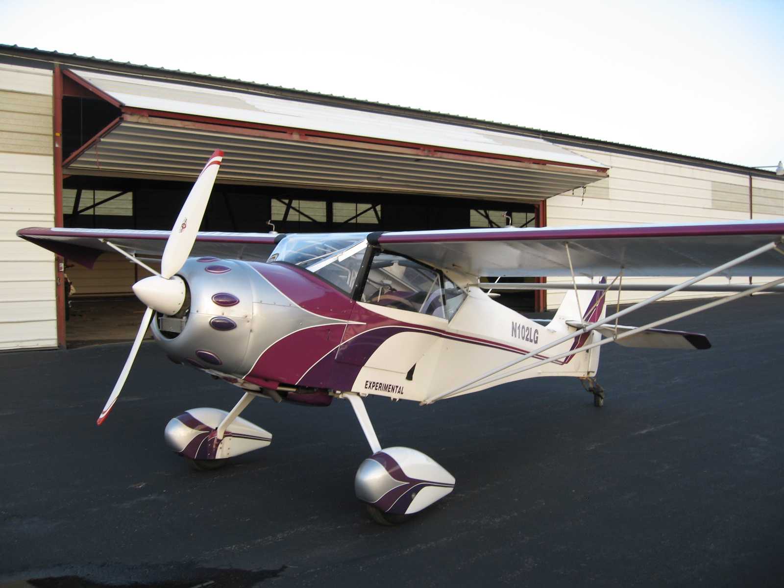

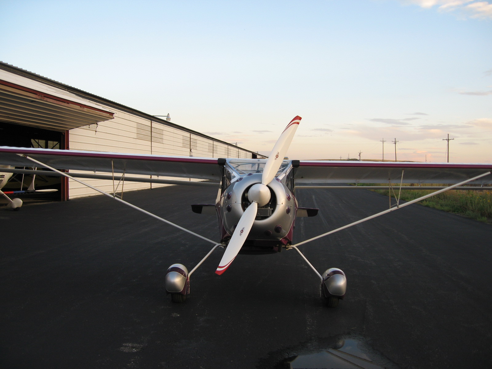

I have the Sensenich GA with the nickel leading edge protection. I love it, it has great thrust on t/o, incredibly easy to adjust (you can fly x/c take a screwdriver and a wrench with you and adjust it on the ramp in minutes if you want to go faster or climb better), great protection (bird strike did nothing to the prop but broke my windshield) and I get a lot of compliments on how cool it looks with the round cowling.
