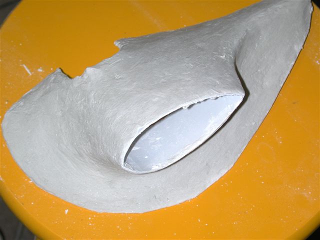

<<DSCN1907.JPG>> <<DSCN1893.JPG>> <<DSCN1894.JPG>>
<<DSCN1900.JPG>> <<DSCN1902.JPG>> <<DSCN1904.JPG>>
<<DSCN1906.JPG>>

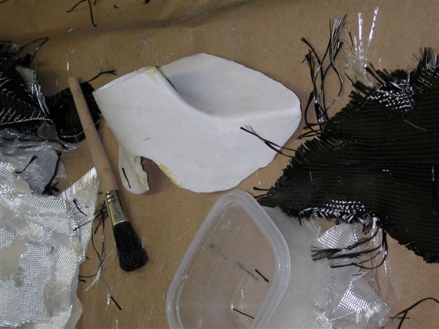

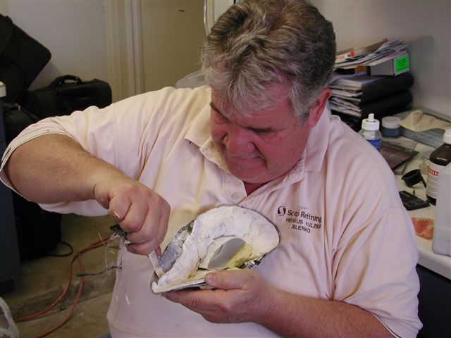

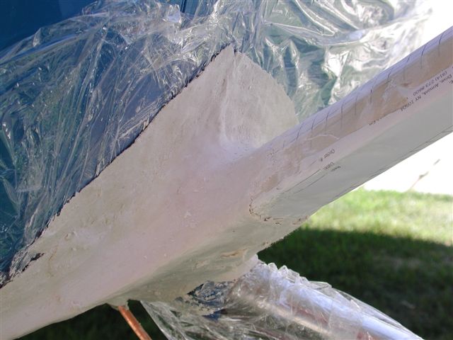

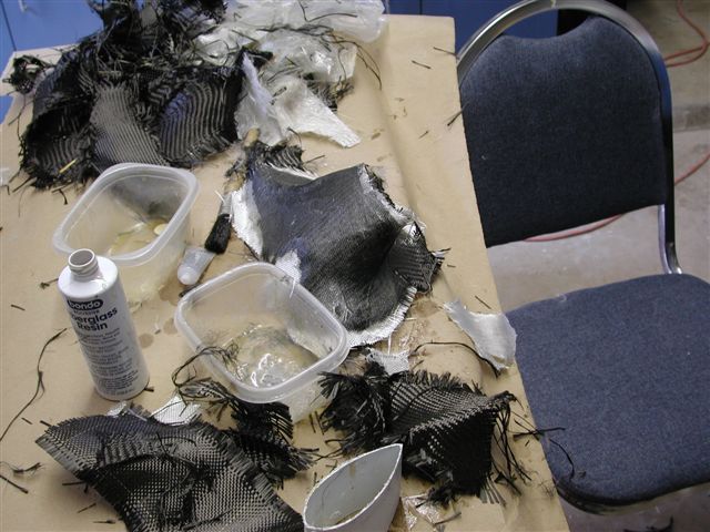

I do use dry wall plaster in making lost mold techniques along with
paper..on this mold I used gauze and it worked out very well.. I also
use clay to do little fixes-- after the plaster is shaped to the final
contours and ready for composite I seal the surface with a dental
separator used to make dentures and then the residual plaster can easily
be rinsed away with water. After the part is removed from the plaster
and trimmed the surface is smoothed and prepared for paint.

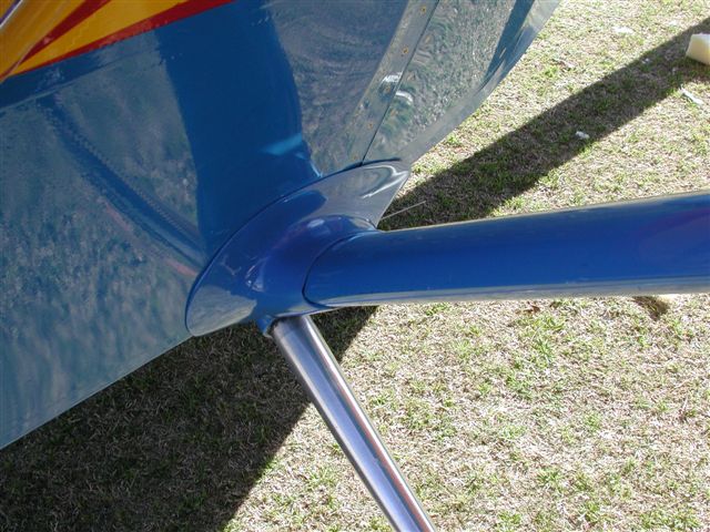

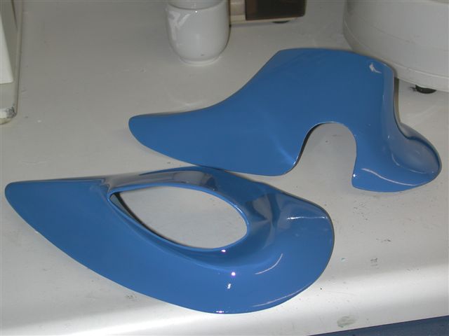

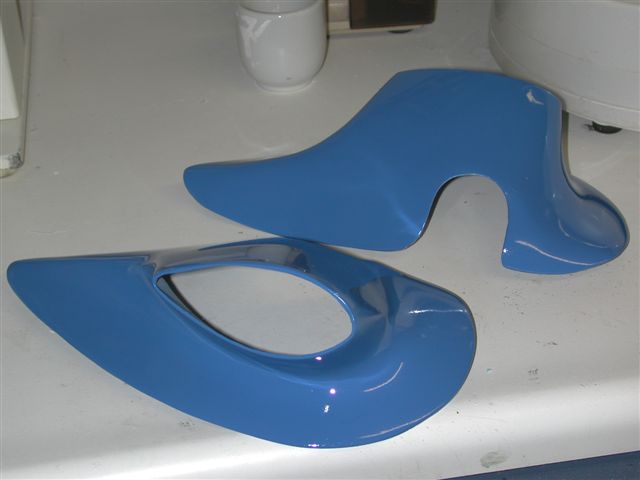

<<DSCN1909.JPG>> In a few hours from start to finish custom farings
Uncle craig

ElleryWeld(at)aol.com Guest
Posted: Wed Mar 05, 2008 5:48 pm Post subject: Lost mold |
Uncle Craig that's not the color I wanted ......Just Kidding they look like every thing else you make Like Factory

Bill Vincent
Joined: 30 Jan 2006 Posts: 84
Posted: Wed Mar 05, 2008 5:57 pm Post subject: Lost mold |
wow! It looks great

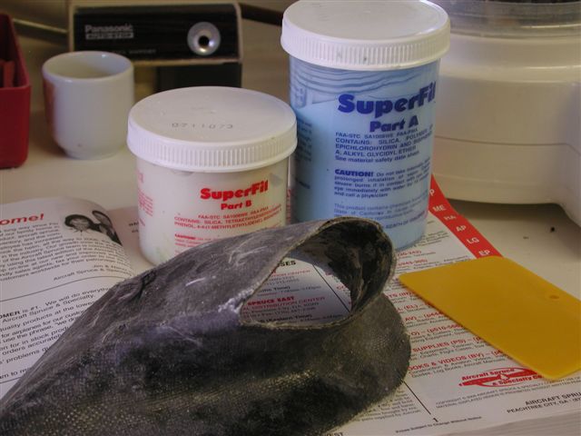

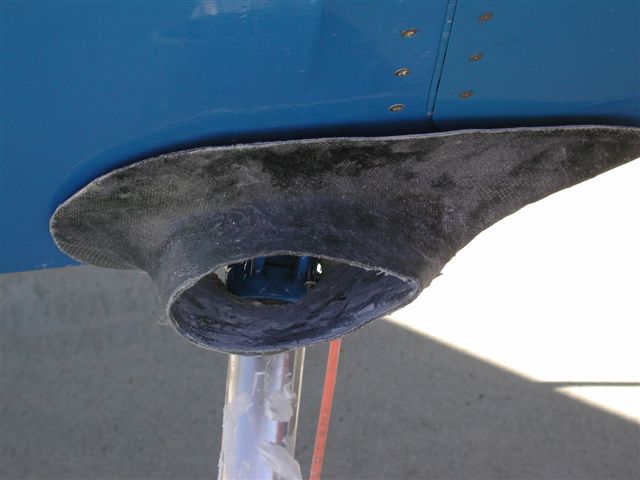

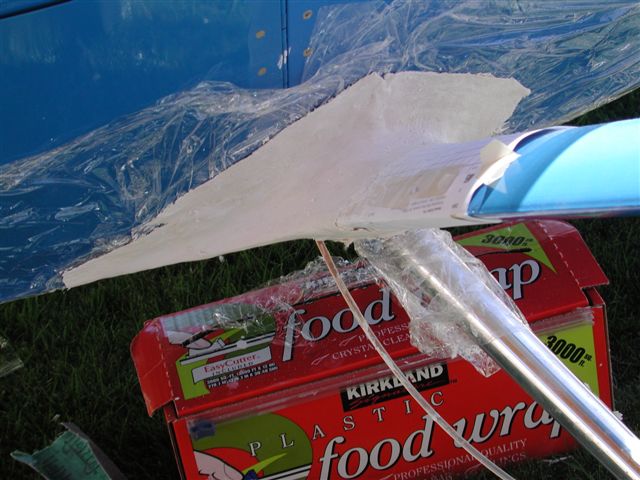

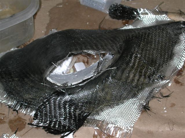

craig.nelson(at)heraeus.c Guest
Posted: Thu Mar 06, 2008 11:32 am Post subject: Lost mold |
<<DSCN1915.JPG>> <<DSCN1890.JPG>> <<DSCN1891.JPG>>
<<DSCN1892.JPG>> <<DSCN1913.JPG>> <<DSCN1914.JPG>>

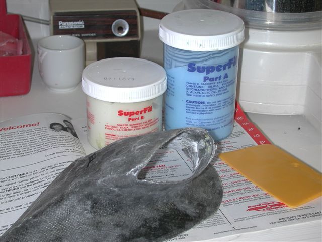

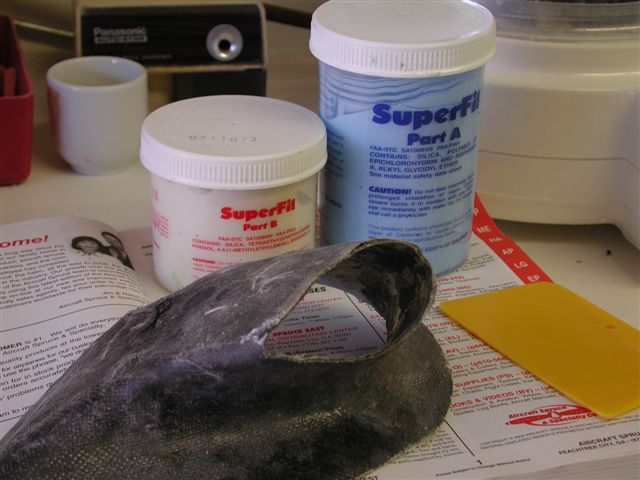

.Lost mold means just that. The mold is lost when the part is made. I
make a positive mold out of tape to get the basic shape then the plaster
is used to make the mold strong enough to remove from the plane.. More
plaster is used to get the proper contour of the part .. Then I apply
separator to the plaster called Aislar a dental denture material in
dentistry it is call tin foil substitute used to fill the pours plaster
so acrylic does not stick to it. Then I wax the plaster form and apply
the layers of glass and resin, when this sets up I remove the part from
the mold. The plaster brakes up on removal because it is not strong
enough to stay in one piece when removing the part.( lost mold it is
only good for one part) Then I fill the weave of the cloth with filler
and paint it
Uncle craig

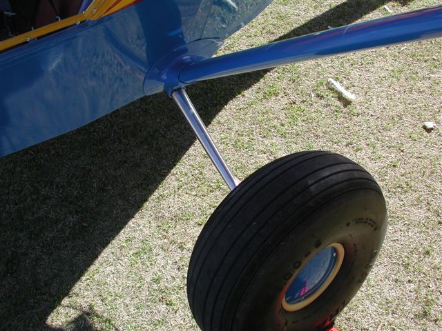

MKIIIX040
Joined: 31 Mar 2006 Posts: 123 Location: Millinocket, Maine
Posted: Fri Mar 07, 2008 8:00 am Post subject: Lost Mold |

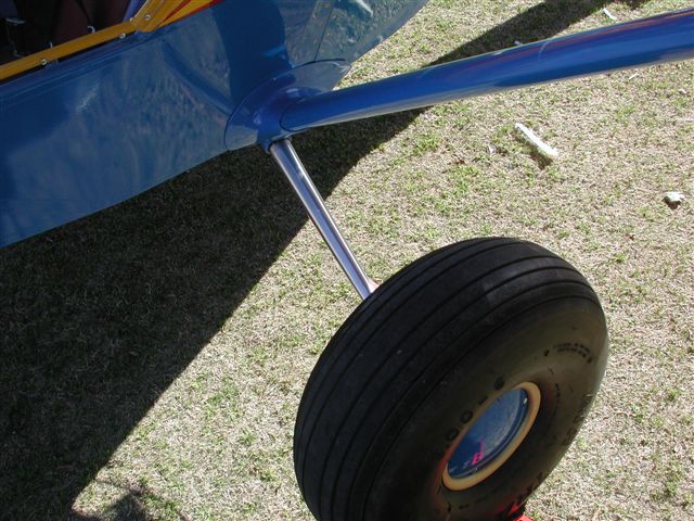

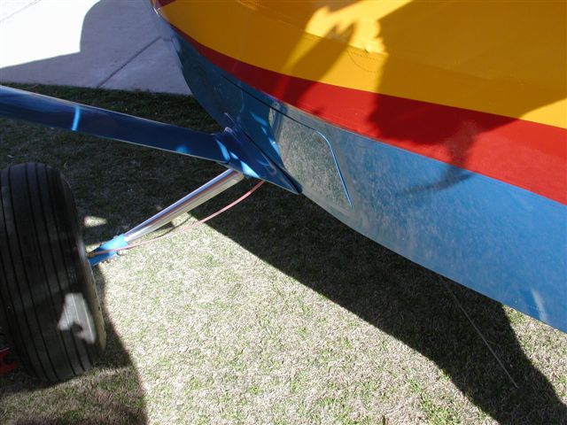

Mike, Stupid Question # 2
Would the finished fairing have a larger ID than the plaster mold (1st build up)?
Seems like you would have to extend the finished fairing out beyond the edges so it would meet the strut cover or whatever it contacts. How is that done if your doing a layup inside your mold?
Note: 10 layers of glass mat ( video), if I used that much my part would weigh 100 lbs. and be an inch thick.
Vic
N740VP
If you can still see out your house windows you didn't shovel as fast as you could have.
_________________ MKIIIX040
912UL |
| Back to top |
mdnanwelch7(at)hotmail.co Guest
Posted: Fri Mar 07, 2008 9:15 am Post subject: Lost Mold |
Hi Vic,
Again, nice observation. If you shaped a perfect fairing (on your plane), and you took a mold off that perfect fairing, and then you built your part on the inside of that mold, your finished part (fairing) would be slightly smaller, not larger.
With this understanding, that your part will be slightly smaller (by the width of you glass layers) you may want to build up your sculpted prototype, with extra tape, etc.
This is especially important if you are building something that has an opening, like our fairing. Our fairing has two area of interest...the part that fastens to the fuselage. A tiny bit smaller, or bigger would never be noticed. But the part that has a hole, that slips up the wing strut, won't fit unless you've made that opening a little oversize". No doubt, Uncle Craig allowed for this.
I know it seems to get a little confusing, but if you take into consideration that male, female, male, undersize, oversize, etc., etc. changes, it really isn't hard.
Example, if I were to make that exact same part as Uncle Craig made, I would wrap the wing strut with...oh, about 3 layers of duct tape, since duct tape is "close" to the thickness of fiberglass cloth. 3 layers of tape gives you room for 3 layers of glass. So, now, when you build a mold around that wing strut, the hole in your mold will be oversize. Right? Therefore, when you start putting in the layers of fiberglass, or carbon fiber, inside your mold....you will be closing in on that original wing strut diameter (prior to the duct tape).
The portion of the mold near the fuselage doesn't matter if it's 1/6"-3/32" smaller, you'd never know. But the part of your fairing that needs to slide up and down the wing strut won't fit, unless you accomodate for it.
The video of mold making was just that....only the mold. That's why the 10 layers. He was making a mold, not the finished part. With this mold he made, he can now apply plenty of mold wax, then gel-coat, and then 3-4 layers of cloth (whether it is carbon fiber, E glass, S glass, etc.) Because his mold is 10 layers thick of fiberglass, it should last for years, and hundreds of "take-offs".
Mike Welch
