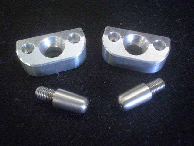

Mike Howe and I just installed the after market Rivethead door pin guide set. We didn’t receive any info on the installation from Rivethead. We used the plastic ones supplied by Van’s to mark the holes in the frame. The new guides didn’t line up exactly with Van’s. We had to do some drilling/sanding of the guide to get the pins to fit. Once modified they seem to hold the door very tight. We don’t know how the weather stripping will affect the fit. We’re miles away from that part of the finishing. I hope this helped some.

Posted: Mon Mar 03, 2008 12:38 pm Post subject: Rivethead Door Guide and Pin set |
One of the problems i found was the way they mounted from the backside which made it difficult to mount and adjust. i made a similar part but made it screw in from the front. i fabbed a backplate with platenuts and ovaled out the holes in the doorframe to allow future adjustments.
