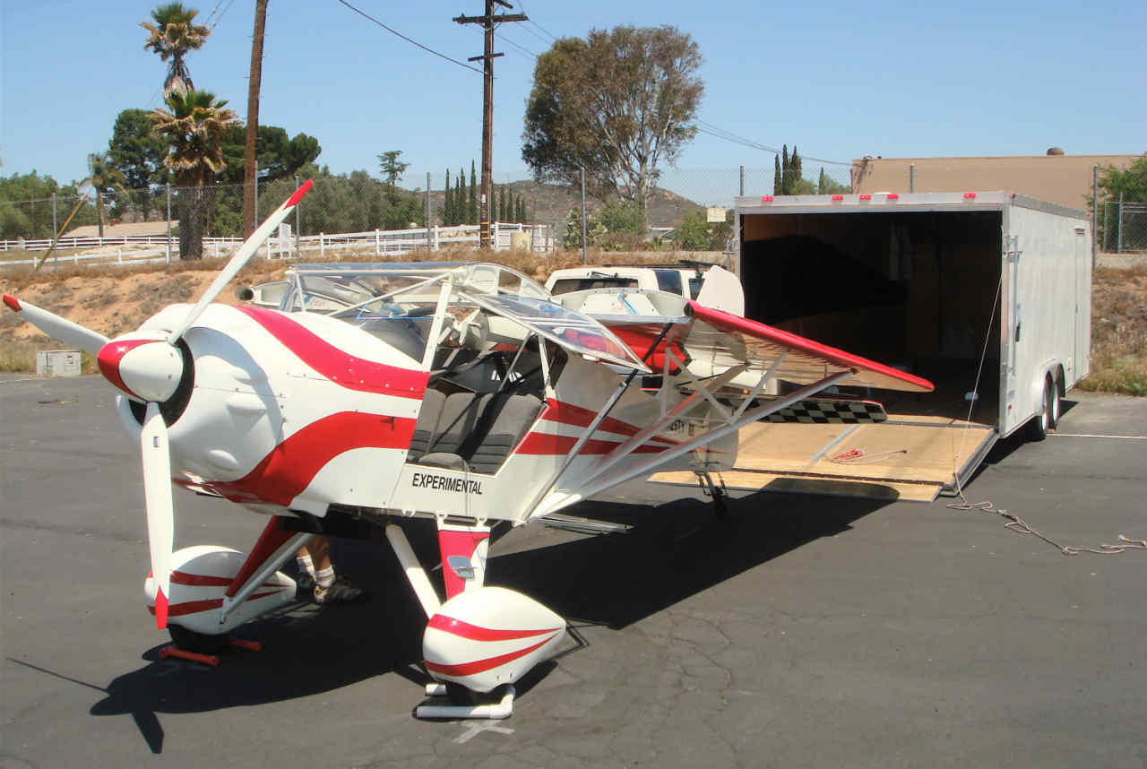

Here's where my Kitfox IV lives. Out West we call them "toy
boxes" because they're made to haul dune buggies and the like. My Fox
fits with 1/2" to spare either side of the wings. It takes me seven
minutes to set up or tear down, but I designed for it. I pay for a
tie down so if I can get two more Foxes and boxes I'll get my monthly
down to $36.
I highly recommend it. Oh, and I have no problems with
condensation because the trailer walls are all vented out the bottom.
Also I have a couple of solar fans in the roof, and a solar panel
charger for my battery. The trailer cost $6600. (I didn't mind
because it's very marketable used.)
Guy Buchanan
San Diego, CA

It's 22' x 7000# gross. The Fox fits with just inches to
spare. 24' would be better because then you'd have space for cabinets
and things at the end, but it bumped me up to 10k# gross and was just
too heavy for me to deal with. As it is I have plenty of storage
above and below the wings, I just have to be careful that anything
above can't come down in an earthquake or something like that.
Guy Buchanan
San Diego, CA

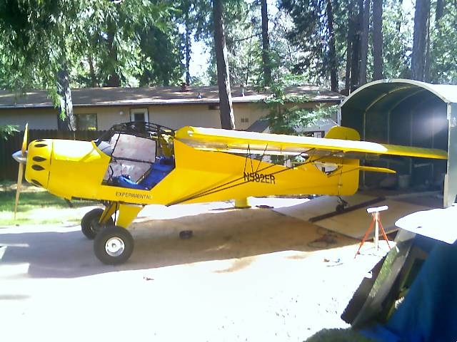

These are some pics of my trailer built from a tandem boat trailer it's 8'6" wide 22' long made from EMT welded together with sheet metal has the hand wench if needed to pull it in cost was $1100 makes a great hanger for here in North Cal.still needs carpet and paint
Jerry Evans
96% done 582
Magalia Calif.
N582'er'
kitfox 555

| Quote: | has the hand wench if needed to pull it in
That's very cool, but does your wife know about her?
| Quote: | cost was $1100 makes a great hanger for here in North Cal.still
Seriously Jerry, that's way better than mine, which cost $6600 to
buy. What do you think yours weighs? I wonder, if you put plans
together, and John found a fabricator, what it would cost to build and market?

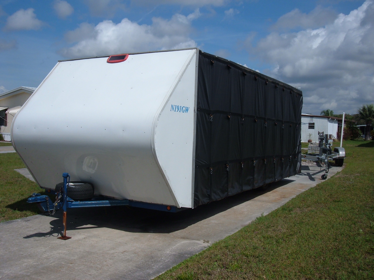

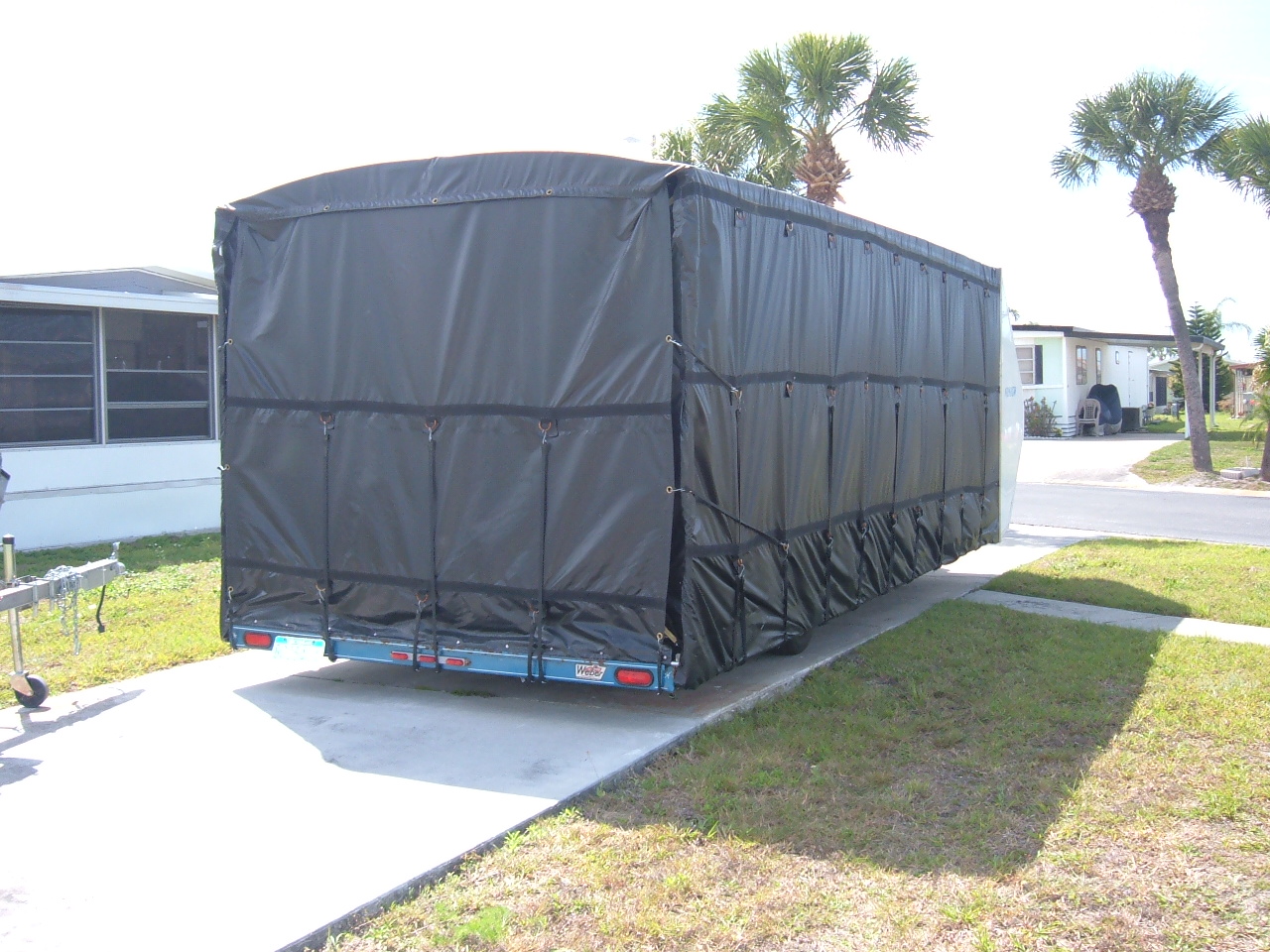

here are a few pics of mine. I did the emt framework, and covered it with a truckers tarp. the nose is fiberglass that they cover motorhomes with. the tail wheel goes up a ramp, and the wing tips fit nicely into the nose of the trailer.
Call me if you have any questions about hauling it. I've gone about 2500 miles so far, and had no issues.
Louie (989)387-4662

Pat that is the limit here 8'6" according to the CHP
patrick reilly <patreilly43(at)hotmail.com> wrote: [quote] .hmmessage P { margin:0px; padding:0px } body.hmmessage { FONT-SIZE: 10pt; FONT-FAMILY:Tahoma } Jerry, What is max trailer width allowed in CA? It is 8' here in IL. You stated your trailer is 8'-6" wide.

[quote] Date: Mon, 25 Feb 2008 21:48:17 -0800
From: kitfox555(at)sbcglobal.net
Subject: enclosed trailers
These are some pics of my trailer built from a tandem boat trailer it's 8'6" wide 22' long made from EMT welded together with sheet metal has the hand wench if needed to pull it in cost was $1100 makes a great hanger for here in North [quote][b]
| Back to top |

Jerry, I guess I stand corrected. Another e-mail said the legal limit is 8'-6" width for over the road nation wide.
