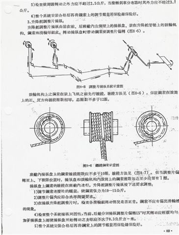

PostPosted: Mon Feb 25, 2008 7:43 pm    Post subject: Emailing: CJ6 TRIM SCHEMATIC Reply with quote
From the Chinese repair manual
Joe.
