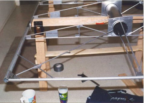

WillUribe(at)aol.com Guest
Posted: Tue Feb 26, 2008 10:43 am Post subject: bow tip diagonal braces (was structural failure) |
Hi Ben,
My plans didn't call for tie-wraps, here is a picture of my braces.
Will Uribe
El Paso, TX
FireStar II N4GU
http://members.aol.com/firestartwo/Kit1.html
