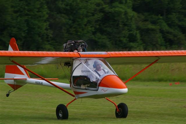

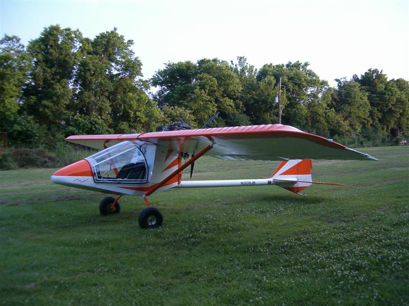

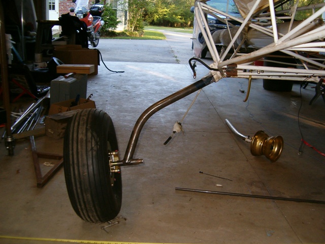

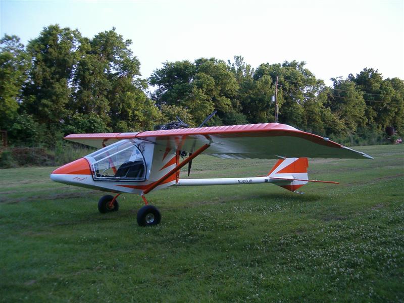

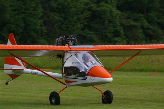

This is how I did it. Not saying this is the best, but works great for me.
My approach was similar the factory method with a few tweaks recommended by John H and his brother Jim. Used existing gear sockets and did not make mods to move forward like on Miss P'fer.
As John H said and recommended:
1.375 x .120 wall 4130
All welding, fitting, aligning, drilling done prior to heat treating to RC48. Really hard to drill once heat treated. They heat treater will tell you that the tubes will distort some. Not enough to matter in my opinion.
My axle sockets are 1.00 x .120 wall for the bigger, better 3/4" Matco W62 axles with tapered bearings. These axles are heavy duty and have a lot more brake pad surface area. Braking is much improved. I know some guys that can land with their wheels locked on a grass strip to make sure they win a shortest landing contest with these brakes. Wink
The other thing is 800-6.0 tires. Between the Heat treated still legs and the larger tires, the cushion and energy absorbed on landing is great. I really had trouble knowing when I was down and rolling when I first used the new setup. You have to experiment with the air pressure a bit. Too much air pressure will throw you back into the air.
John H. and Brother Jim recommended I put in 7 degrees of positive camber on the axles. If you notice a few of the folks with the factory legs have the Kolb gear squat after a few tough landings. This was true for the original factory steel gear. Maybe they have improved this with a little positive camber now. I put in the 7 degrees + camber and thought I would field adjust a lot of that out with some hard landings and end up close to zero camber. Hasn't happened yet. Somewhere between 5 and 7 degrees would be right. I have a CUB like pigeon toe look gear unloaded and airborne. Hope I got this positive/negative camber thing right. see picture
