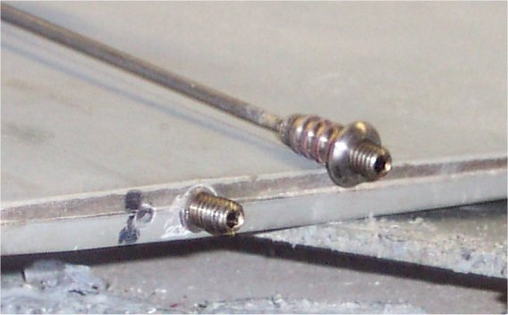

I understand your desire to make the result esthetic and that is one of our prime goals with Carbinge. That is where the Carbinge Keepers come in. With this product you have a drop dead simple method of removal and replacement and you have only one small hole at the point of each pin placement. The hole is about 3/16” in diameter and the head of the allen screw can pretty much sit flush with this hole. (see photo of Keeper installed in a wing tip)
