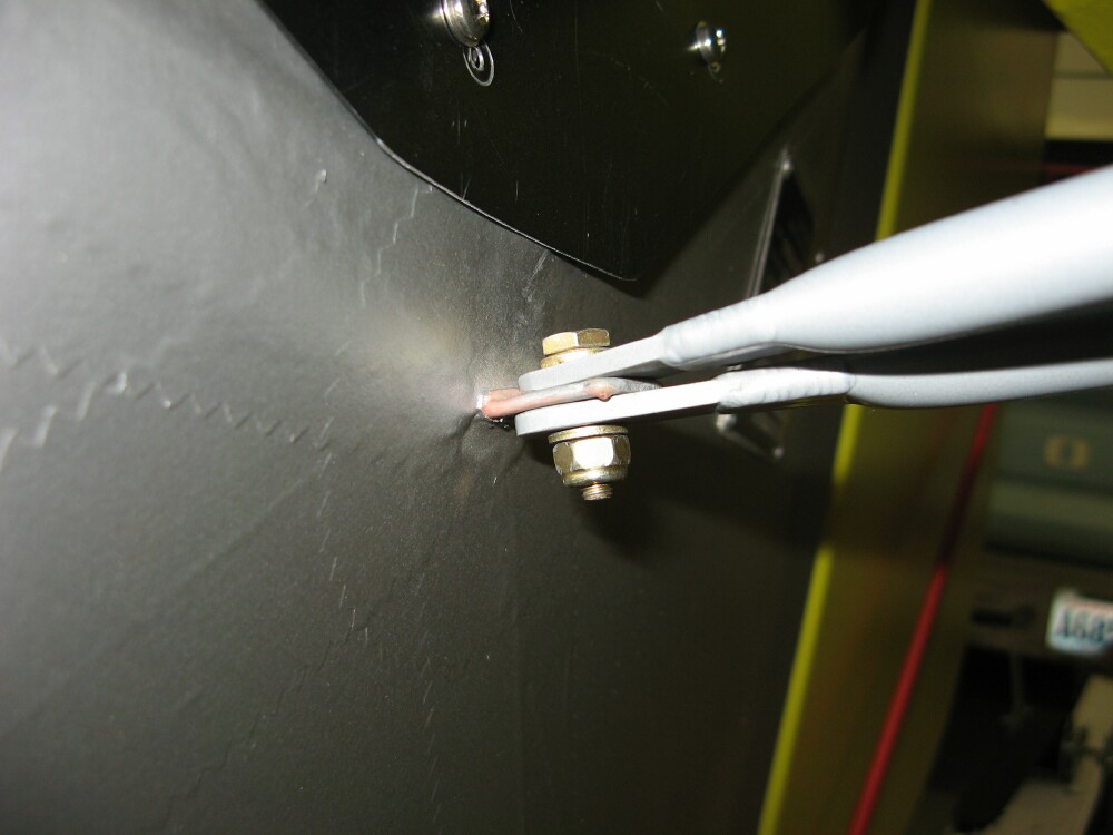

PostPosted: Sun Feb 17, 2008 12:20 pm    Post subject: Re: horizontal stabilizer Reply with quote
I attached the rod ends to the horizontal stabilizer but when I tried to attach the struts to the fuseledge tab the rounded portions of the struts touched preventing the flattened areas to go together. I suppose I could add washers to fix this problem but I would think the flattened areas of the struts should go together and touch the tab.
Any suggestions?
Mike, the front strut goes on top of the fuselage tab and the rear strut goes on the bottom of the fuselage tab. Mine do not touch each other but if they did I would install washer(s) for clearance. You may need to use a longer bolt if you need the extra washers.
Also, the single piece V struts were the original struts. The modifications are the Two piece for each side (4 total) with two rod ends on each side for the outboard ends (front and rear).
Picture of inboard ends attached.
 Filesize:  90.46 KB
 Viewed:  848 Time(s)
Tom Jones
Classic IV
Ellensburg, WA

Nice picture, Tom...it looks like you had to lower your horizontal
stab, eh? (I've got the same "extra" holes in my fairing too.) : )
bottom strut goes on the bottom of the fuselage tab. Mine do not
washers.

Tom Jones

If you decide to change out the rod end, it makes little sense to
put another rod of larger size in its place. Just add a flattend
tube as all the adjustments that you needed for first flights etc
are finshed. Clint

> I think you'll find that the original rod end was 3/16"...not
> 1/8"...at least mine was. No matter. What I was told was to replace
> the 3/16" threaded end of the strut with a 1/4" threaded end, and
use
> a suitable rod end bearing on that new threaded end. What I did was
> to buy AN490 threaded rod ends...at least that's what Aircraft
Spruce
> calls them. I was at Sun 'n' Fun and happened to find what I thought
> I would need at one of the vendors there. I didn't know what size I
> would need, as I hadn't cut the original strut open yet, so I bought
> two each of three sizes. It turned out that the size I needed was
the
> one for use with 3/8" tubing of .035" wall thickness. Spruce calls
> this part # AN490HT6P, and describes it as "used with tube size" ...
> 3/8"x .035" At $11.30 each, they aren't cheap...page 137 of the new
> catalog. Then you'll have to find a rod end bearing of 1/4"-28
> threaded female shank, with a .190" bore...or 3/16"...this is for
> the #10 mounting bolt.
> I just looked at the ends that I had cut off from my original
struts,
> and looking into the tubing I saw something that rather shocked
> me...Skystar had used a socket head cap screw welded into the end of
> the tubing instead of the proper AN490 threaded rod end. I suppose
> this might be OK, but the AN490 has a MUCH longer area that goes
into
> the tube and therefore makes for a much more secure welded
connection.
> I looked at my plane yesterday, and the original (at least on my
> plane) has the smaller diameter tube...3/8"...on the front, with the
> threaded rod end bearing on it, and a larger diameter tube...didn't
> measure it...on the rear. The rear tube is flat on both ends, and
the
> front tube intersects it at an angle, and is welded to it, near
where
> it attaches to the fuselage tab.
