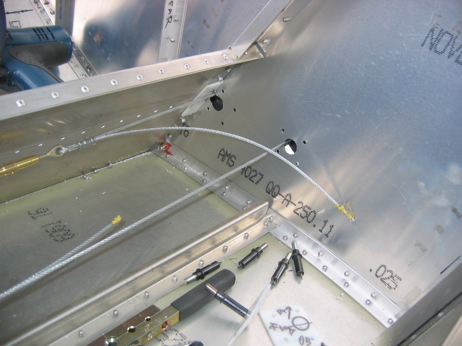

DaveG601XL
Joined: 27 Oct 2006 Posts: 351 Location: Cincinnati, Oh
Posted: Wed Feb 06, 2008 10:01 am Post subject: Re: XL Aileron balance cable instalation |
Chris,
I am not flying yet either, but I have had the wings on and all control cables attached. I drilled my aileron fairlead holes per the drawing 6-B-22 dated 02/05. The balance cable hole ended up not being as close to 6-B-5 as shown on the drawing so I did elongate my hole a bit to move the cable further forward. I probably could have left it as originally cut. Here is a picture of the right side without the side skin fairleads in place.
Good luck,
