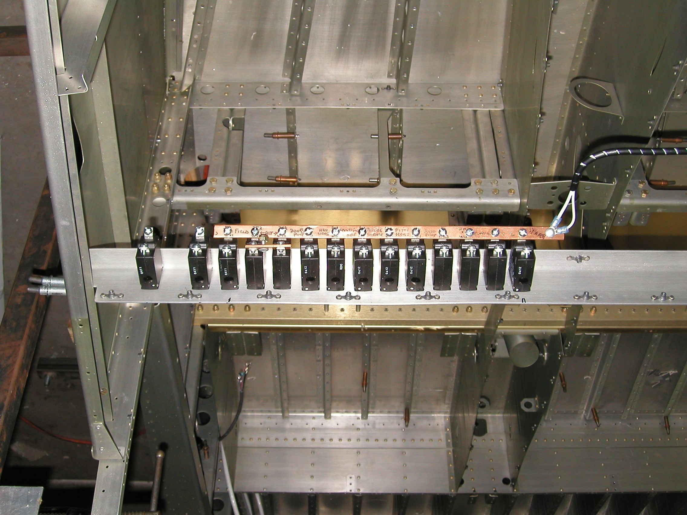

two 30 or 35s in parallel with a short copper bus bar between them. Easy
attach of the fat wire.
 Filesize:  695.38 KB
 Viewed:  706 Time(s)

On Jan 31, 2008 5:40 PM, William Curtis <wcurtis(at)nerv10.com (wcurtis(at)nerv10.com)> wrote:
[quote] --> RV10-List message posted by: "William Curtis" <wcurtis(at)nerv10.com (wcurtis(at)nerv10.com)>
If all the "heavy" wiring is on the engine side, how do you get the 60 amps from the alternator to the buss? That's rhetorical.
I think I know what you are saying because I see a lot of builders connect the output lead of the alternator to the battery side of the starter contactor thinking they are keeping the "heavy" wires out of the cockpit. You still need to run a "heavy" wire from the battery cable to the main buss. So unless you buss is also forward of the firewall, you still have "heavy" wires coming into the cabin.
Having a cable from the alternator to the bus (via breaker or fuse) and then a separate cable from the battery to the buss is normal practice for certified aircraft. Also, attaching the alternator lead to the battery side of the starter contactor MANDATES putting the alternator fuse or circuit breaker firewall forward.

PostPosted: Thu Jan 31, 2008 5:33 pm    Post subject: Alternator Circuit Breaker Reply with quote
Passing 'big' wires through the firewall bothers me and the fewer possible makes me feel better. That is why I am considering possibly in front of the firewall.
In the RV-10 with a rear mounted battery, you have to pass at least ONE "big" wire through the firewall. Well ---correction, I don't have ANY "big" wires going throught my firewall. I only have an 8AWG wire from the alternator going through my firewall. Not even the main battery to starter contactor cable. I use a thru bulkhead connector show on the attached picture. On the firewall side is attached the starter contactor as shown. On the cabin side is attached the main battery cable and the (smaller) battery cable to the buss.

 Filesize:  149.62 KB
 Viewed:  639 Time(s)
